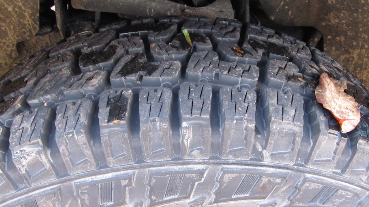

    There is no downside to buying E rated tires other than price. I'm not sure the KO2's are worth the price, they weren't to me. I considered the Falkens, but ended up buying these Pirelli's. What ever tire you decide on I'd go with E rated tires if you drive off road, or even on rough dirt/gravel roads. I've ruined too many light duty tires on such roads. Ride isn't bad at all if you get the air pressure right. You don't need nearly as much air in them as you'd use if they were on a 3/4 ton diesel truck that weighed 7500 lbs unloaded.
    The Pirelli's, about 1/3 less than BFG.
