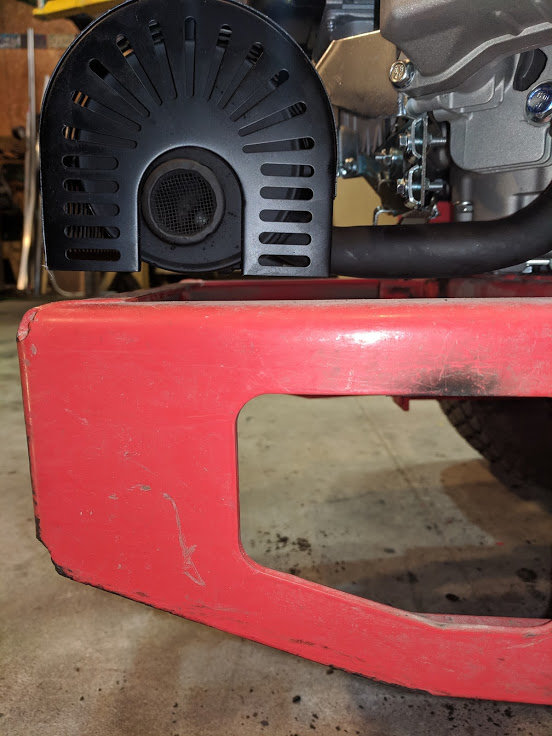

    Pretty damn excited! the valve covers clear the lower motor guard just fine.d_zXifzCsDnBIZSpsd8htZ7rfaHleLZzD5nLYbdU_a4992cdb7e8467741c96394b30a4e867ee62446a.jpg

    Everything I had read on these engines indicated that I WILL be altering the exhaust/muffler. I was pretty fucking happy when I saw that I had a full 1/2" of clearance. I know that plumbing isn't gonna grow a 1/2".ttuljRkQIVbXxMl7tKmsHMXCmB7noR5jXJlahFC8_88d3bb3de7e102330db7549bc4d0afb86ee85c2d.jpg
    While on the floor, I stuck my head under the engine. I could see light shining thru 3 of the 4 motor mount bolt holes. I'm thinking "this can't be this easy!"
    Dropped 3 bolts in the engine base and wiggled the motor a tad and the 4th fell in place.
    At this point I'm way further along than I ever imagined.

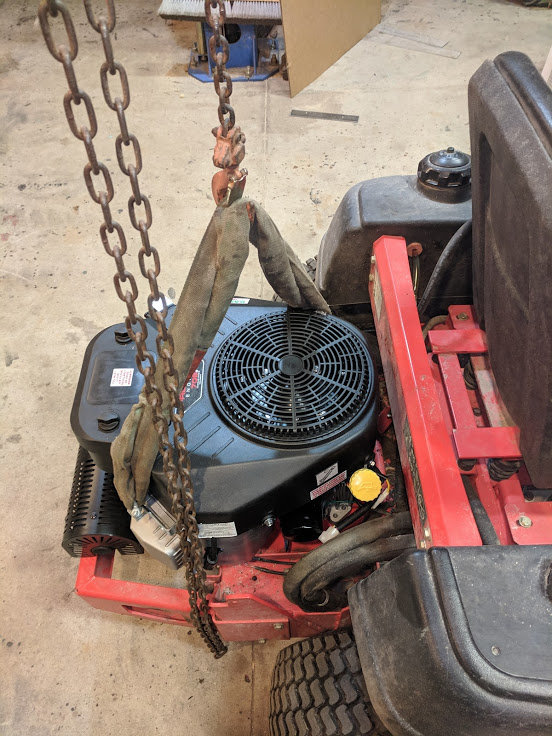

    Well, that 1 shot turned into 4. I knew I wasn't going any further that evening. 2.5 hours to pull the old motor and install the new motor. I was feeling pretty smug.
    The Predator calls for 10w-30. I got tons of 5w-30, so I stopped for the night.
    This gave me a chance to do some research on the electrical. My plan was to meter out what wires where what the next day.
