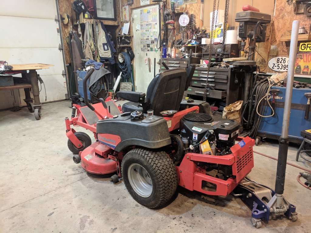

    The next day, after sourcing a couple quarts of 10w-30 and dumping it in the motor, I start tracing the wire harnesses.
    I find the male plug (chassis side) and find the female side (motor). They are very near each other and look close enough to reach each other. Another freebie!
    I start comparing the pin outs. They are the same fucking plugs! I plugged the connectors together and they snapped and locked perfectly!
    To test things, I pull one of the spark plugs so I can crank the engine and check for spark. I have spark!
    After running the engine, the only test left is to check to see if the e-clutch engages. Yep, you guessed it! Engaged perfectly!
    So to recap:
    Motor base bolt pattern-same
    Crank length and diameter-same
    chassis/motor wiring-same
    Fuel line connection-same
    Throttle/choke cable-not long enough. On order.
    Because there is no control cables, I just turned up the idle screw to around half throttle. I was able to zip around the shop just fine. Even at half idle, the thing will scoot!
    I've never used a zero turn, but it is quite a bit faster that my Case garden tractor. I really don't see a need to re-gear(pulley) to gain any more speed. Its fast enough.

    If that last pic showed, you can see the top motor guard will need to be altered. Pretty easy job.
    As I mentioned when I started the project, the mower was given to me. My brother in law said I could do anything I wanted with it.
    The project was so easy, my conscious won't let me keep it or sell it without giving my brother in law the option to just pay for the motor. He can have it back if he wants it. It really is a nice machine. His mechanic took very good care of the maintenance. It has a lot of life left in it.
    I had more fun doing the job than what money I can make flipping the thing.

    Update:
    Got the motor gaurd altered. Not too far from looking factory.
    Shimmed out the rear with longer bolts and made links for the top.
    Had to cut the welds so I could spread the top gaurd a 1/2".

    Final update:
    As shown motor guard is in place, control cables are functioning perfectly.
    As I hoped, the brother in law was impressed on the ease of the transplant. I asked him if he would like it back for the cost of materials? He was happy that I asked and was happy to pay for the work and materials.
