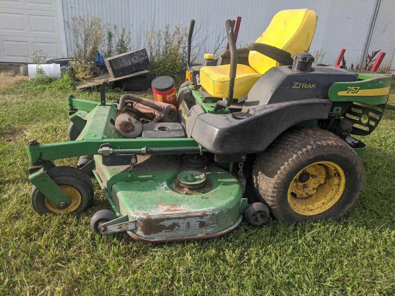

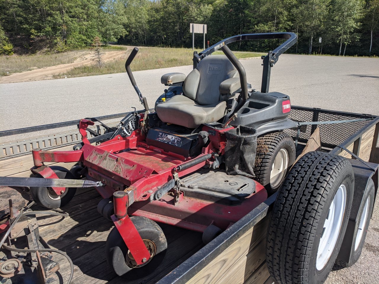

    This is my latest find. Actually picking it up tonight.IMG_20200714_190056.jpg IMG_20200714_190045.jpg IMG_20200714_190112.jpg
    cosmicfires and Bigdaddy4760 like this.

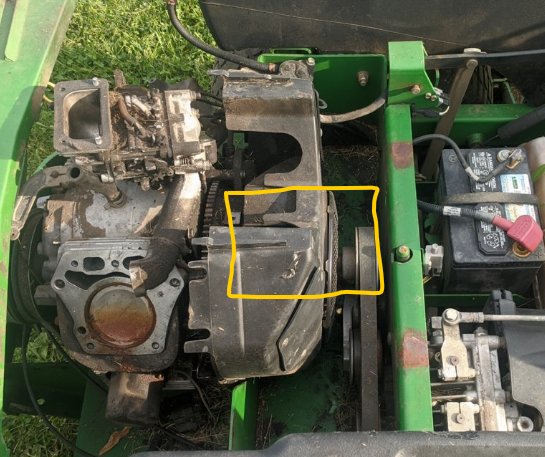

    Annotation 2020-07-16 215355.jpg On the hunt for a flywheel PTO adapter for the Predator motors. I need to find out what my bolt pattern is on this 25 hp Kawsaki engine is.
    The Predator motors do not come with a flywheel PTO.
    I'm hoping this part is what I need to use the existing flywheel power take off. Here I go...:spending:

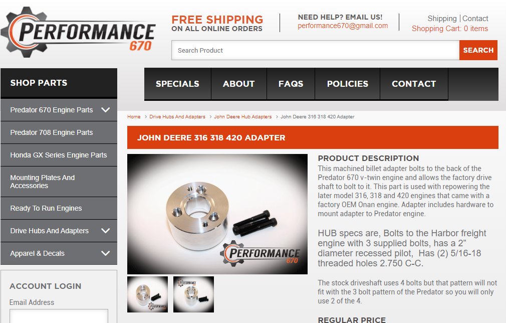

    Pic should have been included in the above post.Annotation 2020-07-16 215817.jpg

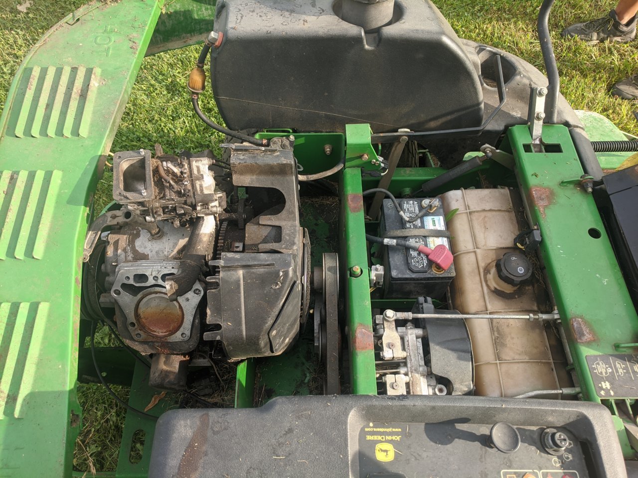

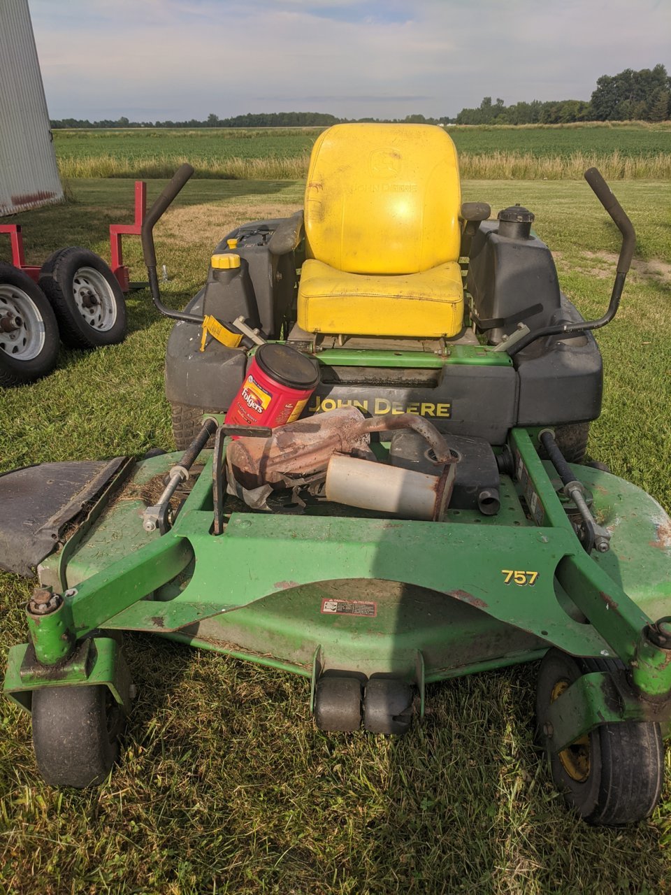

    Present project. Sounds like a broke connecting rod when cranking the engine. No biggie. It's getting a Predator 708.

    Old engine out and new engine installed. Running choke and throttle cables.IMG_20200913_154229.jpg

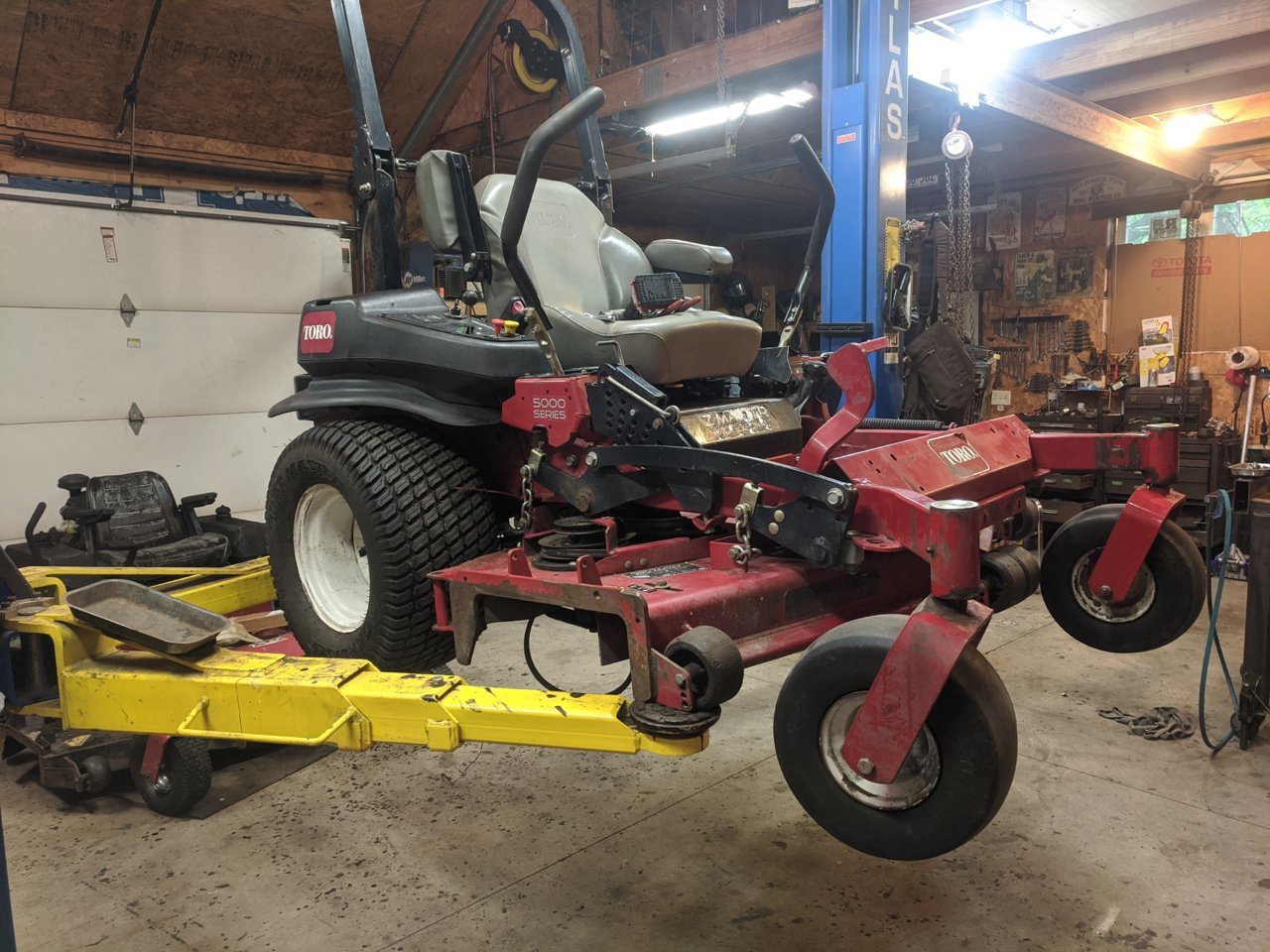

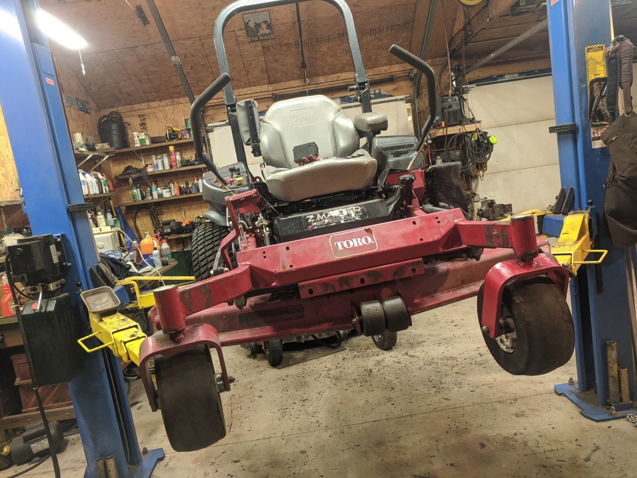

    Got a pic from the back. Interested on how you you lifted this up

    Test ran the engine. Sounds wonderful.
    Waiting on a new hydraulic pumps drive belt. Old one looks pretty sketchy.IMG_20200913_154218.jpg
