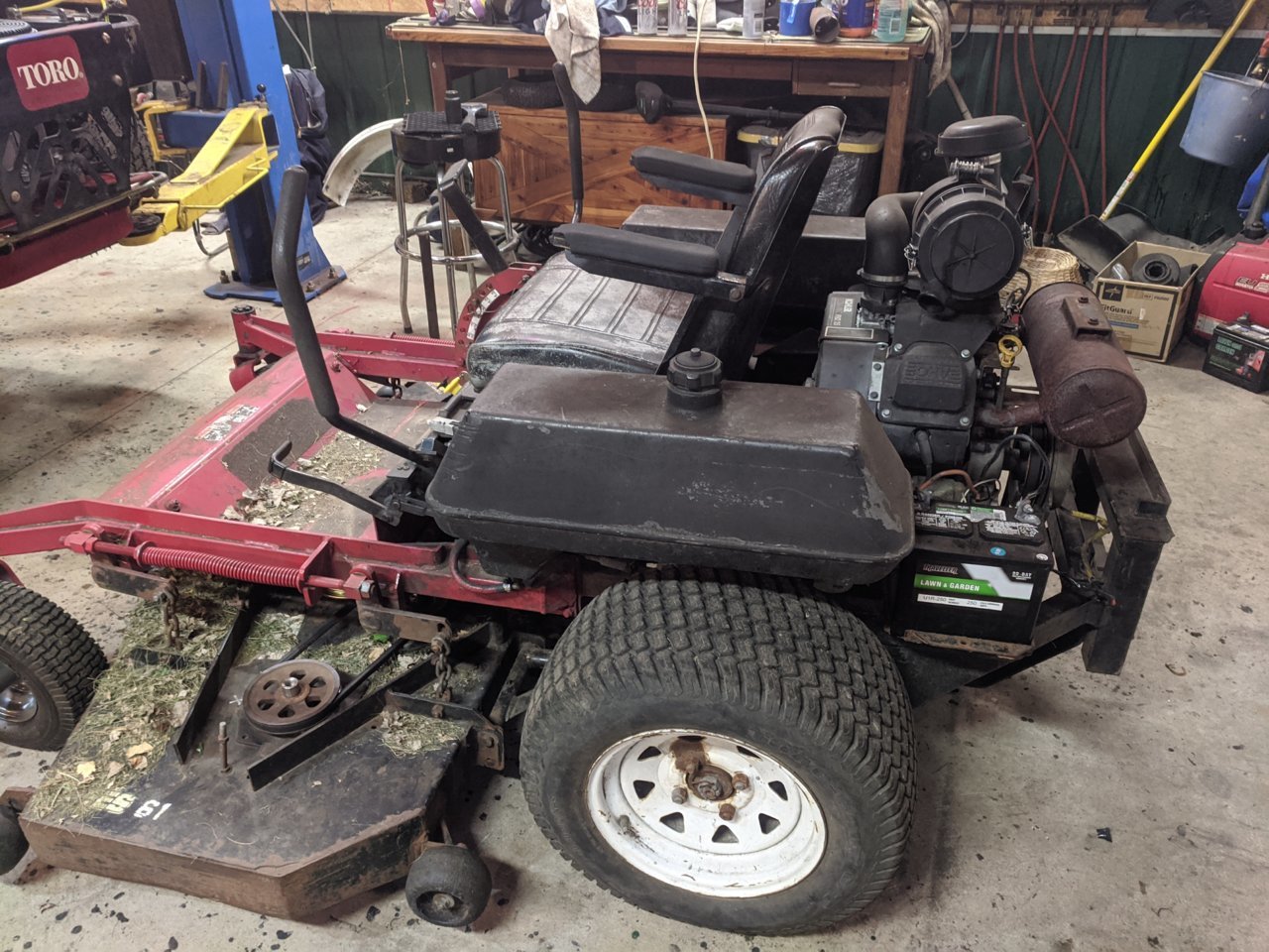

    This oldy turned out great! Rebuilt the deck with new spindles, pulleys, idlers and blades. The 27hp Kohler is one mean grass cutter!IMG_20200918_195321.jpg

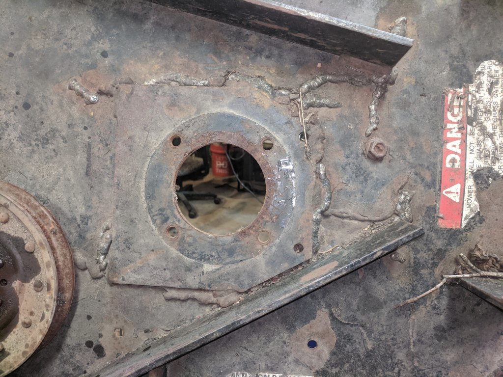

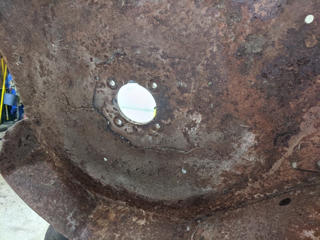

    I should have included these pics of the deck trauma. I cut out the fractured iron and welded in a new section.

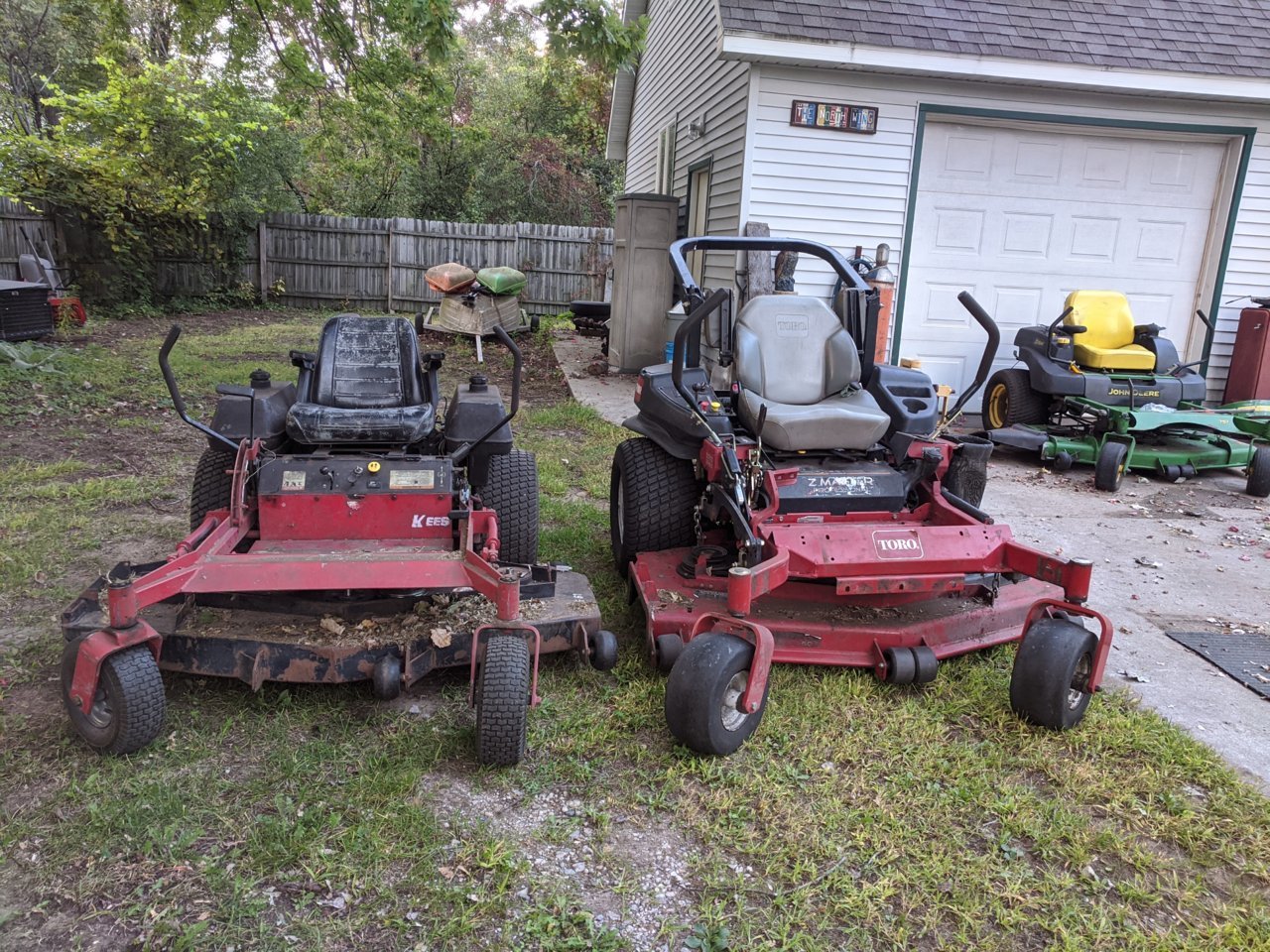

    2 are now ready for the spring.
    Oddly enough, these 2 are 20 years apart in age, but if you operated either one blindfolded, it would be hard to tell which you are running.

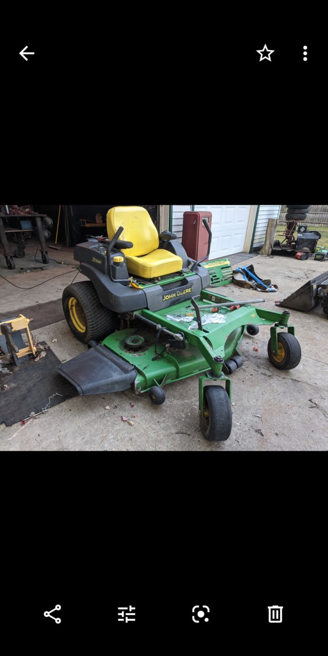

    Finished up this one. I had my doubts in the beginning. Would only drive 1 wheel motor. Turned out the hydro pump free wheel bolt was backed out too far. Tightened it up proper and it mows very nice. Still have to alter the motor shroud a bit so the shroud will clear the muffler.Screenshot_20201010-045231.jpg

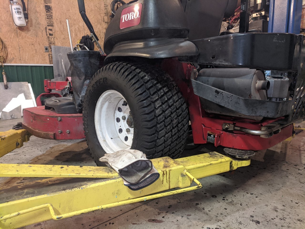

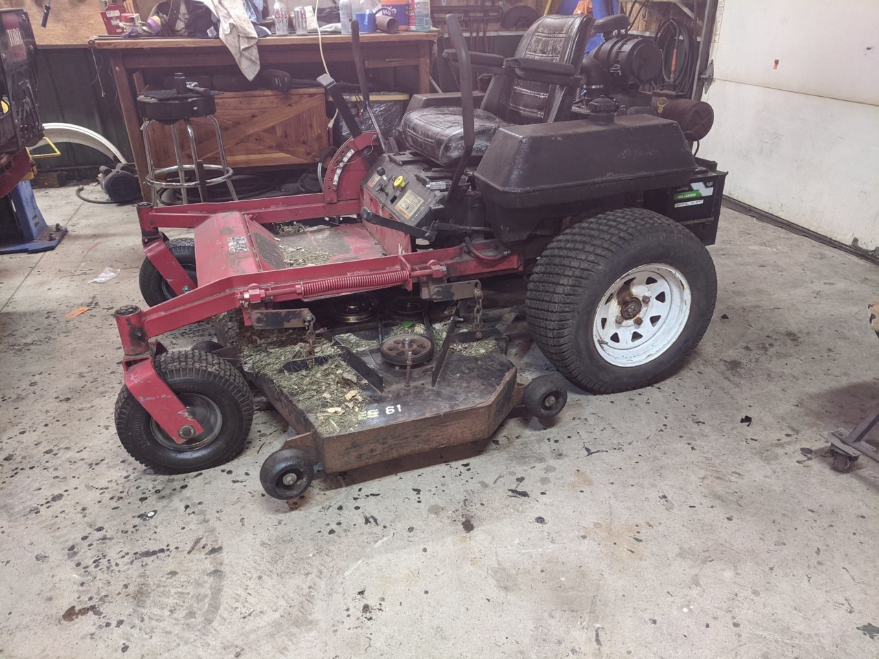

    Not sure I like the raised cowling. Had to fab brackets to clear the HF motor.

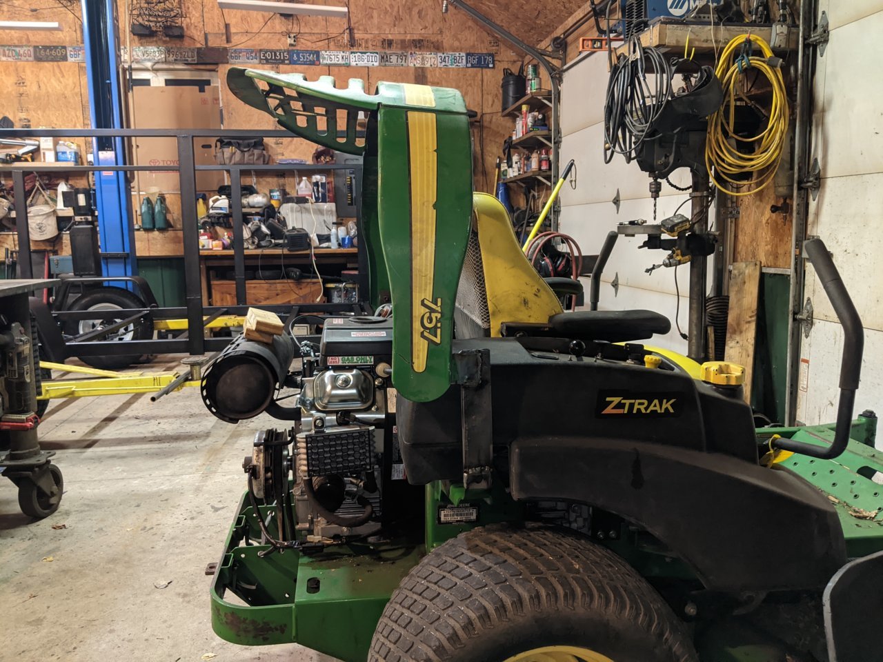

    I don't either Kirk. Maybe you can fab a new one that fits the machine and paint JD color

    I guess I should be clear. Does the cowling look "off" being raised and pushed back?
    I still need to make the support perch for the latches. Its resting on a couple of blocks of wood in the above pic.
    Doing research, these mowers suffered from poor cooling because the shroud restricted air flow. I'm only improving the air flow with my alterations. Amirite?

    Yes it looks off the way it is mounted now.

    Thank you for the honesty.
    I guess I have to hunt for an exhaust.
