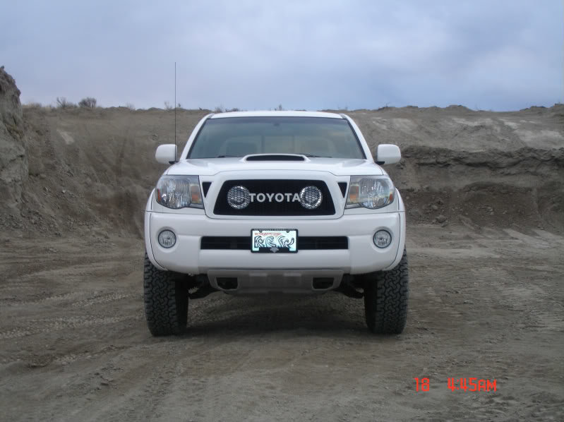

    Looks like he centered them more avoiding the tranny cooler. I myself used hella 500's and cleared the cooler. Later on I plan on retro fitting them with hid's

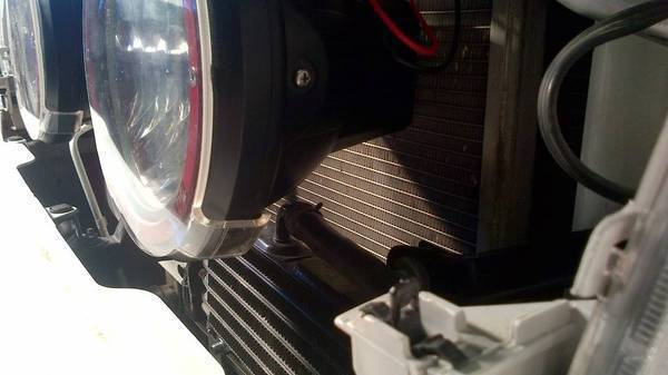

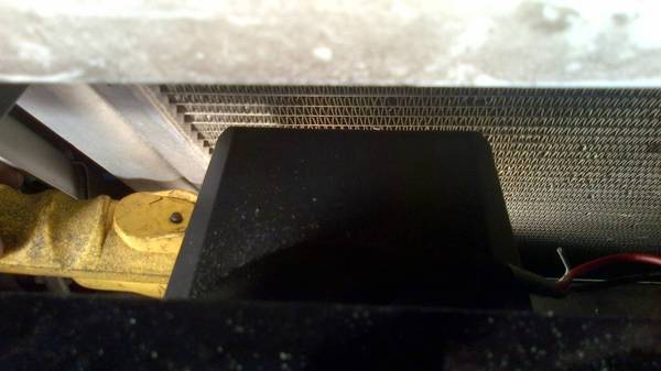

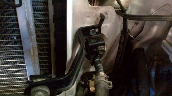

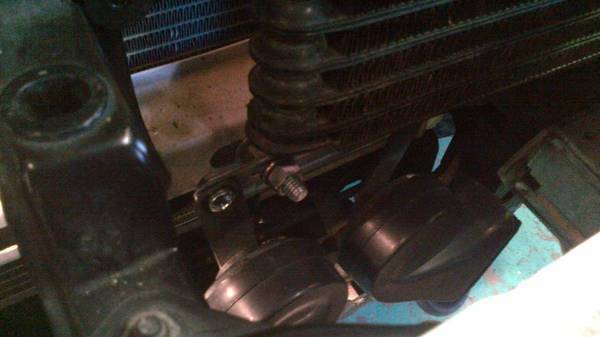

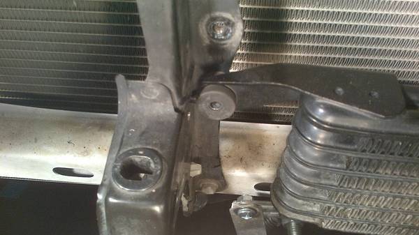

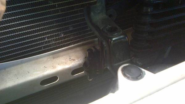

    All I did was move the BDF bar all the way to the top and center the lights as for the driver side you will have t put the light in an angle first. I will take a picture on top side and post it so you can try and use the same hole pattern for the lights.

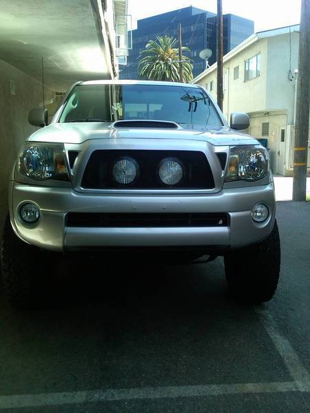

    What have you done to your truck lately

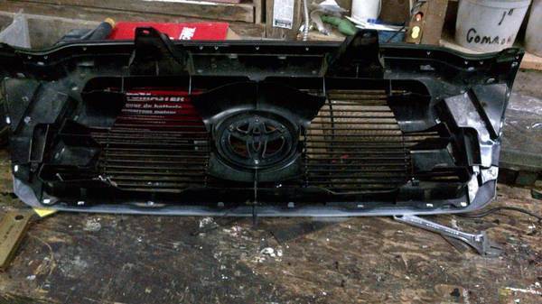

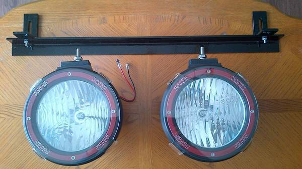

    Here are the pictures I used the 3rd slot from the middle for both lights. Hope this helps.

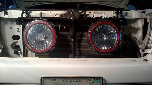

  6. Feb 6, 2012 at 7:31 PM
    #26
    Ryan07
    Ryan07 Well-Known Member
    Jul 12, 2010
    #40109
    350
    New Brunswick
    07 TRD DC,LB Sport 4x4
    Icon Ext. Coilovers, LR UCA's, Icon AAL, Nitro 9000 Shocks, 7"Kragen HID's/Billet Grille, Extang Solid Fold Tonneau Cover, Bed Lights, Diff Breather Mod, D-Rings Mod, LED Interior Lighting/Plate Lights, LED 4X4 Switch, Viper Starter, AVH-P4200DVD, PAC Interface, OEM Backup Camera/Pop&lock, Wet Okole Seat Covers, Weathertech Mats, Husky Mud Flaps, 8000lbs Champion Winch/Winch Cradle and Quick Connect Kit, 4,500lbs Champion Winch/Front Hidden Winch Mount, OEM Painted Rims, Spidertrax 1.25, 265/70R17 BFG KO's

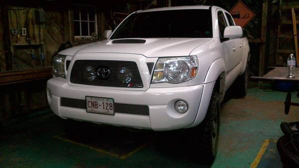

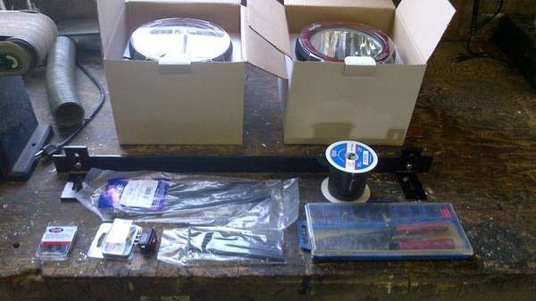

    Doing 2-7" tomorrow :D
    I will take some pics

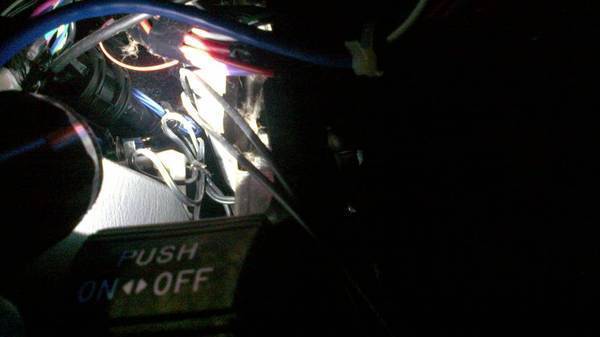

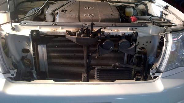

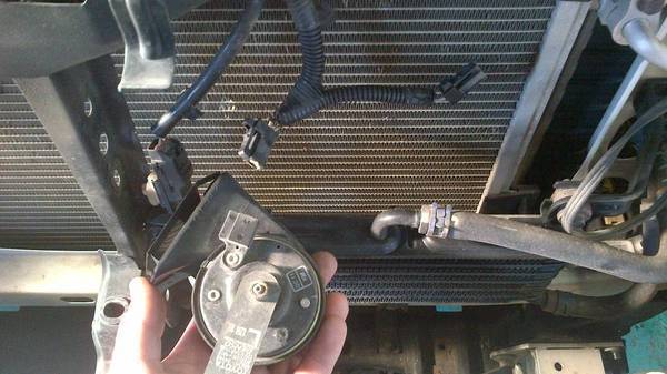

    Relocate the transmission cooler
    Switch wires through firewall

    Yeah I just relocated the horns.. didn't touch the tranny cooler. They are solid too.

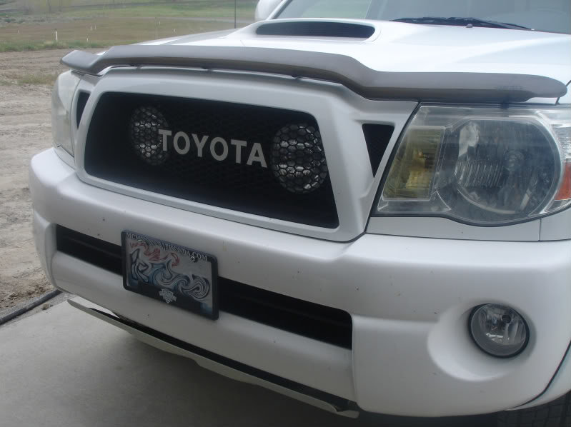

    Mine too.. I did have to relocate the horns, but thats not a big deal..

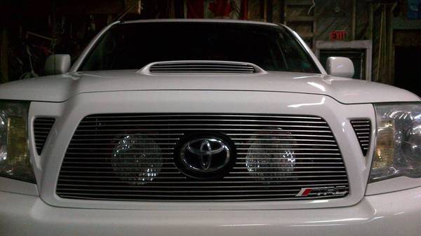

    I do..
    Made by Craig (Homer)..
