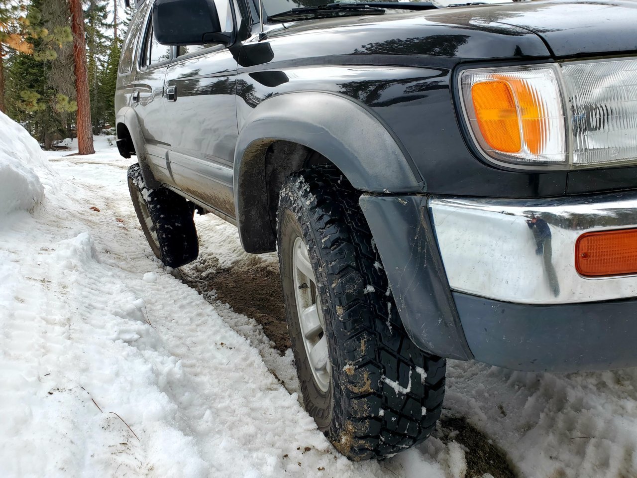

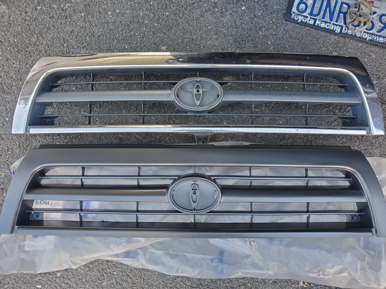

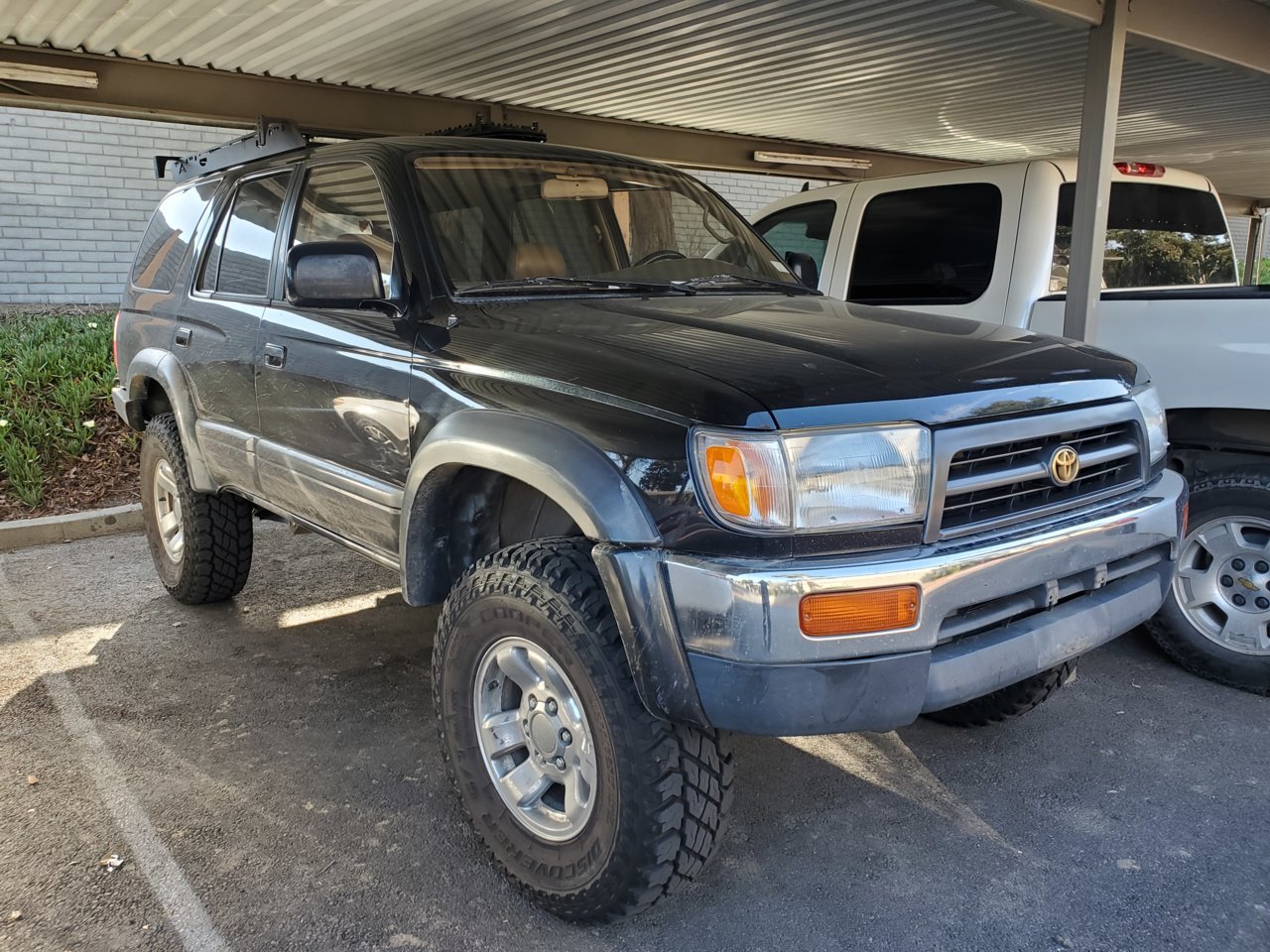

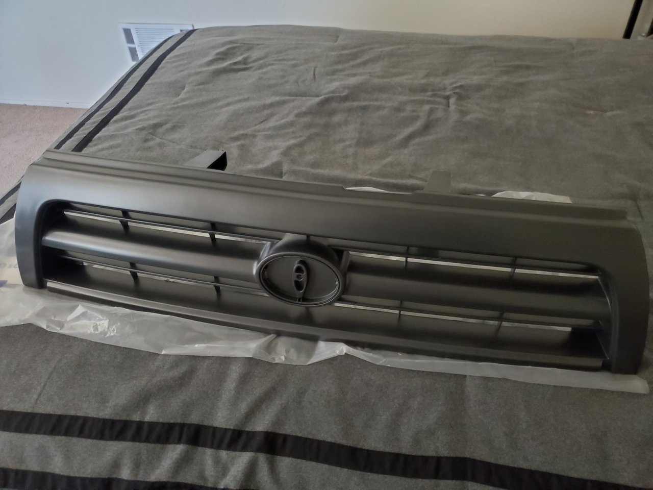

    Getting rid of some chrome, I got this paintable front grill for the 4R -
    What's interesting is, it's some sort of 'graphite' color which closely matches the Limited side molding and flares. May just install it that way for a subtle contrast versus a monochromatic front end.

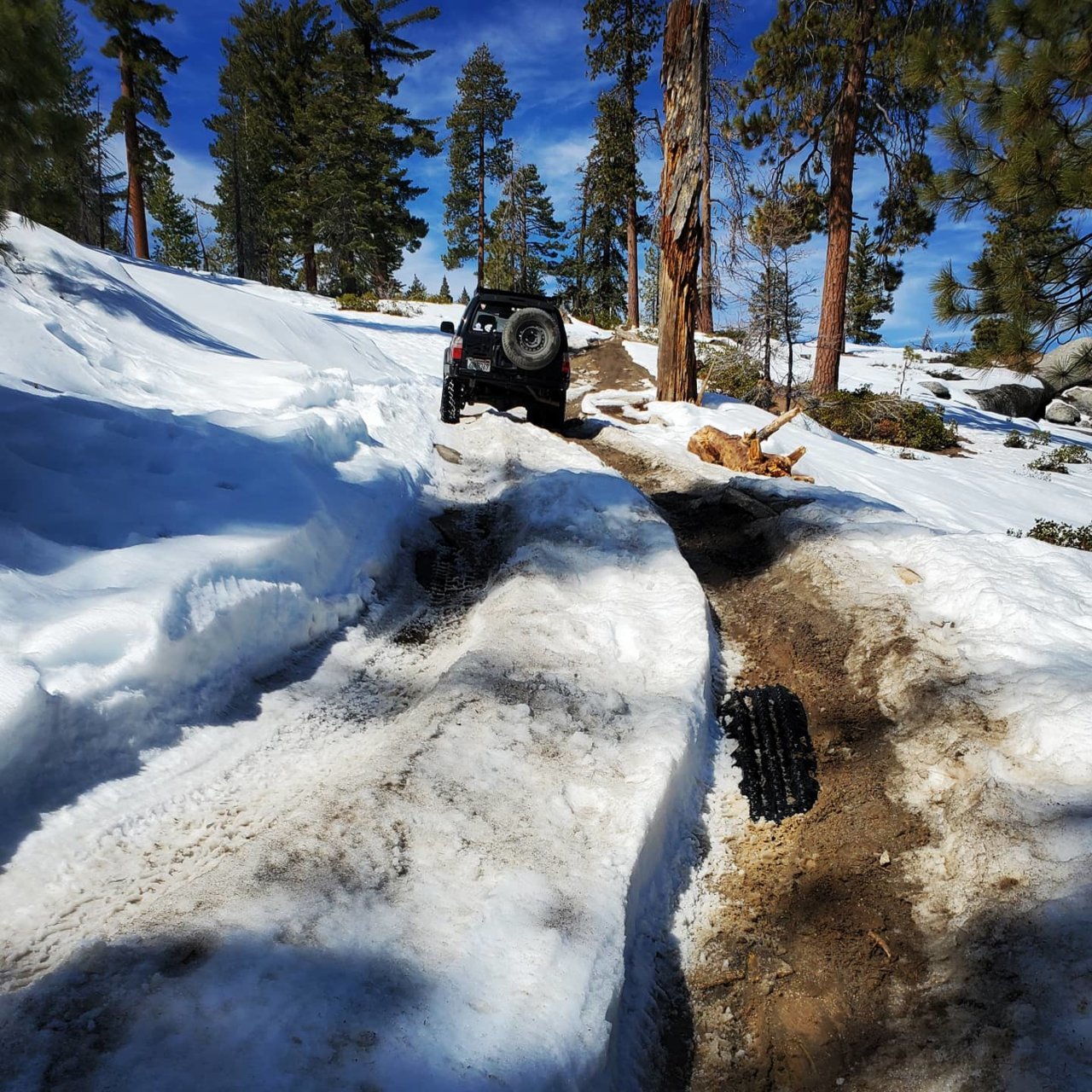

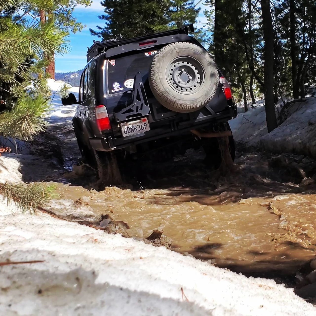

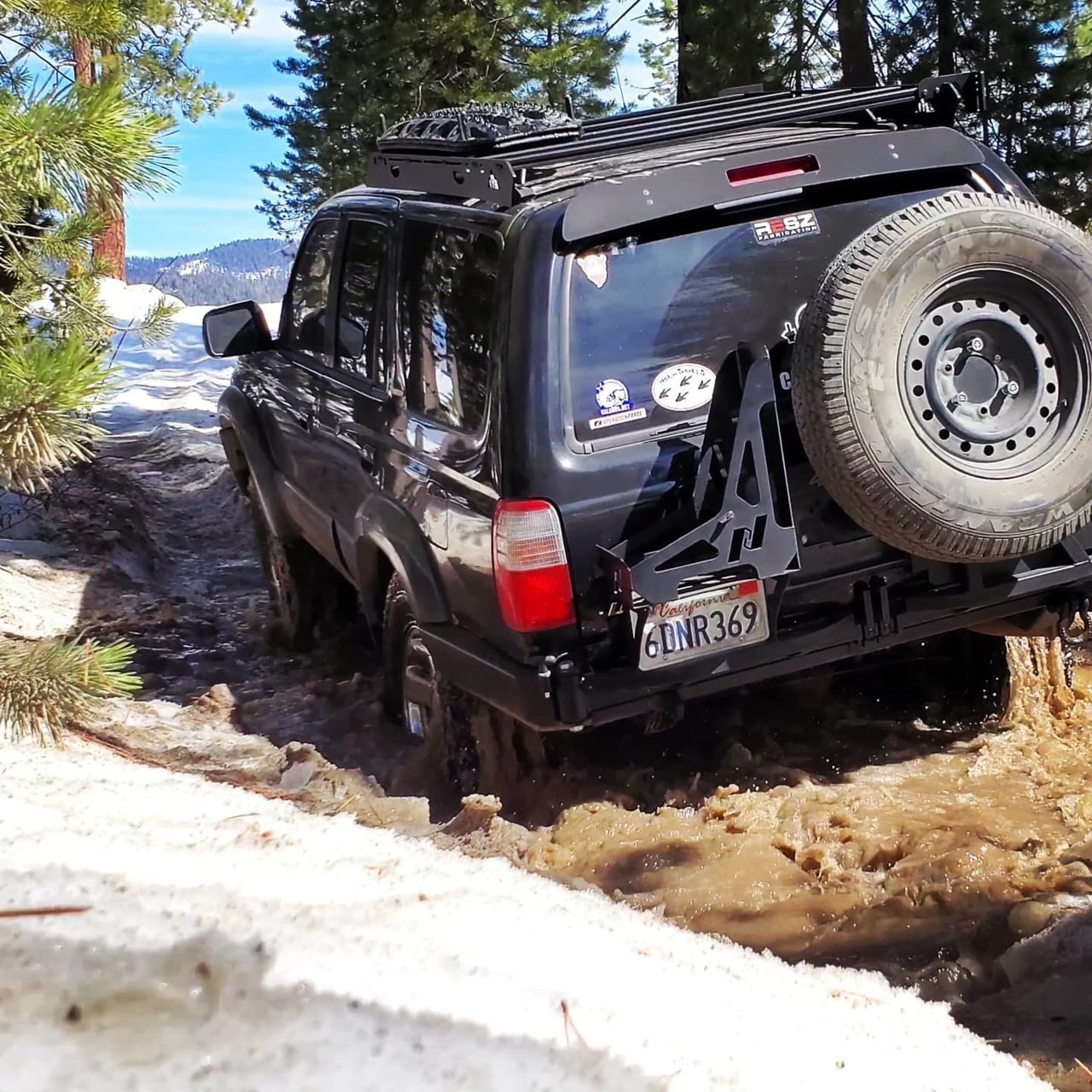

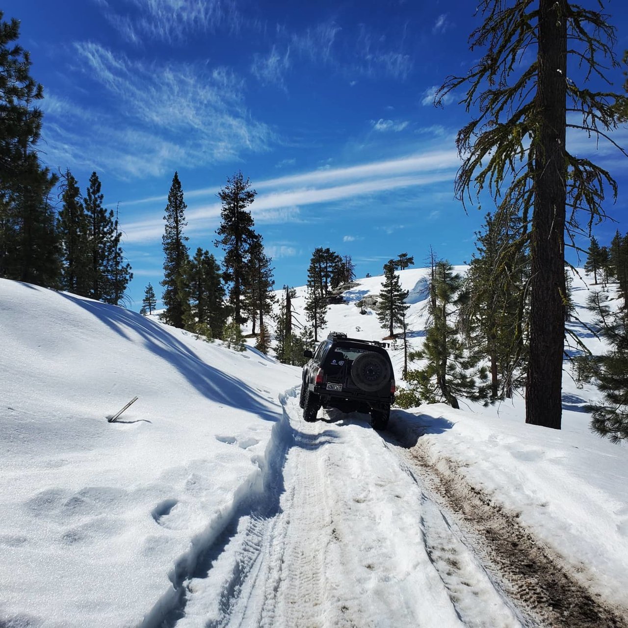

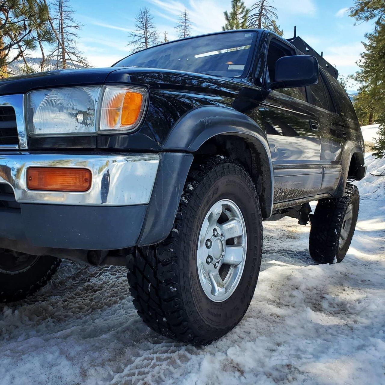

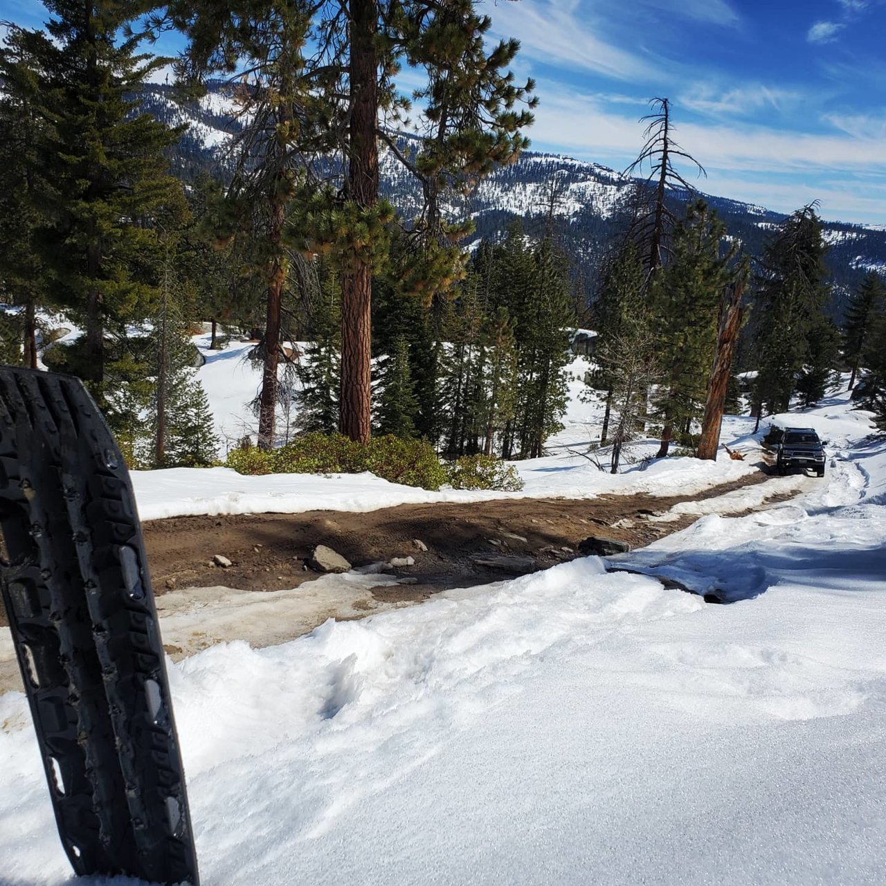

    Because I can't seem to get away from the snow; with my skid plate back on I went much farther this time around.
    Was really sketch putting a wheel in a deep pocket of slush or mud while climbing a steep hill.
    Didn't realize I was flexed since I only got out to check the area ahead -
    Pictures don't do justice; that mud sucked...not to mention having snow on the other side -
    And it kept going -
    Leveled out for a bit, then a hole -
    More climbing -
    Fun day to just do shit.

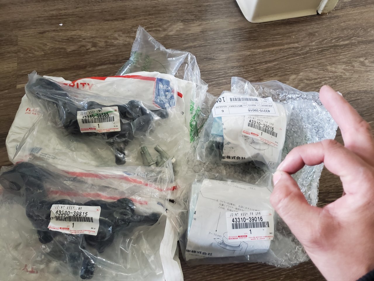

    Parts were waiting for me when I got home.
    Fucking mint -
    What's funny is I don't even need those UBJ; maybe I'll install those new UCAs I've had for awhile. :anonymous:

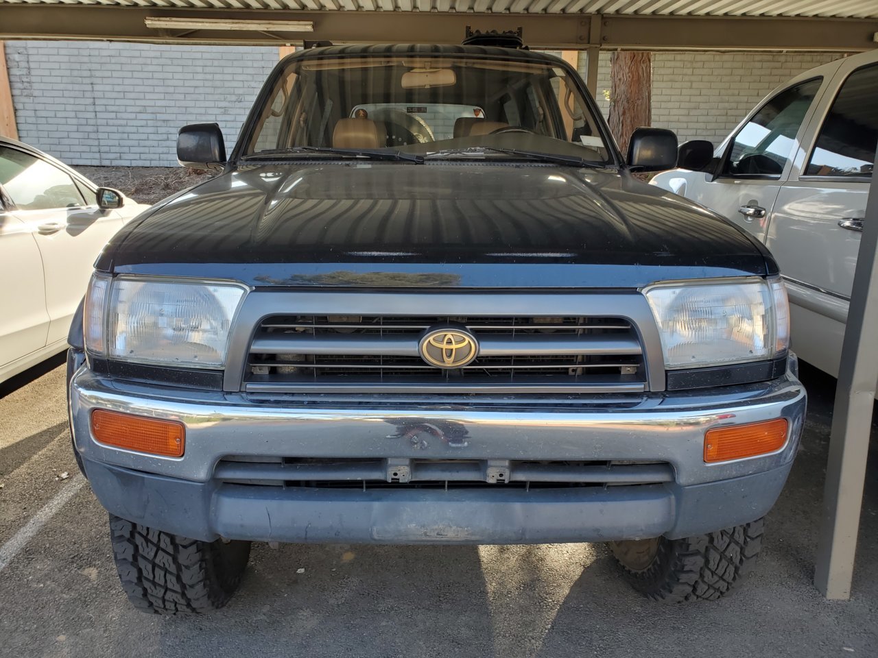

    With the parts piling up again, I decided to install something -

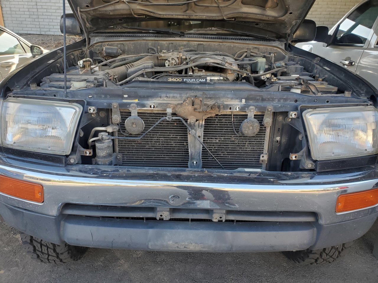

    Damn she's filthy -
    The old and the new; I really hate chrome -
    Installed -
    Next up is finding a front bumper and most likely removing the lower valance...we'll see.
    At least the grill matches the Limited trim -

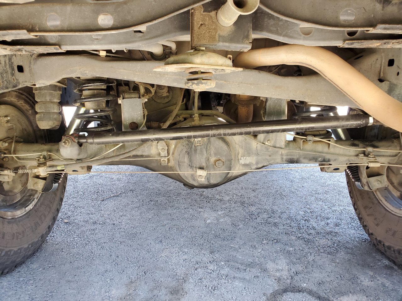

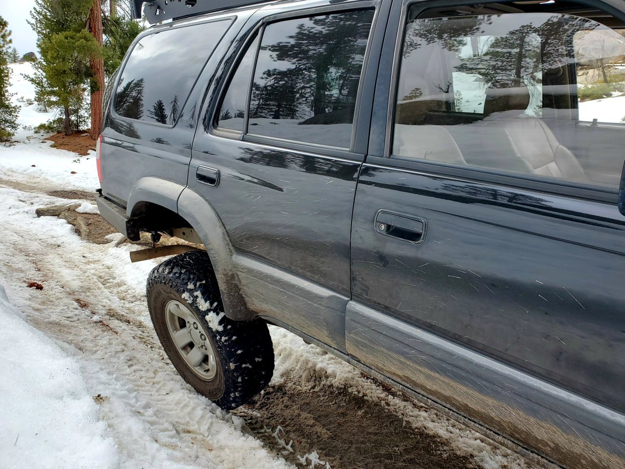

    Wanted to check out a little tuck and droop; with stock sway bar and end links -
    Other areas out there that I could've used but I wanted to pay attention to the trails instead.
    Scenery was beautiful, especially this spot which is actually a cliff -

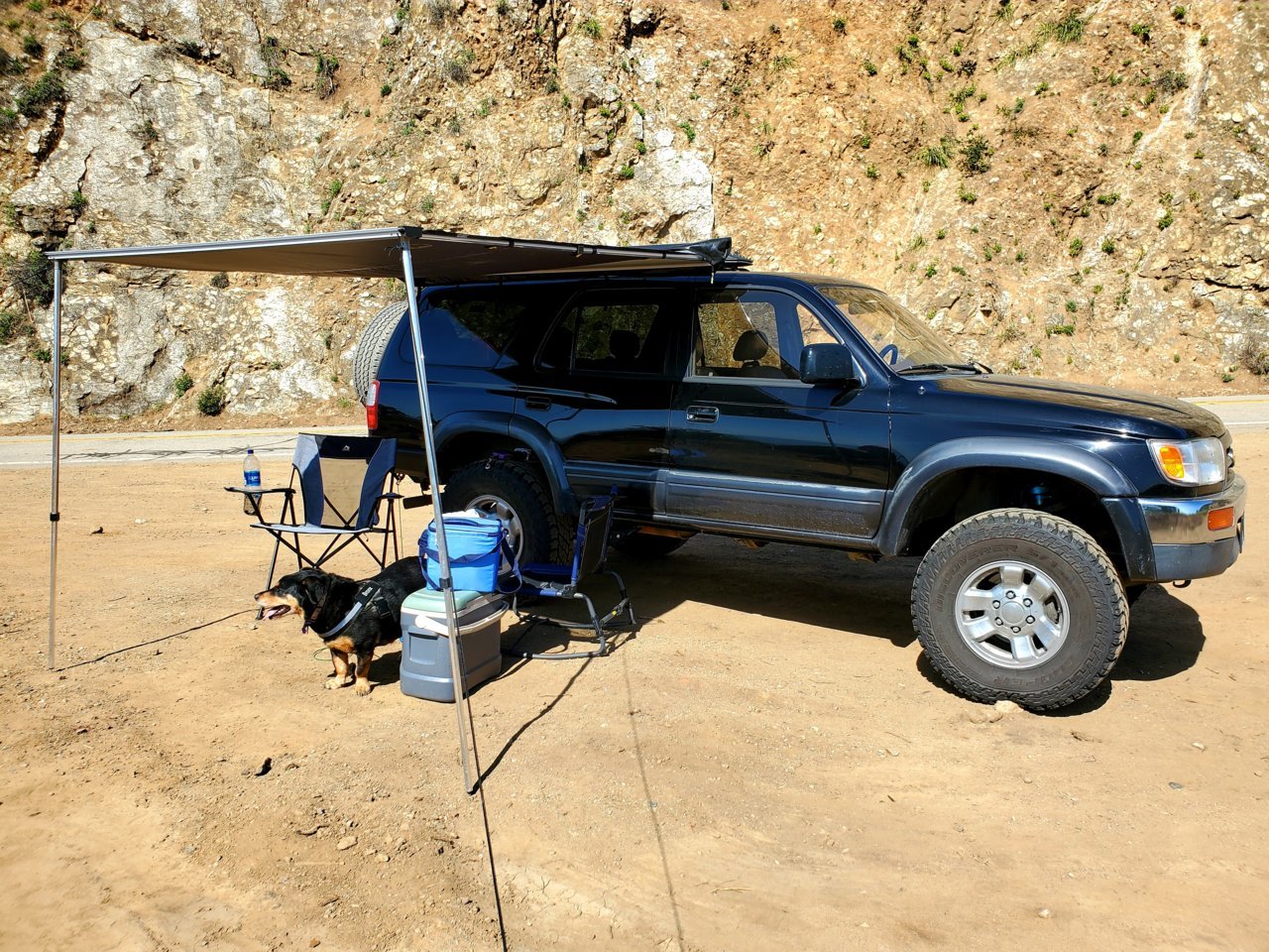

    Got to use the awning today for the first time; wanted to deploy it before I decided if I want the room/shade add-on.
    Being Smittybilt's 2nd Gen, it's a modern grey versus the tan/brown versions seen often.

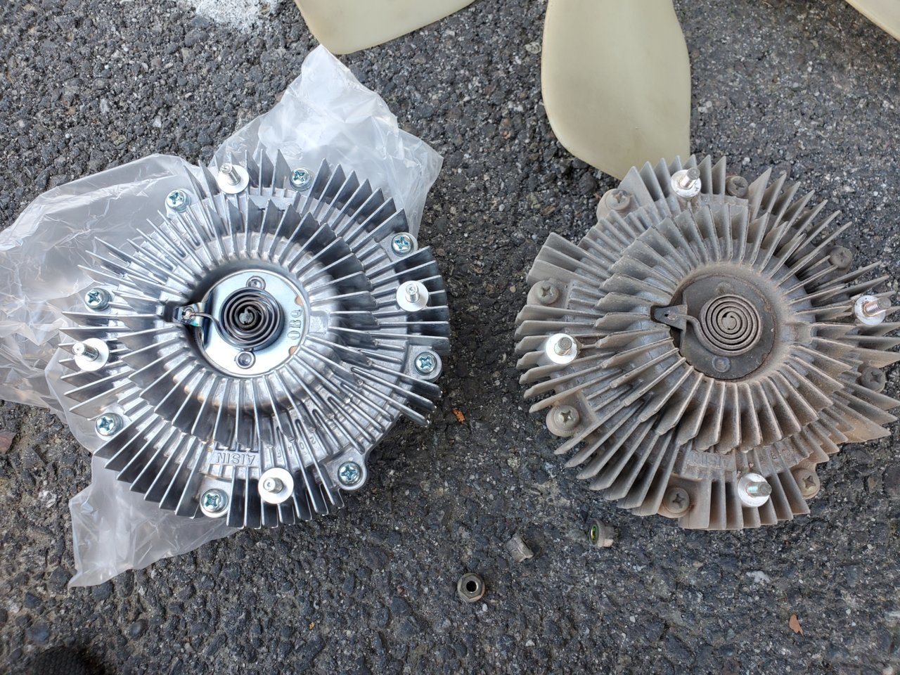

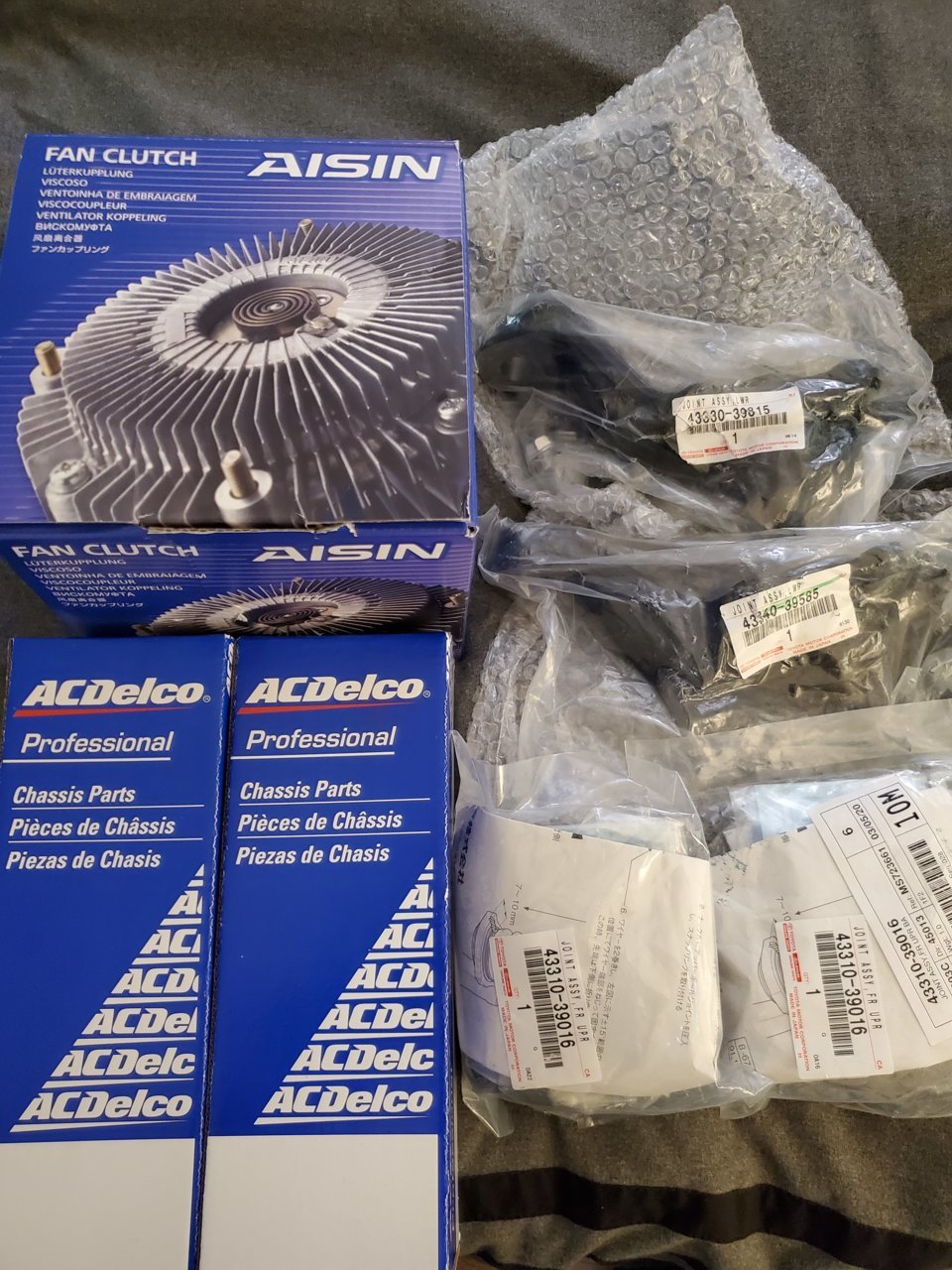

    As the long trips to Fresno and back every week continue, I've found a few more things I need to address right away.
    The first was pretty easy as the signs were all there; the 4R was running a bit warmer than usual.
    The fan spinning at the same speed (different rpms) and the old semi-truck sound pointed towards a bad fan clutch -
    It's supposed to be engaged, and not move so freely after it's fully warmed up from a steep climb and 3 hour drive.
    The new one -
    The new and the old -

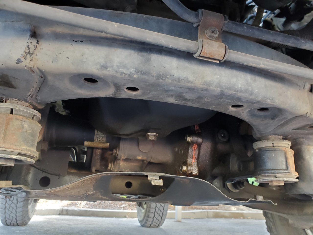

    What I wasn't excited about was that I had to drop the skid plate, since one of the bolts fell, and found my diff end is leaking. I need to replace my passenger side CV axle seal -
    I've got the parts, and more, but would prefer to replace the tie rod ends and lower ball joints when I pull the CV axle out -

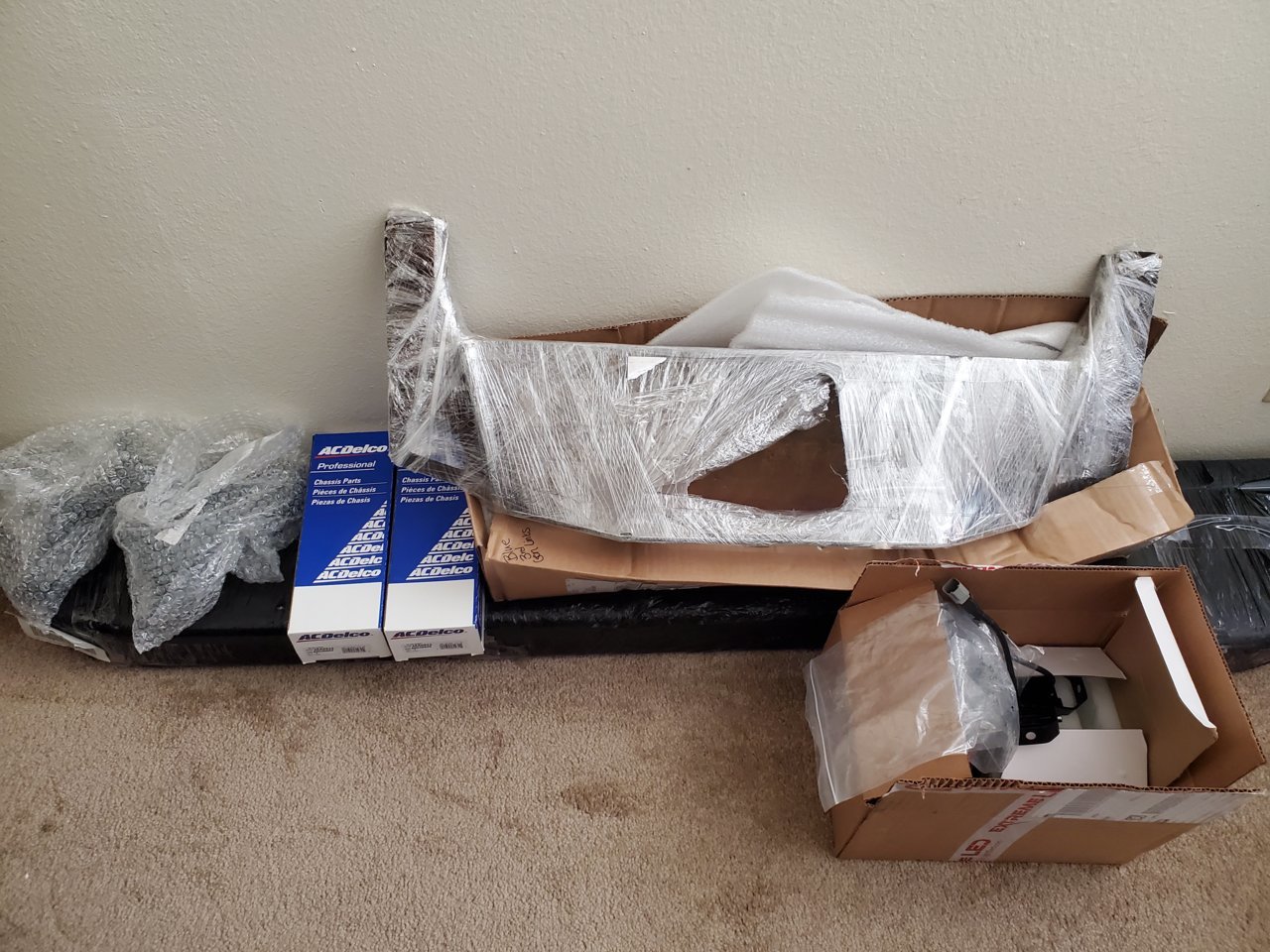

    The parts pile just keeps growing and growing :anonymous:
    This bad boy came in -

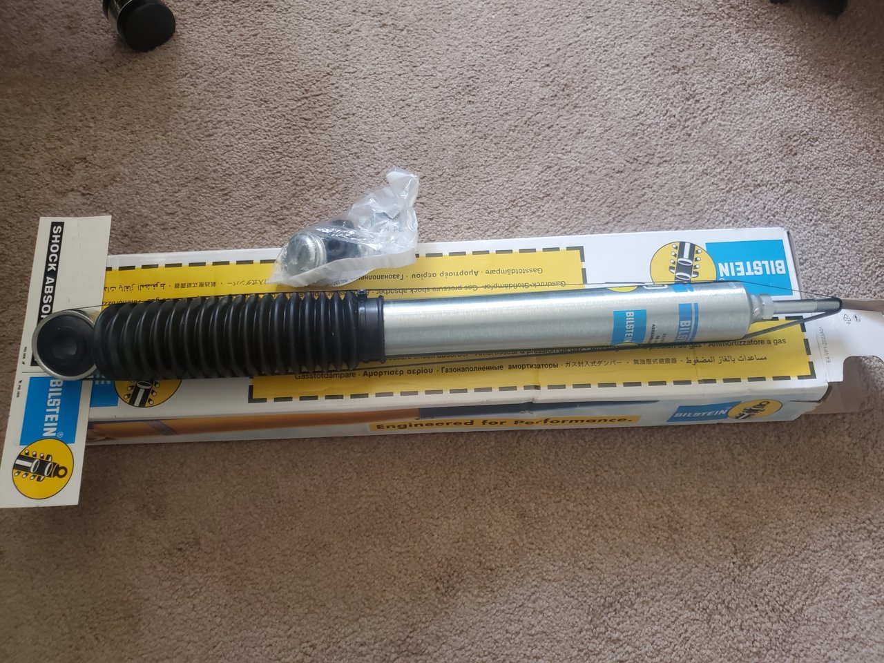

    After having replaced my fan clutch, I figured I'd focus on a little bit of needed maintenance. I want to replace my thermostat, coolant, and either bypass the transmission section of the radiator or not...

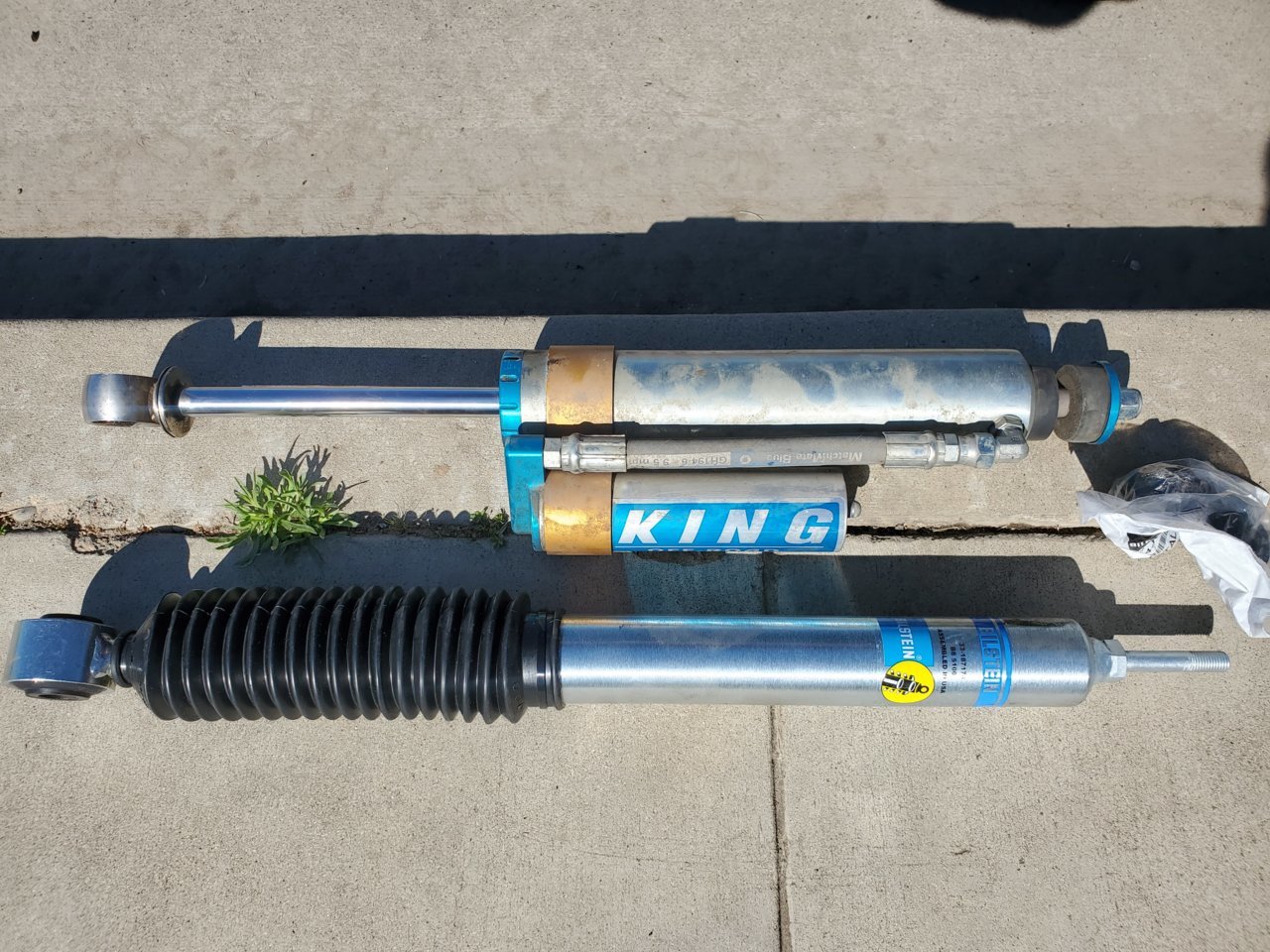

    On another note, I finally got my Bilstein 5100's -
    Got them as a temporary solution since the Kings had to come off.
    Here are the two -
    Yes the Bilstein shocks are a bit longer, but what you can take from this is the King shocks are the perfect length for someone running a minor 1-2" lift like I am.
    I got the longer Bilsteins on purpose to mess around with flexing/droop, but find them to be a bit too long compressed -
    And the reason why the King shocks had to come off -
    Seems at one point, I made contact with the reservoir at full stuff and put a dent into it.
    So the plan is to either get them serviced (and replace the reservoir), or full rebuild for a longer stroke. Kind of undecided but I do like the idea of reusing them for my rear shock relocation.

    I did forget to mention, I've got yet another box of stuff waiting to be installed :burp:
    The piles keep growing :annoyed:
