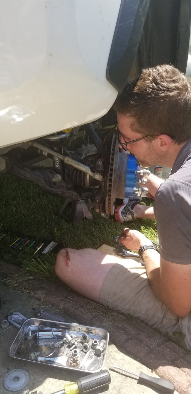

    Basically the only photo I took in the heat today. Thanks for the invite. Had fun hanging out with everybody.
