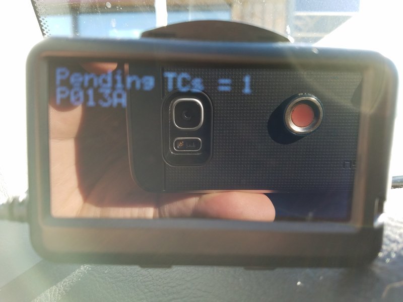

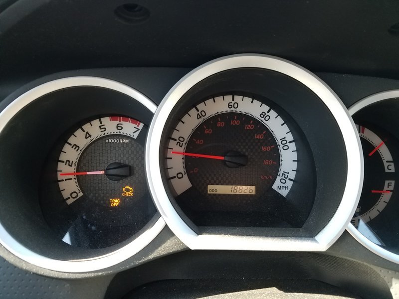

    So after 2 days my check engine light came on. Code P013A. O2 Sensor.
    So much for URD's O2 simulator...
    P013A - Oxygen Sensor Slow Response Rich to Lean Bank 1 Sensor 2

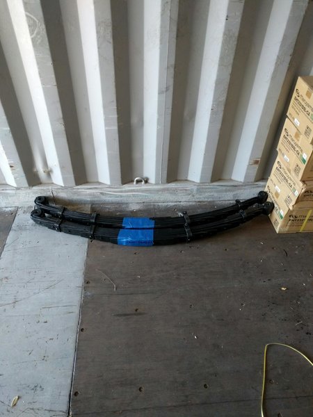

    Hope you have aftermarket leaf springs! LOL

    Expos arrived the week before. But I'm tempted to just mount the HC on stock suspension! :). Saving up for Kings suspension, haven't decided on UCA yet.

    After 24 miles my check engine light came back on. Same P013A error code. O2 sensor issue. I need to call URD tomorrow I guess.
