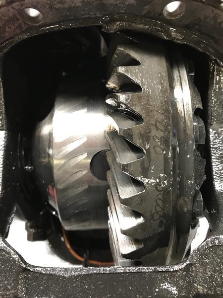

    They've stepped up in the past. Hoping they will again. If ECGS is correct i should get a refund for the $361 I got charged yesterday to investigate the issue and what I paid for a replaced pinion seal in December. Let alone the $50 I paid a driveline shop last week to "find the noise" because nobody was taking me seriously.
    ECGS believes an install error caused the pinion bearing to fail. This leading to pinion movement and seal failure. Leading to grinding and noise. And they say they've never had a pinion bearing fail on an 8.4" Tacoma 3rd member.
    New photo that ECGS gave me that they received from Dark Horse.
    There's a small chip in one of the teeth on the ring gear. Chase feels the marks on the case are "superficial" and shouldn't be a problem. The good news is they don't see any signs of the gears being abused, burned up, etc. So there's no reason for anyone to not accept my word when I tell them I don't drive the truck too hard.
