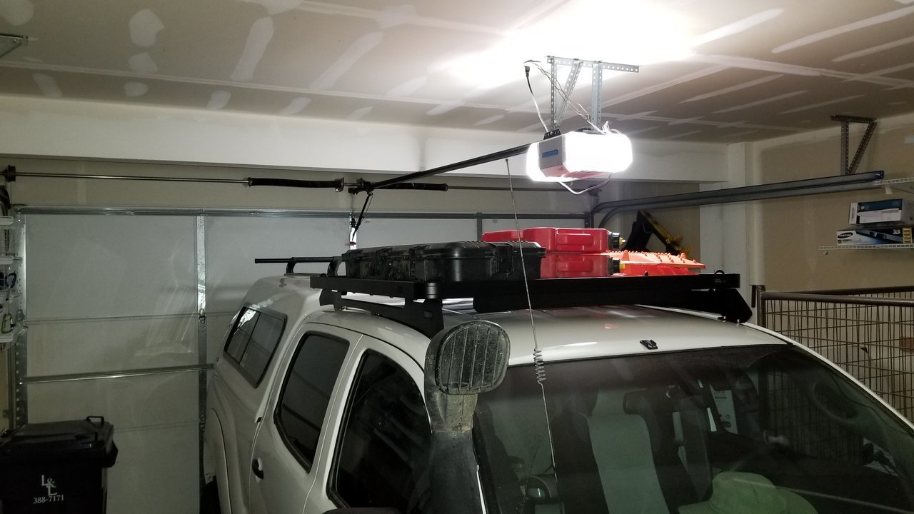

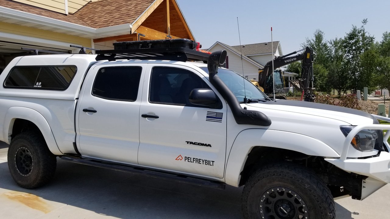

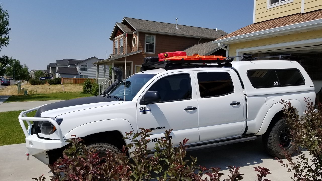

    Finally got my Front Runner Rack installed!

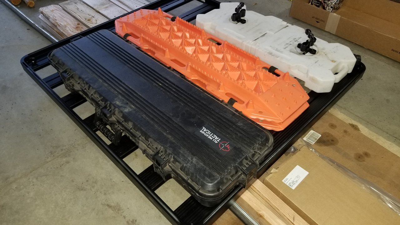

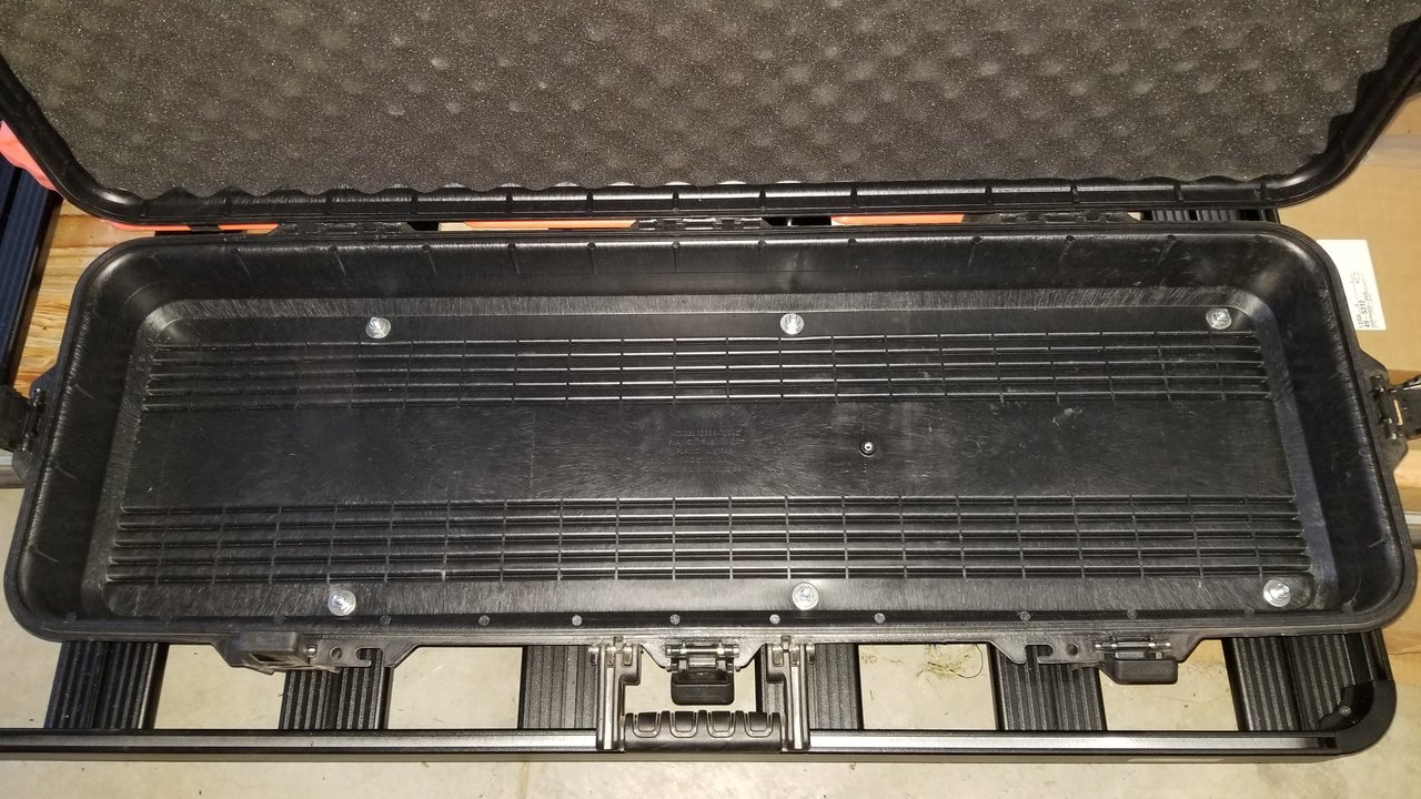

    I bolted a Plano tactical rifle case to the rack. This contains my recovery gear (tree saver, snatch straps, snatch block, winch remote, etc). The case already has two key locks built in. And with the nuts inside it won't come off easily!

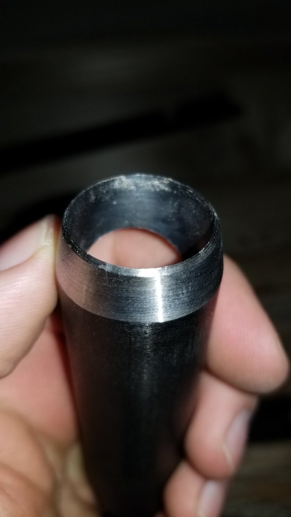

    The hardest part of the install for me was cutting the holes in the weather strip on the truck. Instructions recommend using a 22mm punch... or a holesaw. The holesaw is a TERRIBLE idea. There is a metal strip run through the rubber that binds in the saw bit and tears things up.
    Had to order my punch online since no hardware store had it locally.
    Also, my dealer sold me new weather strips for $84 each. So don't mess up!
    Originally I was going to mount two 2gal Rotopax and two 2 gal waterpax on the rack. However, I discovered that it is not easy being short and trying to pull two Rotopax off the roof at once. Plus, because my gas pax are deformed (heat) they don't stand well.
    This picture shows my original layout plan. I ended up doing a single Rotopax stack in the center as nd the Escapee Buddy traction boards on the driver side.
    Best part is I can still park in my garage!
    The truck looks much better with the rack too. I think folks will get the overloading vibe from it more now.

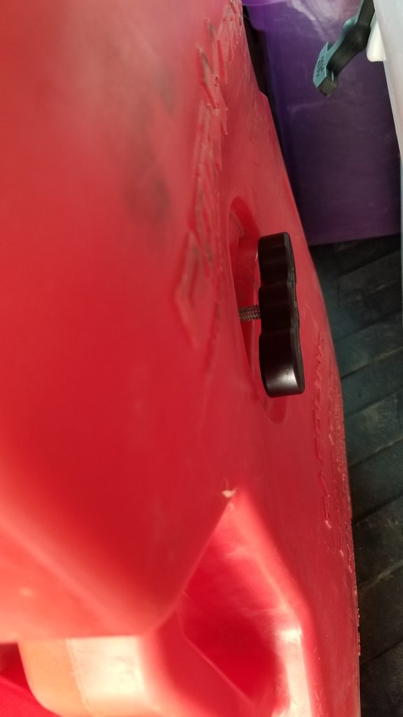

    How much do Rotopax swell in the heat?
    This much.
    Now that they are cool this morning it took 6 turns to snug them down.
