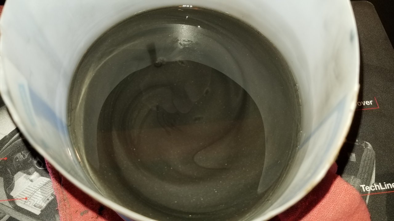

    Should it be that.. shiny?
    ChadsPride likes this.

    Only when its full of metal... :anonymous:

    Exactly. Sent photo to Chase @ ECGS to get his take. I talked to him on the phone yesterday for about 50 minutes.
    I hate to say it but when I call ECGS their staff knows who I am. By name. They know the name of the shop I'm working with. Apparently I'm the oddball issue they've all been talking about.
    This is the 3rd rear end I've had since re-gearing. First complete 3rd member I got from ECGS had a bad seal in the ARB locker. So local shop rebuilt it. Pinion bearing failed. ECGS provided me with new parts, local shop rebuilt it completely. It howled from day one. Eventually we found it was full of metal. So local shop bought me a new 3rd Member (complete with gears, new locker, etc) and put that in. Here I am a month later and there's metal already and it's making noise again.
    Nobody seems to know why. ECGS says the local shop obviously rebuilt the 3rd member wrong when replacing the ARB seal. And they did it wrong again when they rebuilt the 3rd member the second time. But now I'm having the SAME issue with an entirely new 3rd Member ECGS built. So... here I am... clueless as to what everyone is missing.
    Do I now ship the 3rd member back to ECGS, rent a car for 2-3 weeks, and let them pick at it? Or do I find an old differential mechanic who's been around the block a few times locally and ask him for a 3rd party opinion and pay him a shit load of money to rebuild it?
