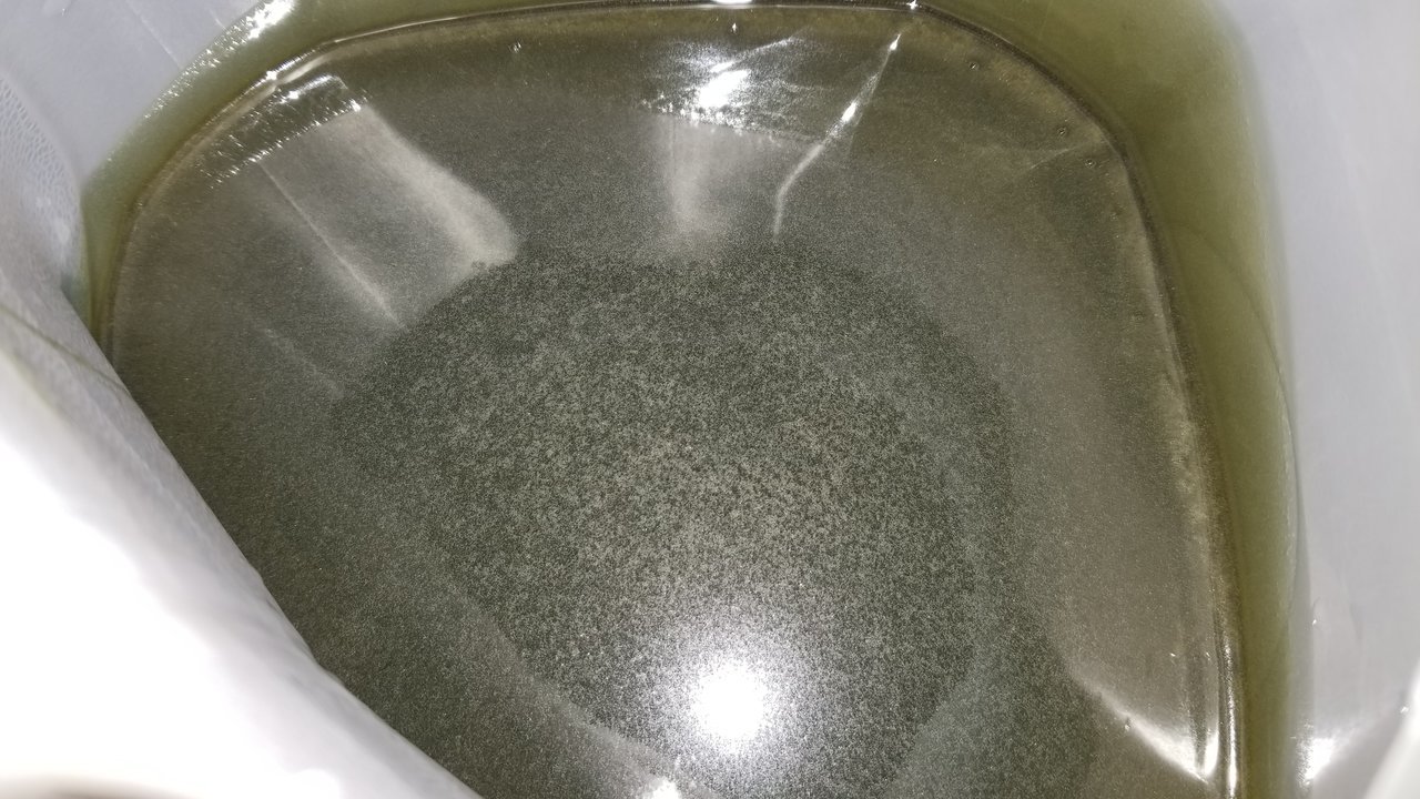

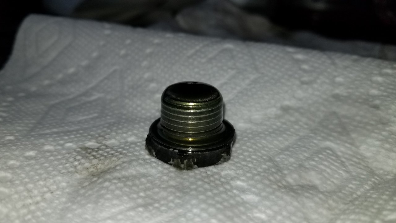

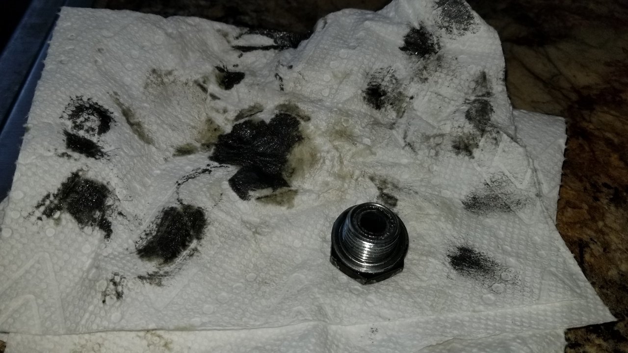

    ECGS rear diff break in complete. Just over 500 miles.
    Just put fresh Lucas 85W-140 in as recommended by ECGS.
    Took a little over 3QTs.

    Doesn't look nearly as bad as the last time. Fingers crossed.

    I will say that 36ftlbs of torque on the drain and fill plugs seems awfully weak. Hope they don't leak! Then again my torque wrench is pretty long so...
    And I also didn't think ahead and get new crush washers. Didn't realize there were any. *fingers crossed*
