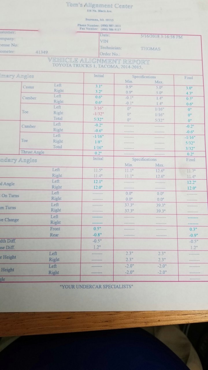

    Getting the alignment did. Noticed uneven tread wear on the outside of each front tire. Truck has ALWAYS pulled right really hard.
    Alignment shop set my front caster on the right front at 4.3 and left at 3 to see if that will straighten her out.

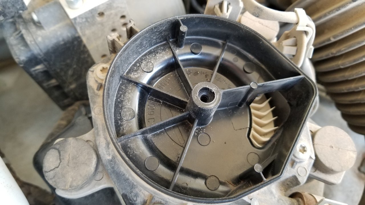

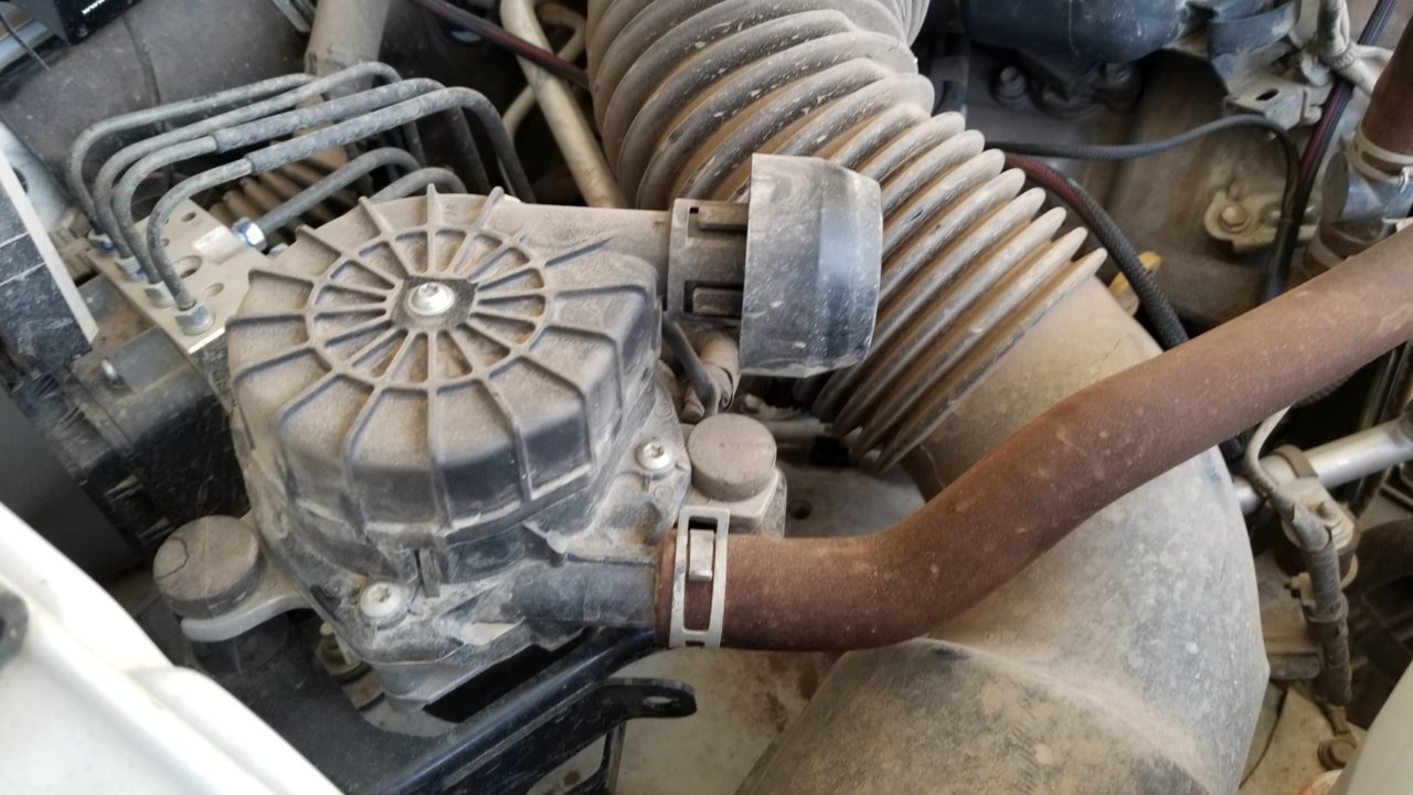

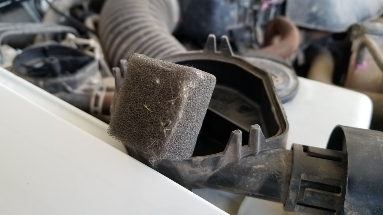

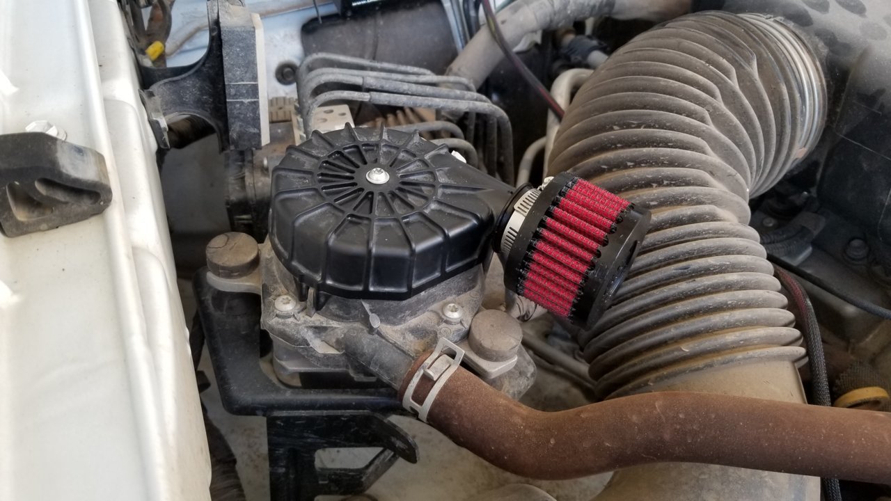

    Finally did the filter mod on the government exhaust pump.

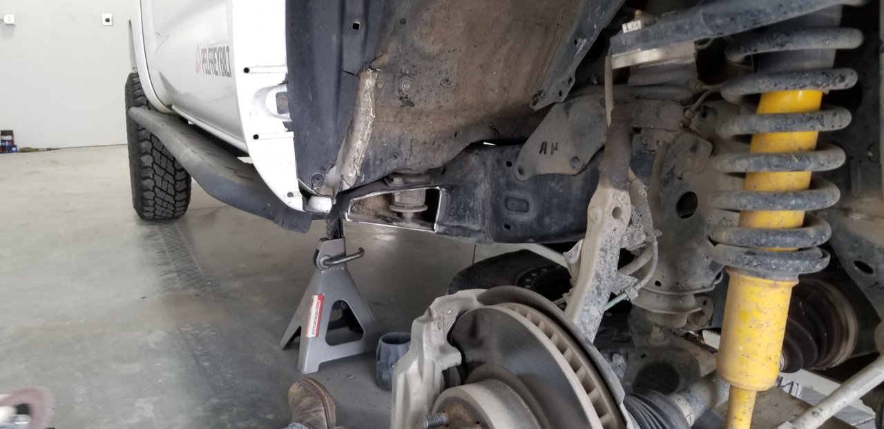

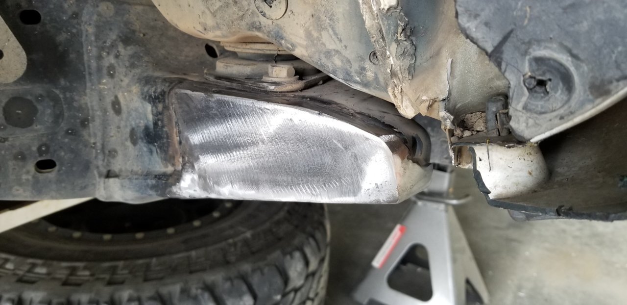

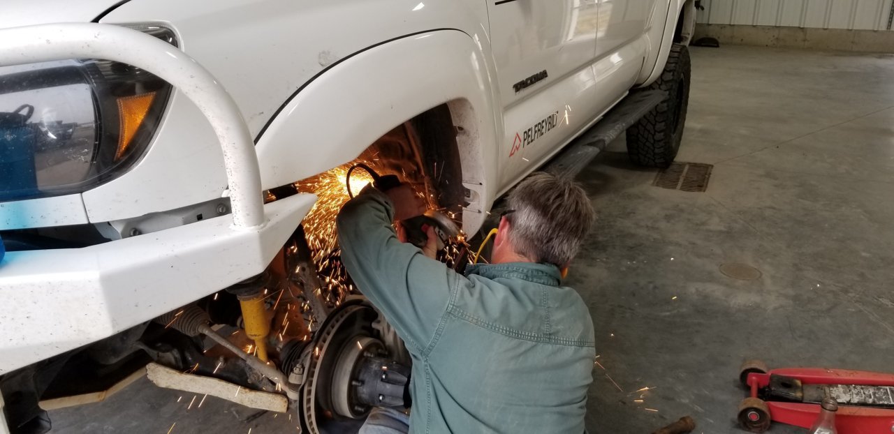

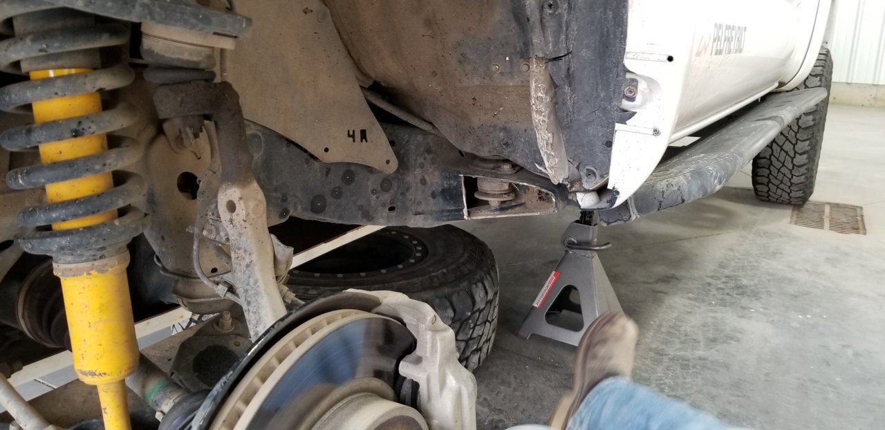

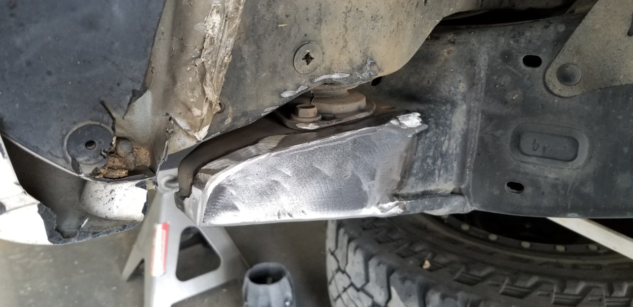

    Cab Mount Chop complete thanks to a local Fabricator/Welder.
    For reference this is what got cut out:
    Once I get the 285's mounted I'll take time to trim the fender flares as needed.

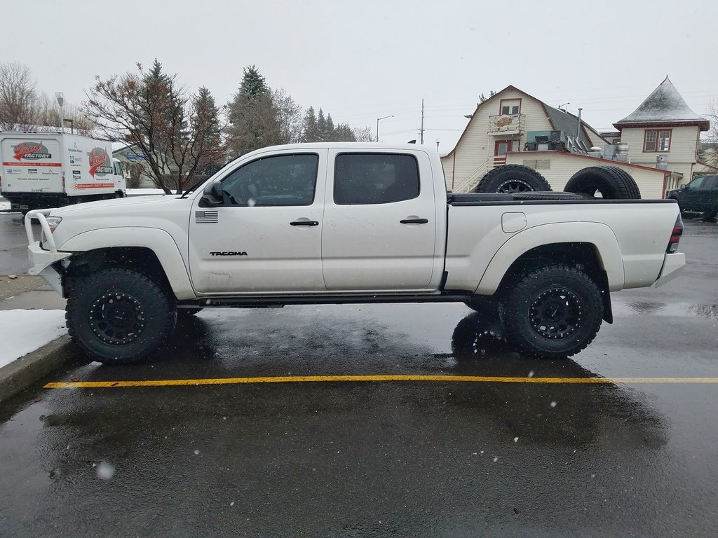

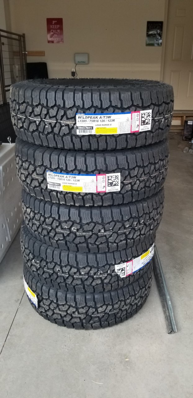

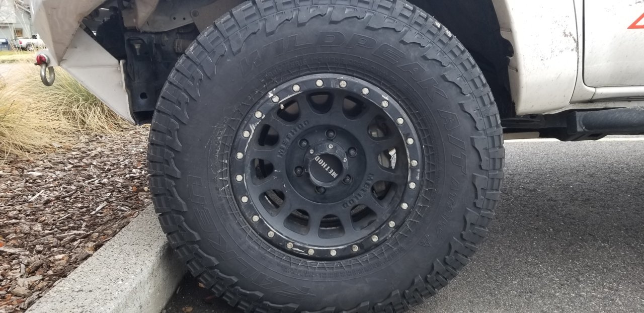

    Finally got my Falken Wildpeak AT3W mounted.

    What are your first impressions with the Wildpeak AT3W?
  17. Nov 4, 2018 at 6:05 PM
    #1037
    Kyitty
    Kyitty [OP] Mr. Beard
    Feb 20, 2015
    #149179
    9,586
    Bozeman, MT
    2015 Tacoma DCLB Better Than TRD
    See Build Page
    Over 100 miles so far. Nothing by rain/wet and dry roads. Fairly quiet. My ST MAXX were quiet too but as they aged I think they got louder. Pretty sure these are quieter on the highway. Ride smooth so far as well.
    Bumps feel smoother too. But I'm at 30psi right now on 285s. My ST MAXX were 255 at 34psi. Granted both my UCAs just got replaced so it's not a specific comparison. Though the Coopers are known for rigid sidewalls.
    I've yet to get a chance to chalk test to determine the right PSI. Roads keep being wet.
    Good looking tire. But I got them for price and snow rating. Looking forward to see how they fare this winter.

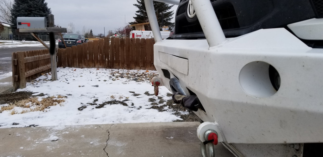

    Finally got some time to peel all the stickers off my truck that advertised for a bankrupt company. Thought about leaving a couple on because it looked funny.

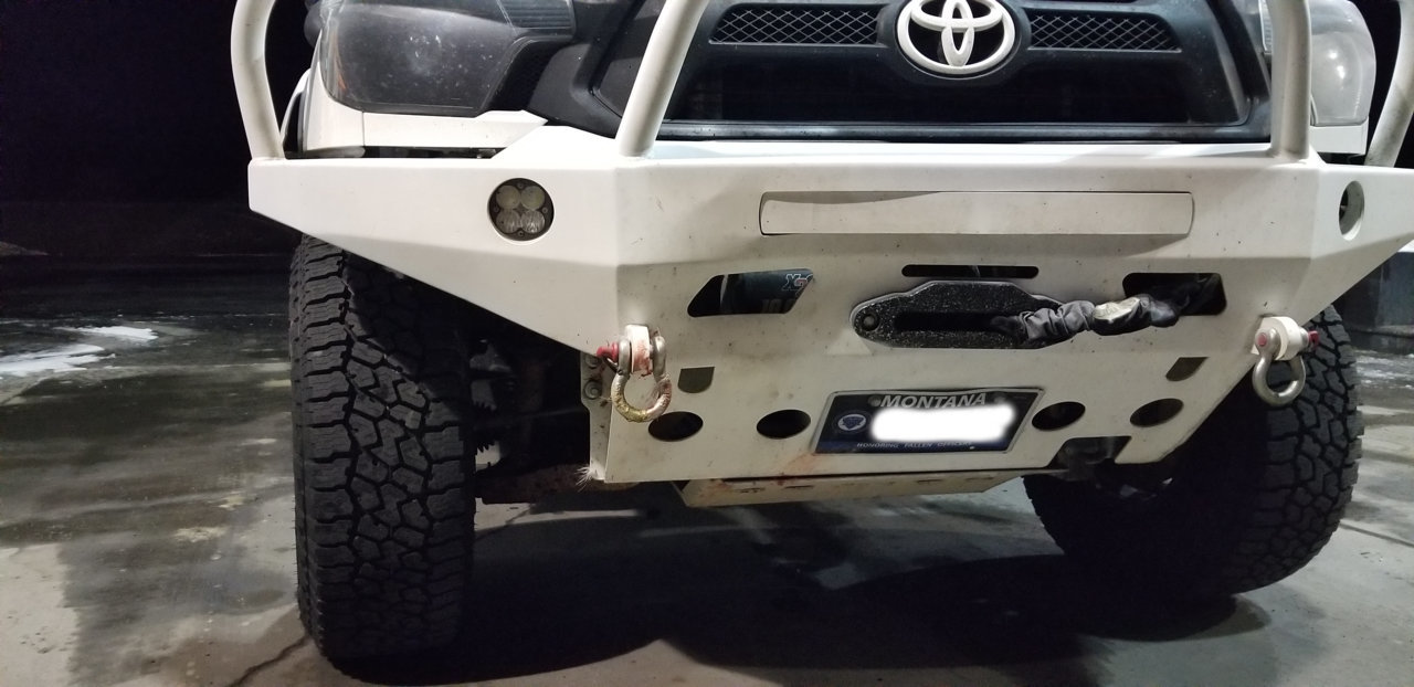

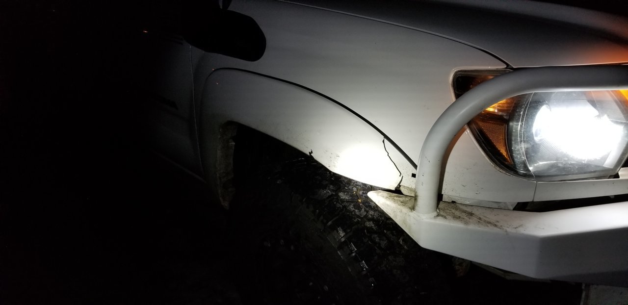

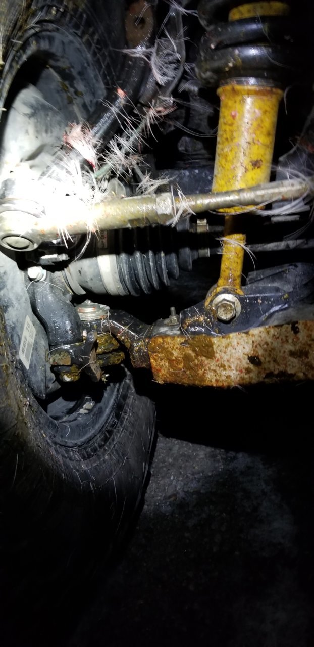

    Then, last night, on my drive down I-90 in Montana I hit a deer. I have to say the bumper, made by the bankrupt company, prevented a LOT of damage. Cruising at 84mph and hitting a full size whitetail deer dead center would have completely disabled a stock Tacoma. Of that I'm certain. In the video below you can clearly hear me stop talking mid sentence. I saw the deer and immediately hit the brake pedal. It all happens so fast that the GPS in my dash cam doesn't even register the speed change until after the impact. You can JUST see the front end of the truck begin to dip (as I hit the brakes) just before striking the deer.
    It was pitch black on the interstate and there was a lot of traffic behind me. I didn't go back looking for the deer for safety reasons. On my journey back through this stretch of road today I saw what was left of the deer. It was literally in pieces. Looking at my truck it appears the main portion of the deer's body impacted the area where my winch fairlead is located. The head would have gone under the front passenger tire. I clearly felt both passenger side tires go over the deer. You'll see in the video the truck was forced partially out of my lane due to the impact to the front passenger tire.
    There are small blood spots all over the passenger side of the vehicle. There also seems to be blood and such on the undercarriage and likely on my skid plates.
    The truck was completely drive-able thanks to the protection afforded by my steel bumper. This is exactly why I bought this particular bumper, adding in the hoops going over the headlights. Because in Montana we have deer. Everywhere.

    That’s some clean work! How much did he charge if you don’t mind me asking?
    mtmudrunner likes this.
  20. Dec 13, 2018 at 7:40 PM
    #1040
    Kyitty
    Feb 20, 2015
    #149179
    9,586
    Bozeman, MT
    See Build Page
    I can't say. I was the first Taco he'd done so there was some give and take. He's clearly skilled though. And he's a perfectionist. He wasn't done until he was done. His welding rig is mobile too!
