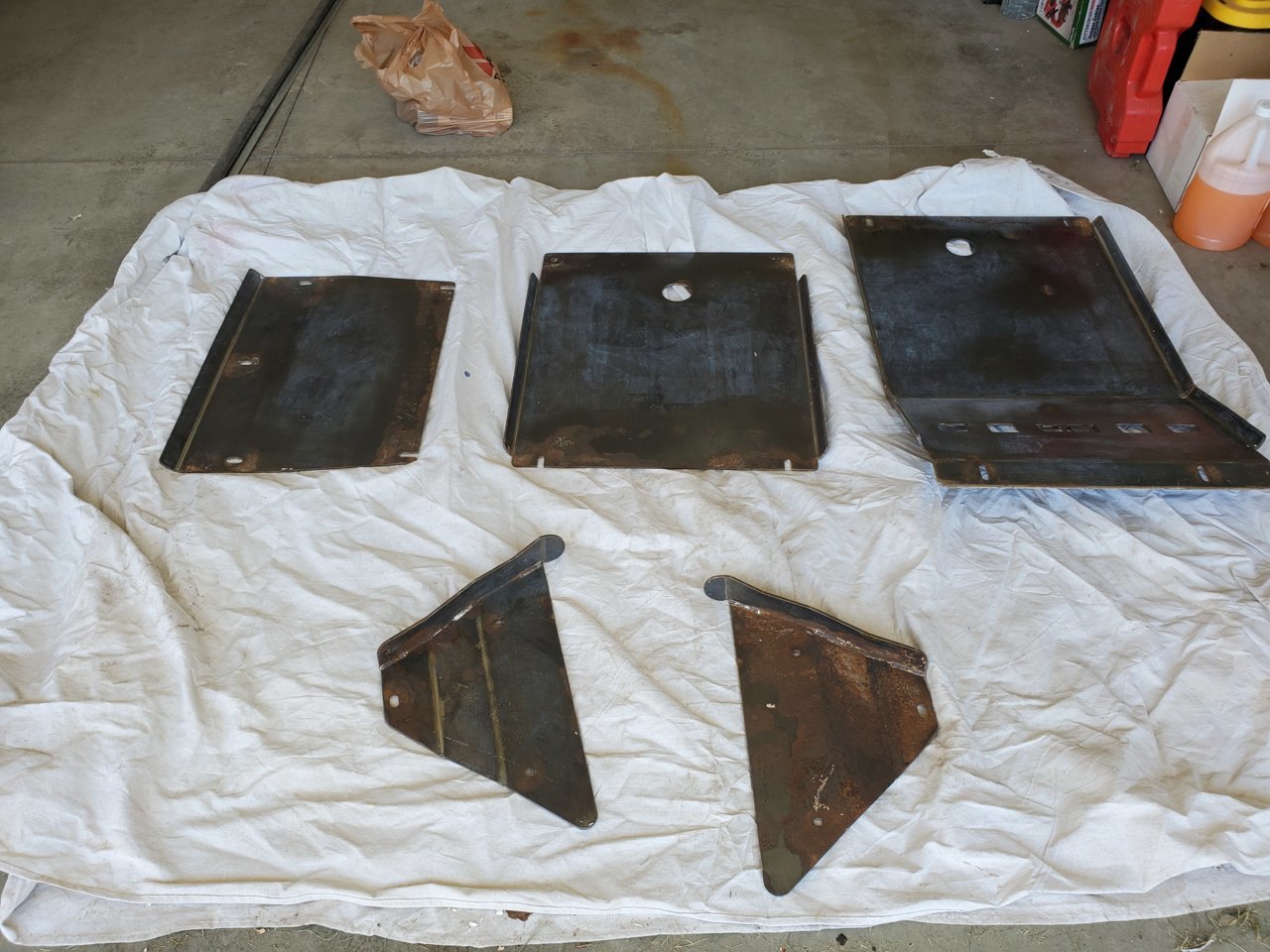

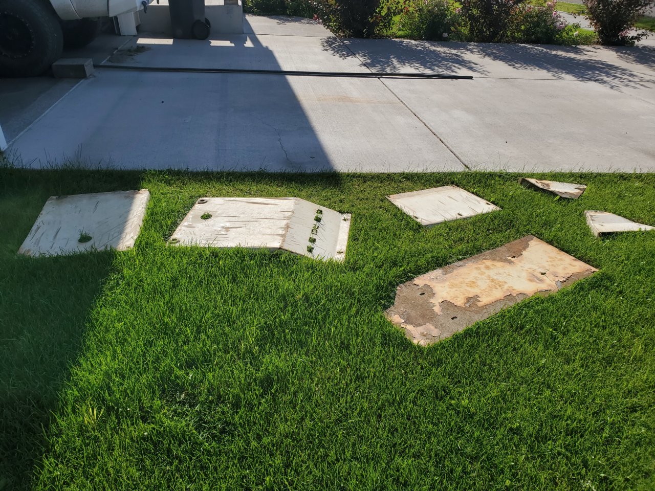

    Pulled the skid plates off. They're getting rusty and need to be stripped and repainted before winter.

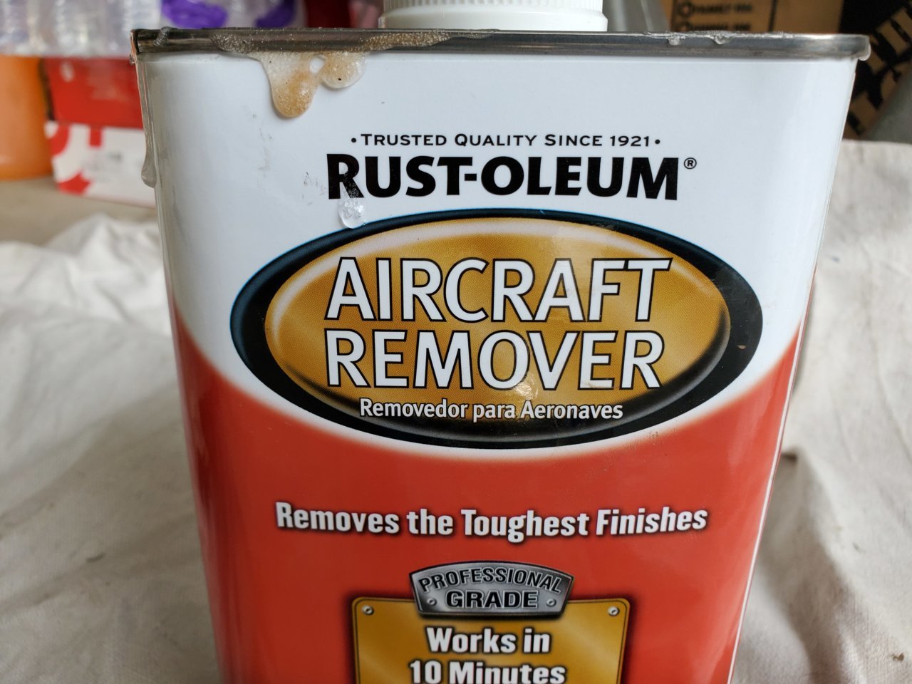

    Spent a little time here and there applying Aircraft Remover to break down the powder coat. Then scraping it off. Only sandblaster I could locate in town wanted $155/hr and couldn't tell me how long it would take.

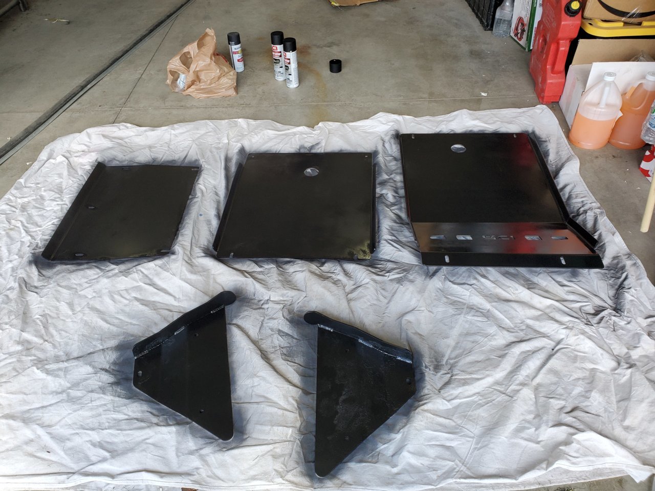

    Finally got them stripped down today after a week. Washed them, sanded surface rust, washed again and began coating with a Black Satin Enamel.

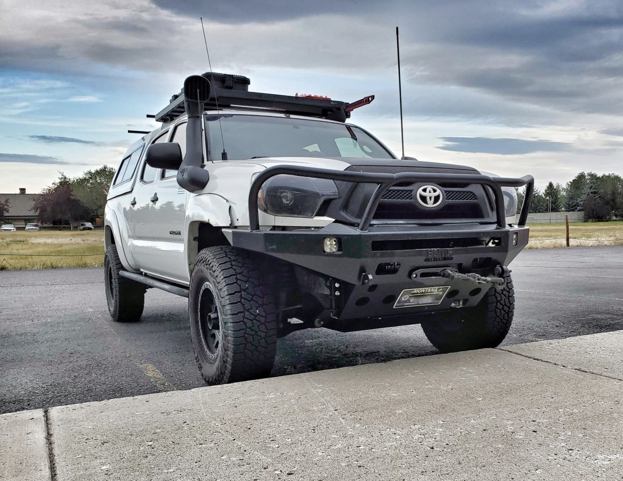

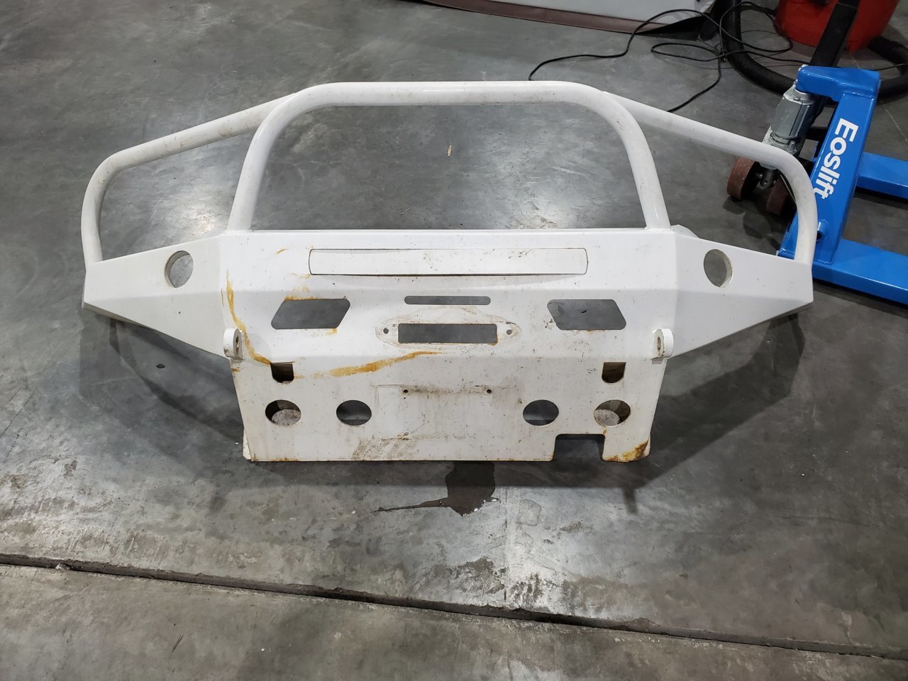

    In other big news... the Pelfreybilt bumper came off last night....
    Replaced with a brand new BAMF bumper from @JLee
    As much as the Super White Trail Limo was my trademark... I actually think this black on white thing looks better.
    Next I'm thinking about removing fender flares and repainting the grill.

    Got my Front and Rear differential fluids changed Sunday night. Also topped off the Transfer Case a little bit. Then I got my repainted skid plates put back on. Though somehow I'm missing a couple bolts for my LCA skids so I'm gonna have to figure that one out.

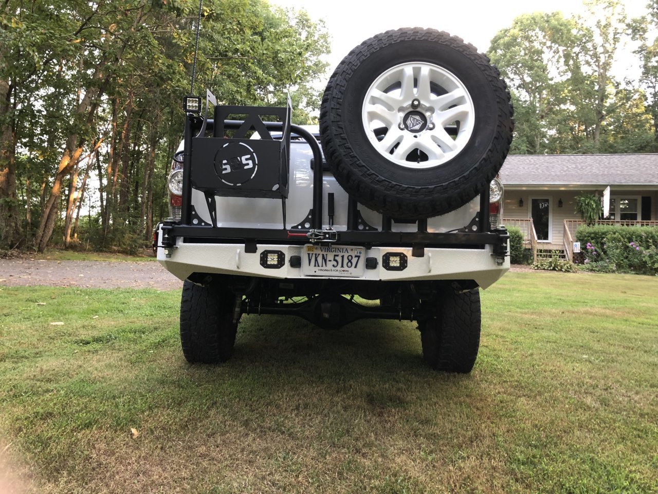

    I haven’t been on here as much lately. I did the opposite and went from blab class bumper to white and mixed the rear
    Still rockin the white wheels for now

    Here's how mine sits.

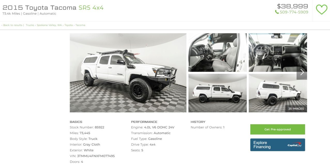

    Wow! It's been two years since I've posted on my own thread? Goodness!
    Sold the Tacoma. Dealer in WA has it now. Holy cow are they proud of it!
