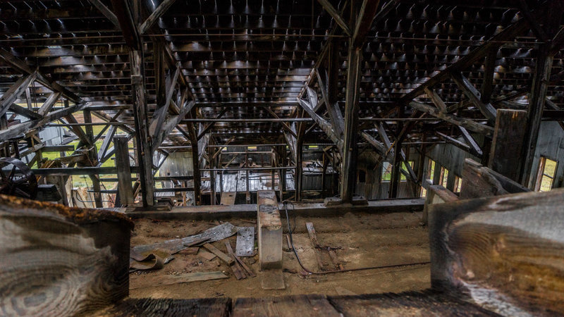

    At the end of the ride we came across the old "Comet Mine Camp" which is now a ghost town. The official population is 3 (caretakers who preserve the area). Really, really cool walking through these abandoned buildings.

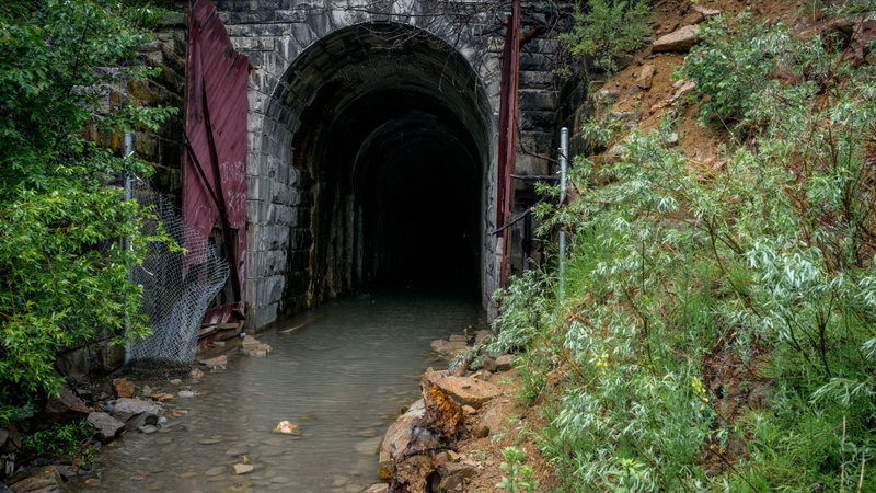

    This is the Wickes Tunnel (aka Boulder Tunnel). It was apparently built originally for a train line that was never completed. Now it's full of water and gravel. It is measured at 1.2 Miles straight through a mountain side.

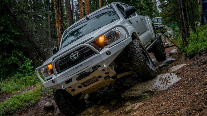

    Glorious photos the club took of my truck...
    Love this Tripod shot! Nothing more awesome than the FEEL of lifting a tire off the ground... even if it's just a little. Makes me all giddy!

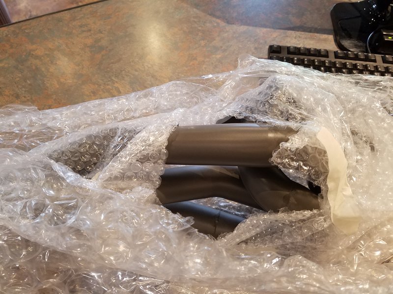

    URD Headers showed up! They packaged those suckers REALLY well. Wrapped in bubble wrap, then in foam sheets, then in paper. I didn't actually unwrap them all the way since it's not install time....
    But here's a 'skirt lift' photo...

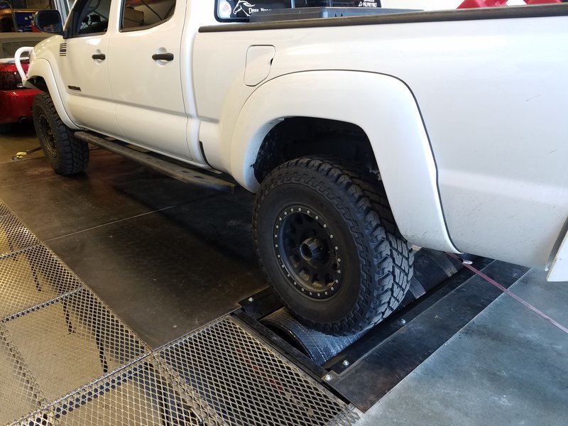

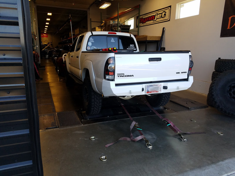

    So I had the truck on the DynoJet this morning! Never done that before so that was kind of interesting. The kids complained about it being "loud" and said they couldn't hear themselves screaming while the truck was running.
    Setup:
    Video:
    Results:
    The first and 3rd runs are the accurate ones. The second run we hit the rev limiter pretty hard! The dyno tech thinks the motor also had some heat soak at that point. So it showed a big drop below the 1st and 3rd runs.
    The guys at Darkhorse Customs who did the dyno run for me were great to work with. The initial first run showed as, IIRC, 195 RWHP. However, he said there are different settings on the machine to tell it what number to display. It's sort of a "here's the real HP to the wheel at the drum" vs "here's the estimated HP using an estimate for drive train loss". They said 20-25% is roughly the drive train loss. Doing simple math 195 HP + 20% = 234HP.
    So there you are! Dyno run in advance of URD Spec-U Headers. I'll post up results next Thursday after we do a follow-up run post header install.

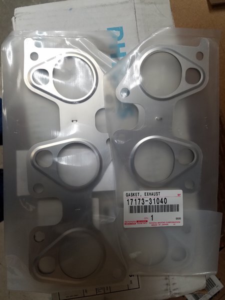

    Just got my OEM Toyota Manifold Exhaust Gaskets.
    Can't wait for Monday! Header upgrade here we come!
