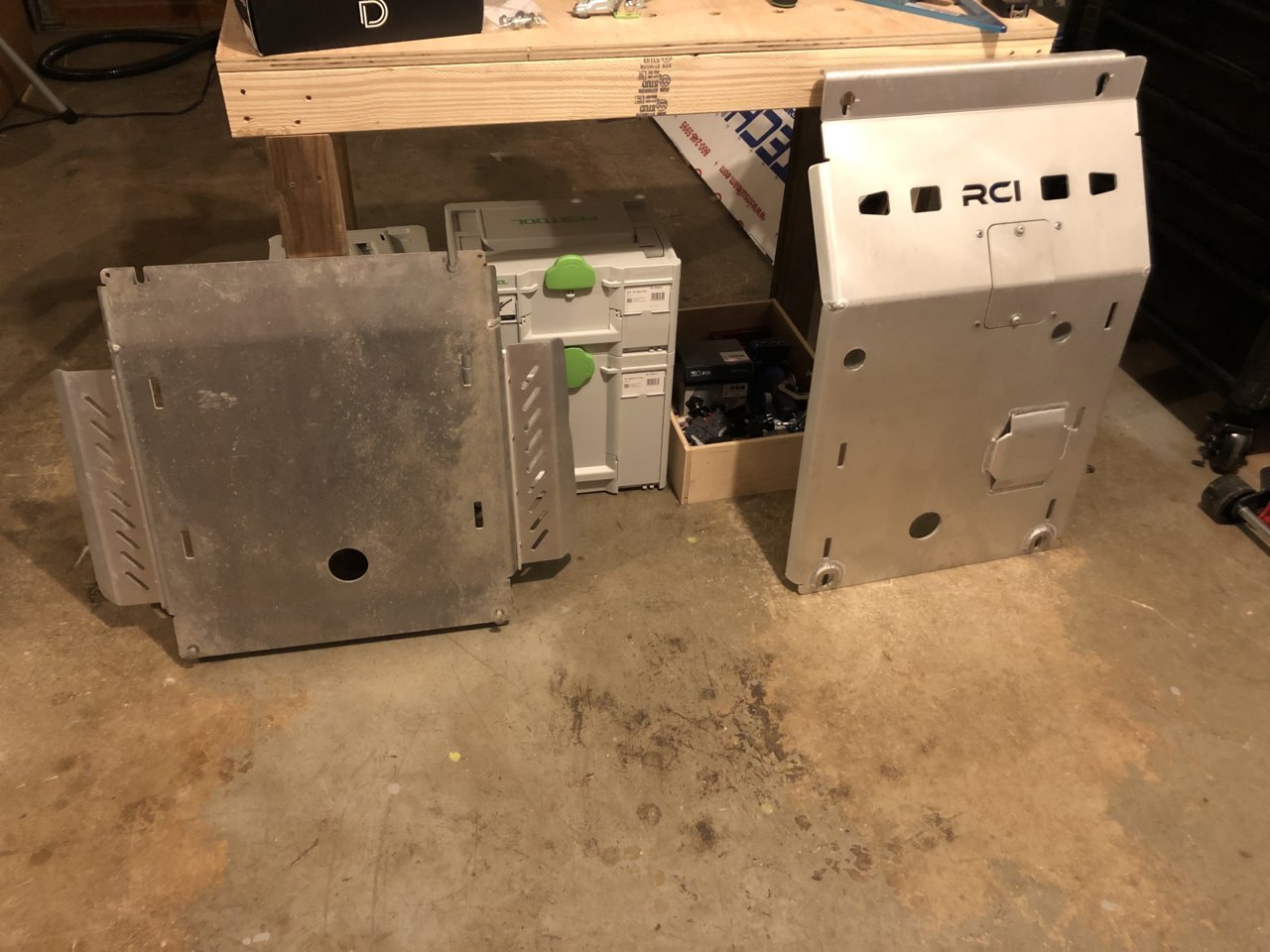

    Fell into a nice deal on an aluminum version of my skids, so I’m going to make the swap after I paint them.
    It’ll help cut weight for when my bumper gets here. I need to order up my 14” coils still.

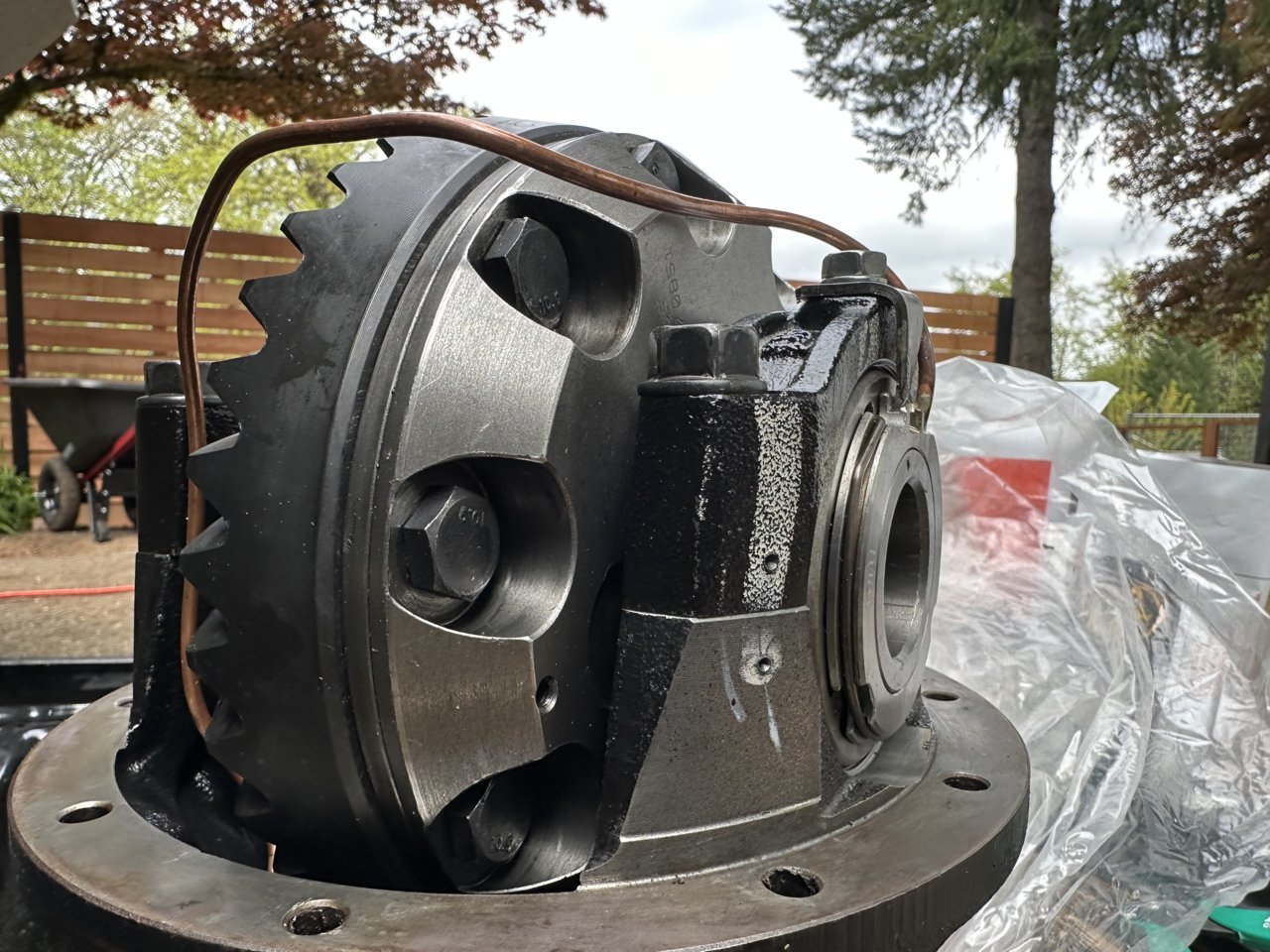

    How many times are we going to do this?

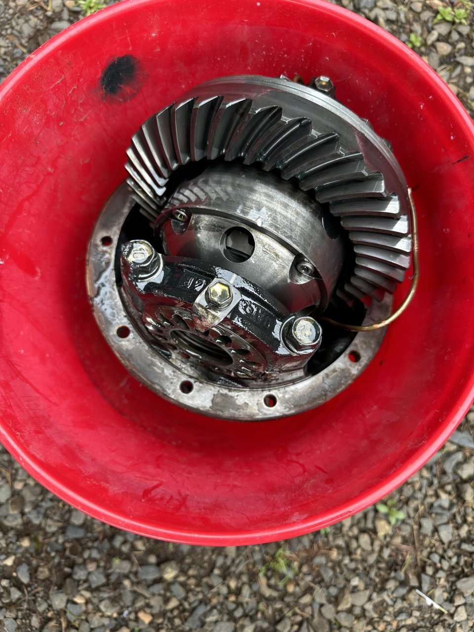

    5th time pulling the rear differential. This time I think the pinion preload came loose. Sending off to Nitro for diagnosis and more than likely a full rebuild.

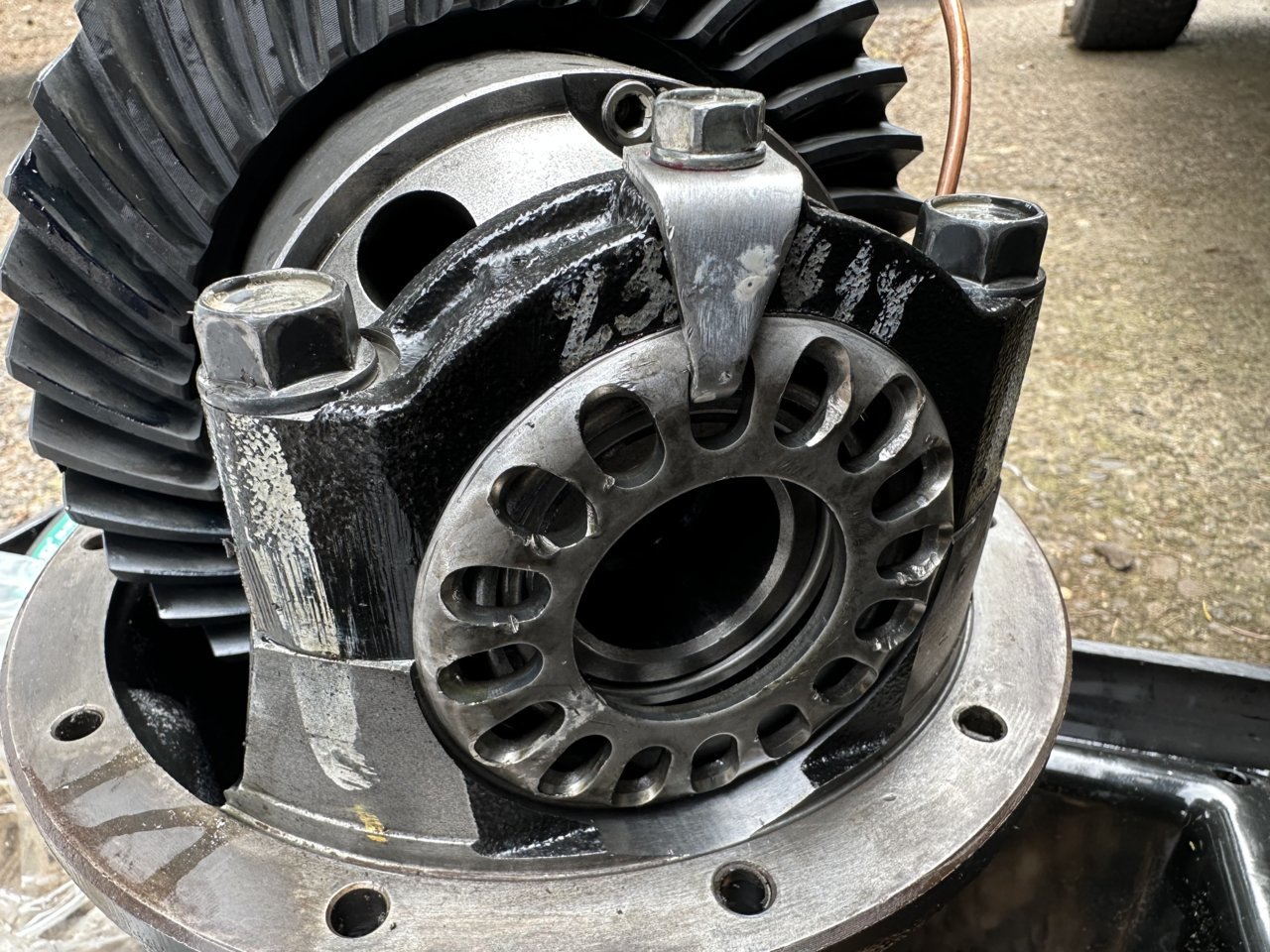

    2020 4Runner SR5 Premium | RAM 1500
    Diff rebuild is done. My pinion started acting up after I pulled a skid steer out of a ditch… had a massive whine when decelerating. Sent the diff in a bucket directly to Nitro Gear to install a new ring and pinion, master install kit, a solid spacer to prevent the pinion from unloading, and then they rebuilt a lot of my air locker.
    Finally off of jack stands after almost 3 full weeks. First drive I noticed the issue is gone. Just regular ol diff whine remains. I’ll do the full break in procedure tomorrow and then swap oil in 500 miles.
