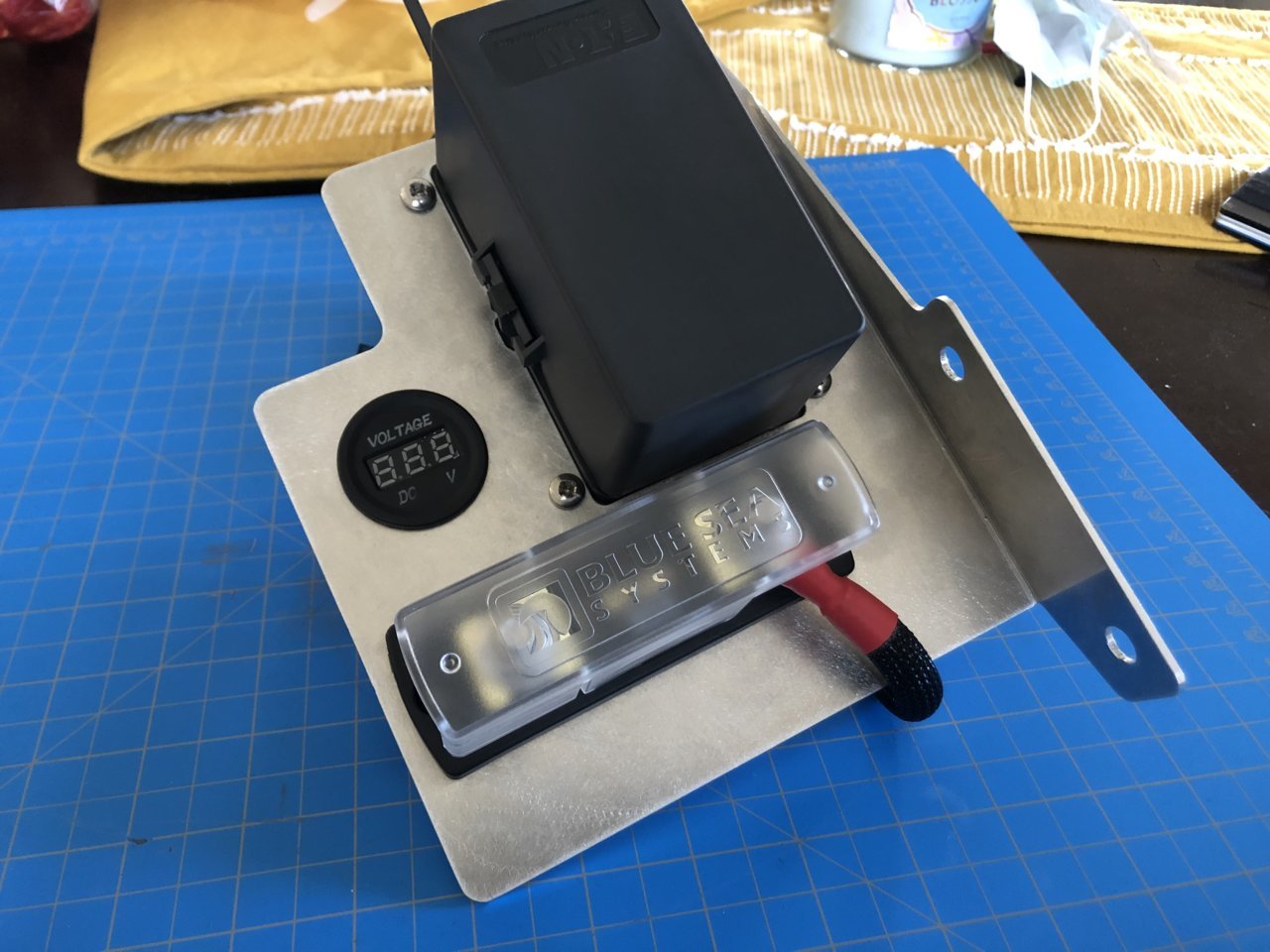

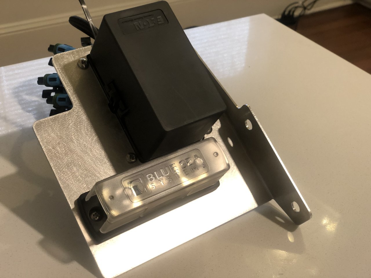

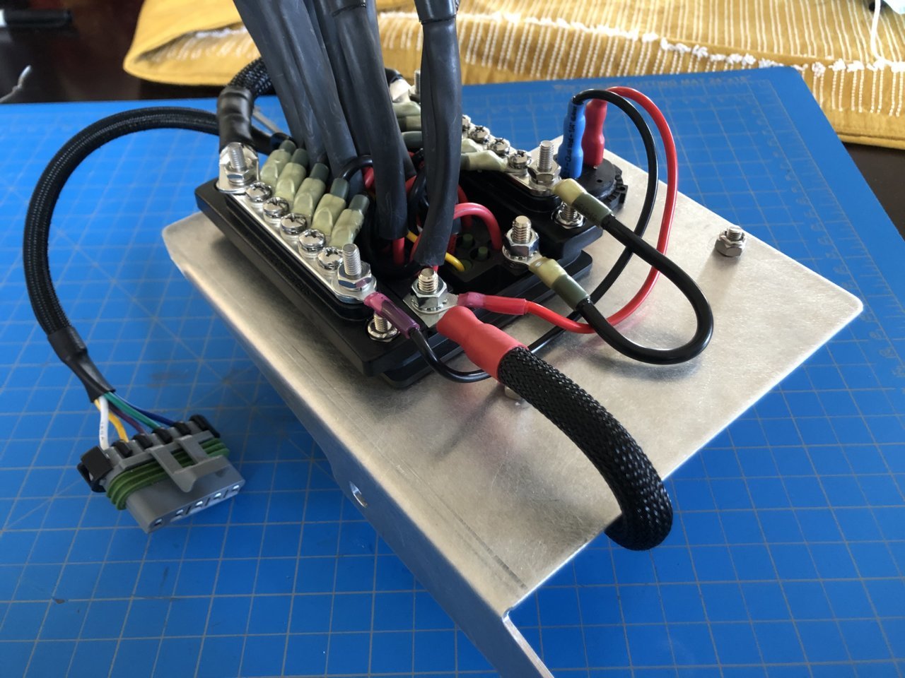

    My “micro footprint” Bussmann is almost done. I just need to modify some large gauge cables and it will be ready for install.
    I did a test fit and think everything should line up nicely. I have Metri Pack 280 connectors coming for all of my existing exterior accessories. Took about 2 hours to write everything out and make sure I got the right terminal and seal sizes for the accessories. My bed lights are 22 awg so that will be fun... never worked with the tan Metri Pack seals. The goal is to have a Metri Pack 280 Male + Female at every accessory (to mate the accessory to the wire harness) and then obviously a Metri Pack 280 Male to connect each accessory to the Bussmann.

    Finished my main power and ground cables. Then I found a flush voltmeter that I used on my Jeep and decided to throw it on there. The way it’s wired it will tell me 1. What my battery voltage is. 2. If my Bussmann is receiving power in the case I’m having power issues with an accessory. 3. If my Bussmann is dead in the case that I intentionally disconnected it and want to make sure I don’t get shocked. The draw from this thing is nearly negligible so I’m not concerned having it reading my battery 24/7.
    Final layout and ready for mounting:

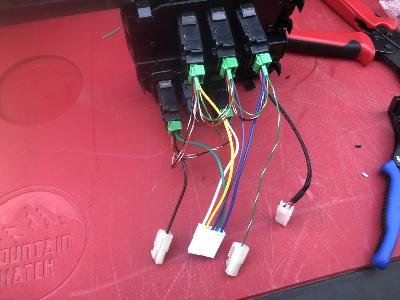

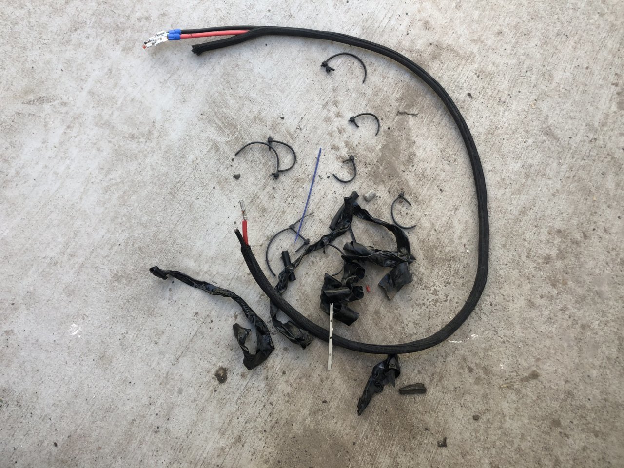

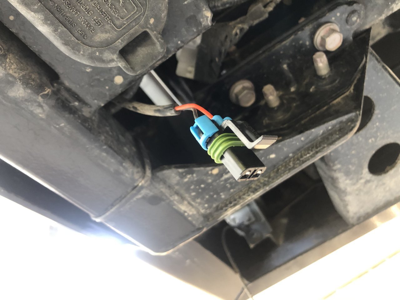

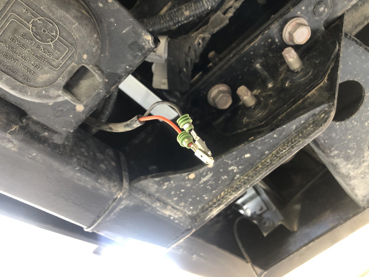

    Started the transition from spade connectors on my exterior accessories to Metri-Pack 280 today. Knocked out the super long run from the rear of the truck to the engine bay. In the back I have bumper lights and bed lights so I made a new harness using all of the old wiring as a measuring tool and combined them into a single loom. Some of the ends don’t have Metri Pack connectors in this picture because it was just easier to run the wiring that way.
    Undoing the old wiring resulted in a bunch of junk lying around. Kind of horrifying going over old work.
    Needless to say it makes me feel better knowing I have more robust connections on these accessories.
    Just need to zip-tie everything and it’ll be done. Then all of my other accessory wiring is in the engine bay and just needs to be swapped over to new harnesses / connectors.

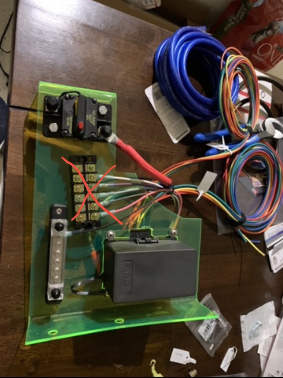

    This is what I currently have that I made and I'm gonna get rid of the terminal block with the red x for a 5pin plug
    Just trying to tidy up my engine bay of the wires

    That should work! The extra ground bus is a good idea.

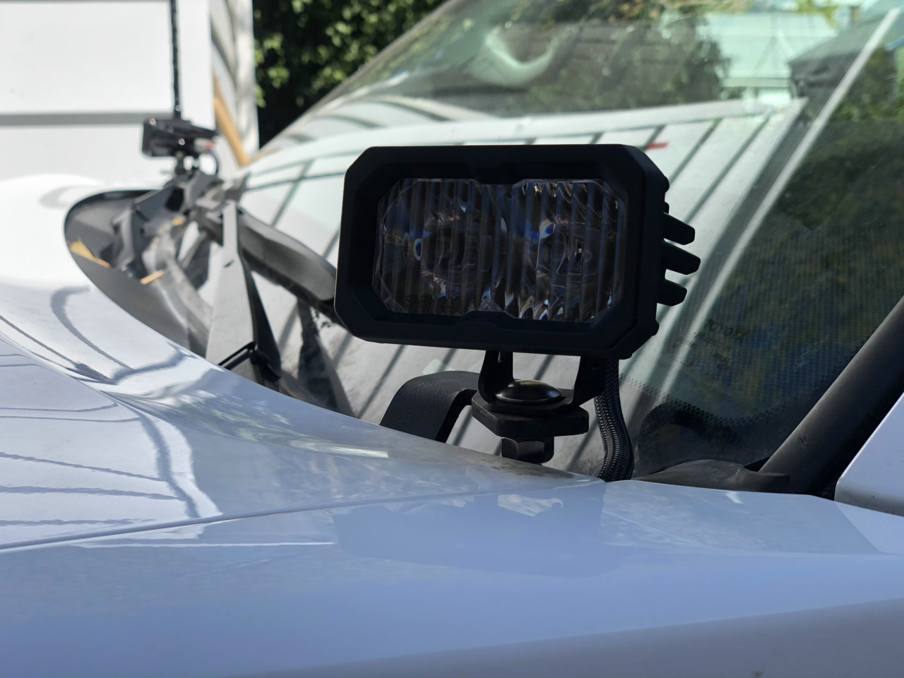

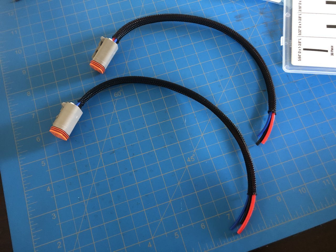

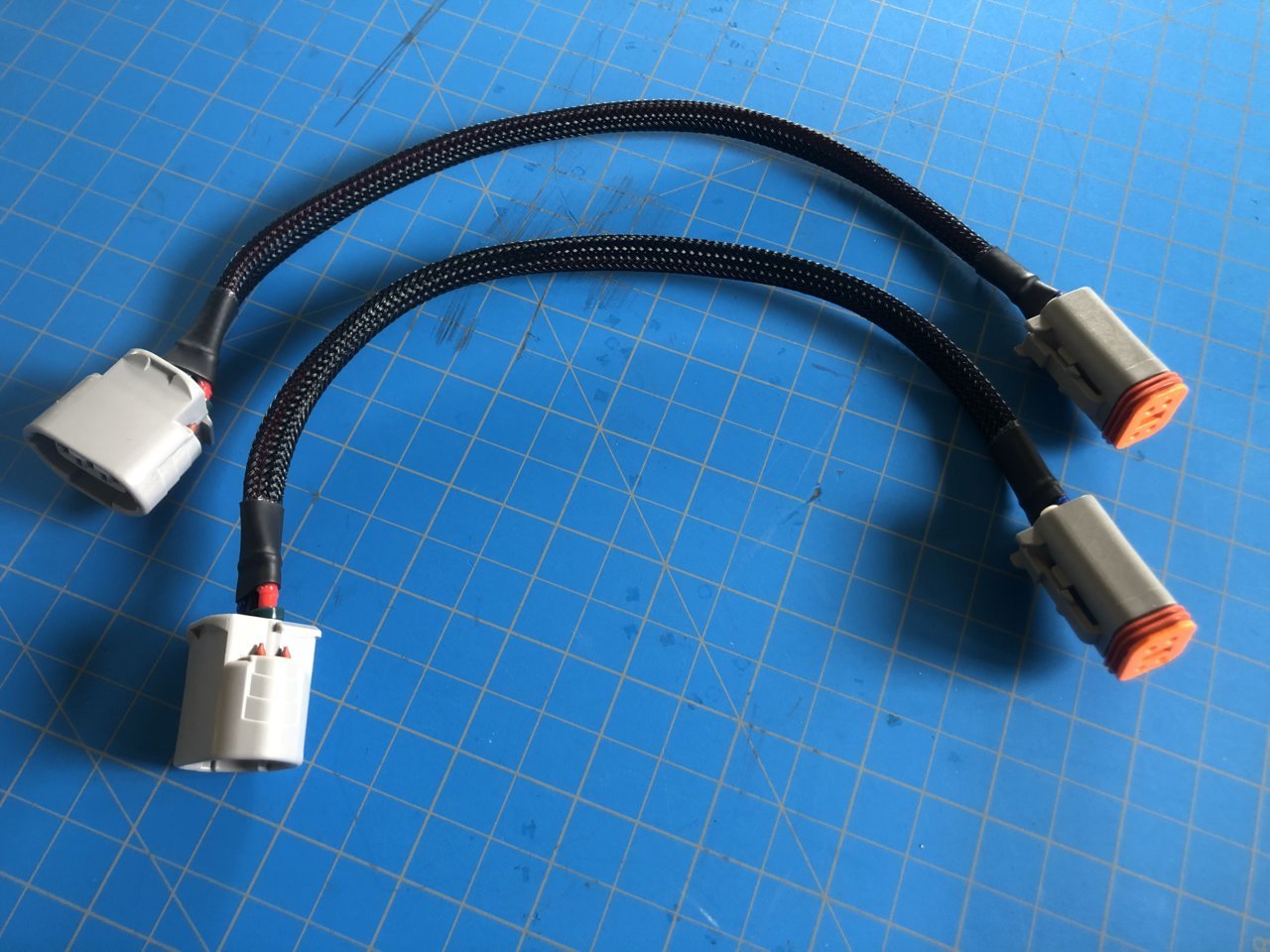

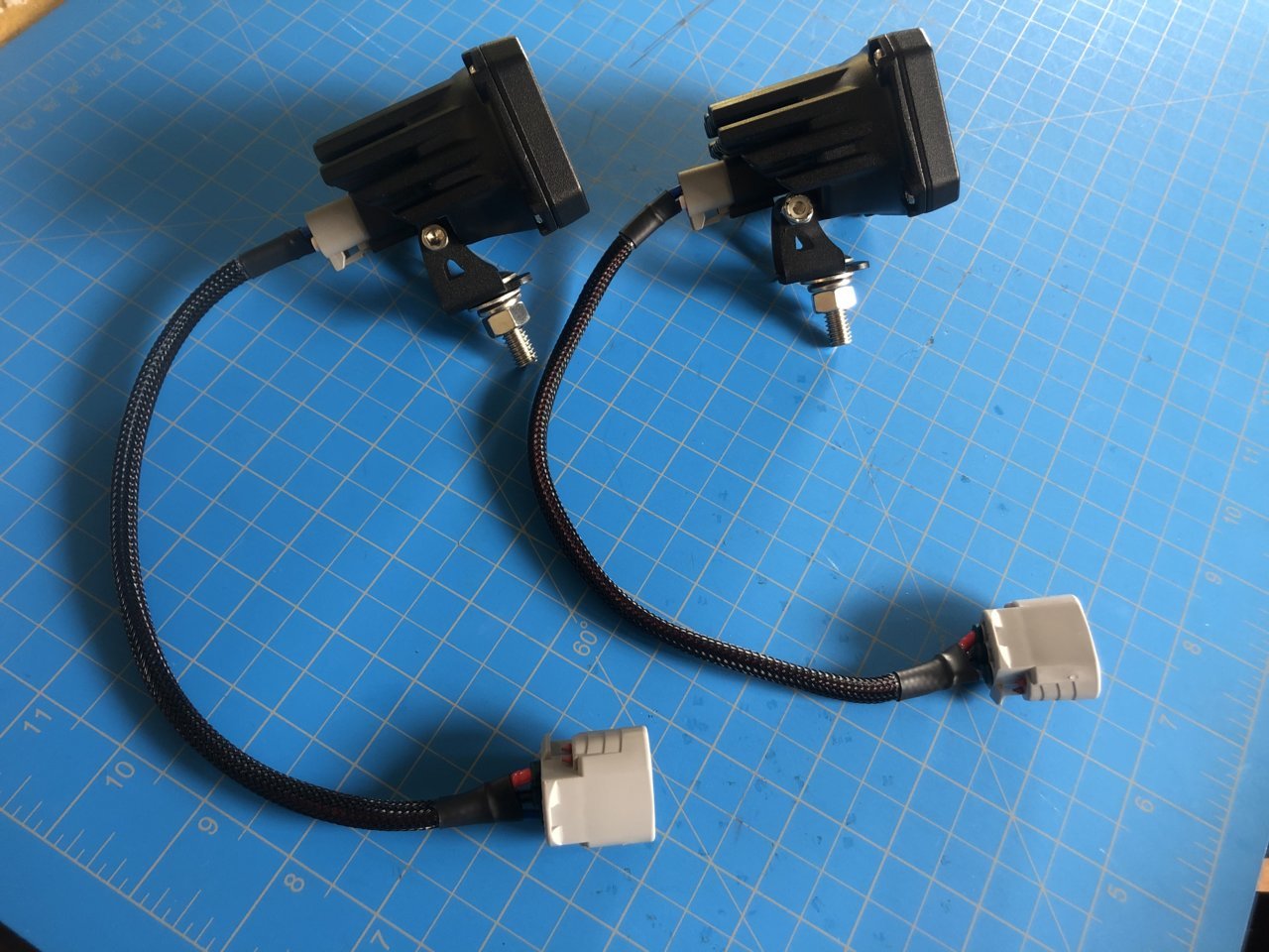

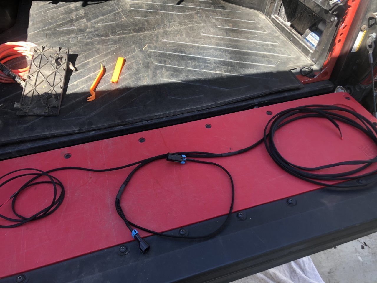

    Snagged a set of amber backlit SSC2’s to replace my ditch lights. I’ve got a design for a chase light circuit all around the truck that I’ll be working on over the next couple of months (or longer... because I take forever on stuff like this). I want the backlights to be on a switch but I also want them tied to my hazard lights. That way they flash on lock/unlock and when I hit the hazard switch :D
    The lights came with a nice Deutsch connector... but 3” pigtails?!
    I de-pinned the connectors and re-crimped new terminals with 12” extensions. Since the wires will be visible I loomed them to hide the colors. I also chose 18 awg for the backlight wire as it’s much more appropriate. Stuck with 16 for the main light.
    Finished them with heat shrink and a quality 3-position sealed connector to interface with the wire harness. Just need to work on my wire harness and connect them to the Bussmann.
    Then it’s off to working on the hazard circuit and gathering all of the other chase lights.

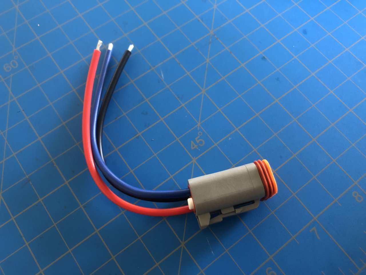

    So the way I did it I replaced the terminals inside of the Deutsch altogether so that I could have extra long leads without having to splice an extension. To do this you need Size 16 Deutsch terminals 14-18 awg (SSC2s use 16 awg). Instead of buying a super expensive tool you can get the "stamped" version that allows you to use your open barrel crimp tool (so 6 or 8 of these). I broke the wedge locks when de-pinning so I had to get 2 more of those.
    To make my wire-to-wire connection I used Sumitomo TS 090II sealed connectors (very similar to what Toyota uses on the exterior). A female on the light-side and then a male on the wire-harness side. I really like to keep my connectors uniform so I am swapping them for Metri-Pack 280 3-positions I snagged from a buddy... but they are on a national backorder otherwise. I didn't put those in the pictures as I have to track down terminals for them. You can use a sealed Molex just fine (or unsealed -- I just follow the sealed = outside and unsealed = inside convention).

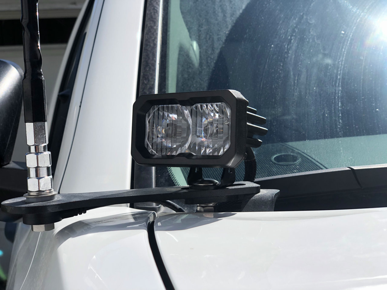

    SSC2's are mounted up and the first part of the wire harness has been constructed. Tomorrow I'll connect it, zip tie, and then work on the hazard switch function (assuming I have diodes).
    wally11 and SJBrown like this.

    Got it done right before work this morning. The backlight is on a dedicated switch + it will flash whenever the hazard circuit is engaged. No back-activation because I found some very oversized diodes. I love it!!! Time to gather more backlit lights and amber accents.

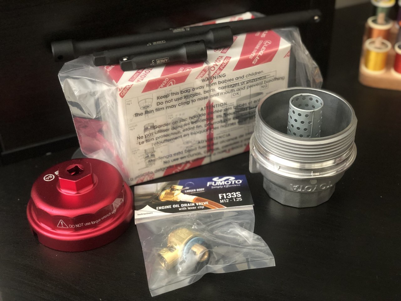

    Aluminum filter housing + fumoto for drip-free oil changes. I also got a really nice filter wrench and a stainless filter drain tool with a hose. Even got some 3/8 impact extensions just for the oil filter! I’ll get this installed this week.

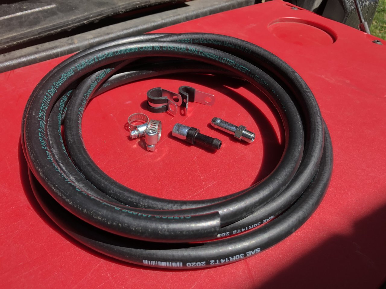

    Rear diff breather relocation. I’m actually almost done with this mod but need to get a different rubber clamp to neatly post it behind my tail light.

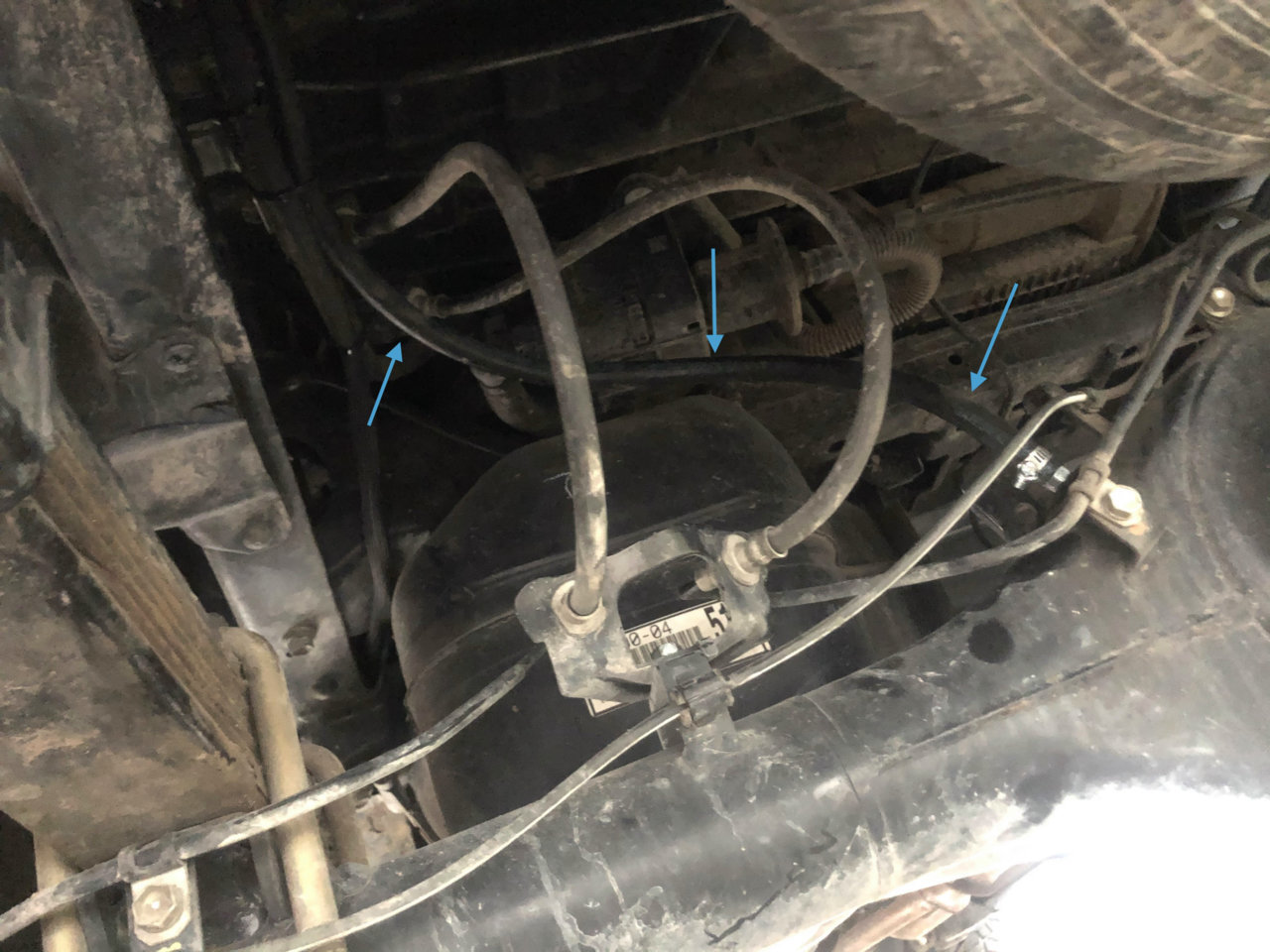

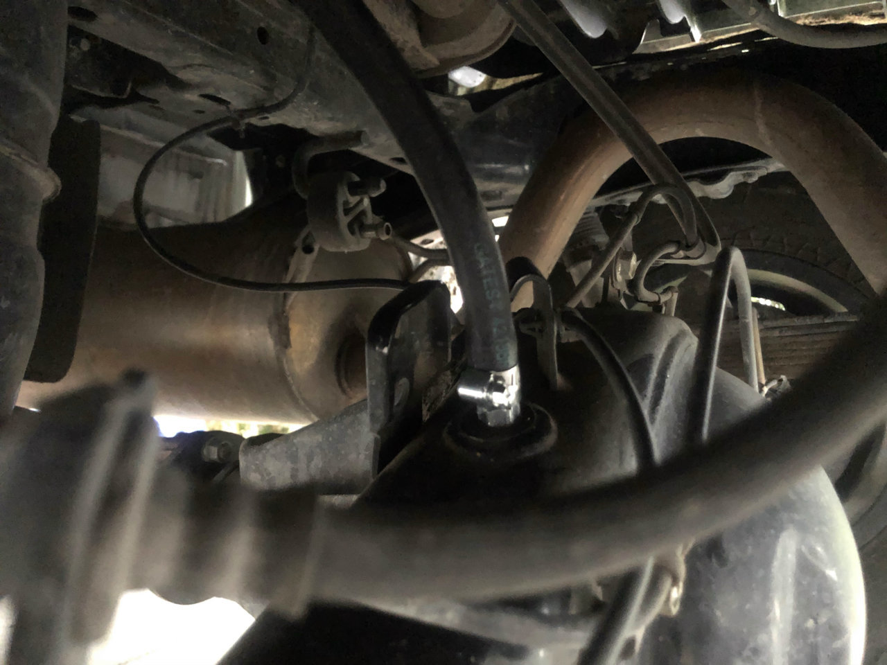

    Finished the rear diff breather relocate. Not too bad of a mod, although I had to use some lube to get the hose over the new union. Went on nicely and it's snugged up tight.
    I left some slack in the hose (you can barely see it) to account for axle movement. I don't think it'll stretch all that much as the diff breather is in the center of the diff; it's not on the end like the brake lines (diff oil is from me messing around too much -- it's been checked for leaks).
    Ran the hose alongside the wire loom that goes up to the tail light and zipped it every 8" or so.
    Secured it to an existing stud using an M6 nut and a rubber hose clamp. I think it looks pretty tidy! This tail light is busted but the plastic that is still available didn't have any issues mating with the factory tail light bolts. IMG_3971.HEIC.jpg
