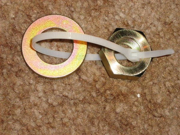

    well just got the L.R. U.C.A. and guess what its missing parts......
    what good is fast shiping if you dont get what u need....brutal
    anyone know where i can get a washer like this before saturday??????
    i thinks its 1 3/4" o.d. x 1" i.d. X 3/16"thickness
    its the round washer in the pic

    brutal-did you get them from fatbobsgarage? sucks, but i'd think your basic hardware store would have that kind of washer

    Brutal have you checked an Ace hardware or a Home-depot or Lowe's? That looks like grade 8 to me. They should have the same thing.

    You could almost certainly pick one up at a specialty nut and bolt store. They have a couple in my area that carry anything imaginable from the most common of nuts, bolts, washers, to the most uncommon on aircraft grade fasteners.

    yea it was fat bobs and they are sending out a new washer should be here on like wed. or so.....oh well i waited this long i guess i can wait a lil longer i go snowboarding then.....the washer size is 1/34" x 1" x 3/16thickness
    price and shipping were great
