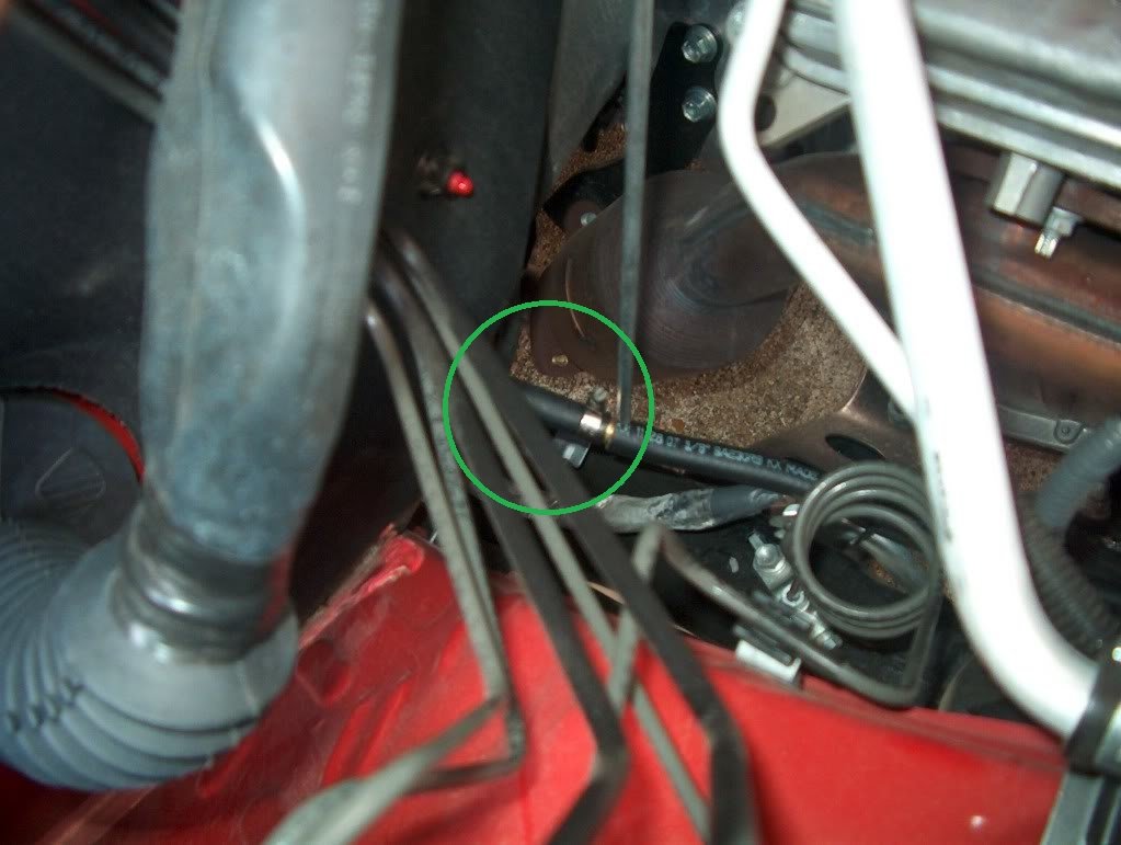

    22,295
    GHOST
    Passenger's side firewall. Small tube protruding and drains right above the frame rail (circled in green). This isn't my picture, but you can see that the drain has already been extended with a coupler and length of hose.

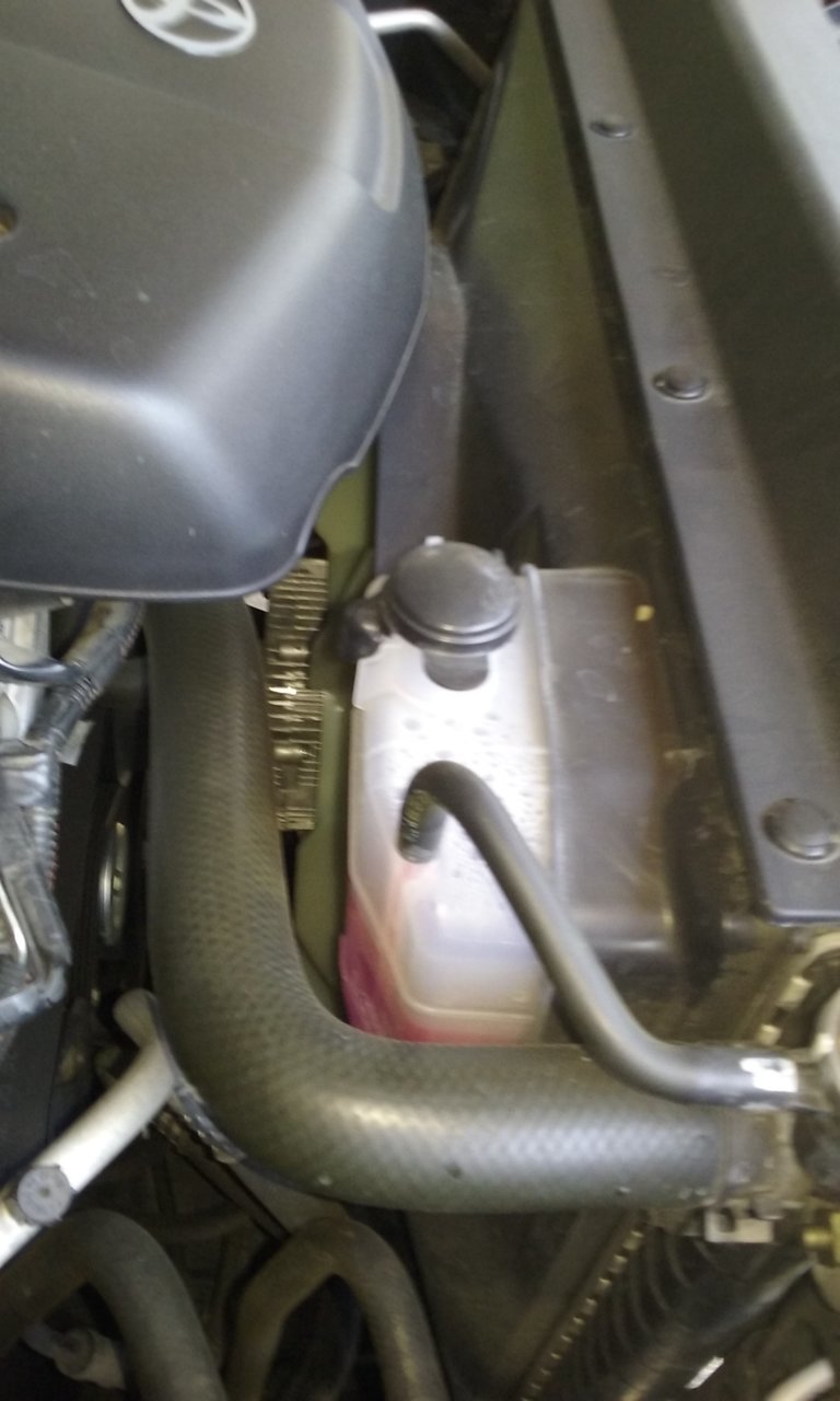

    Found the hose ... I think ... How long should the ac have to run until I see water? I let it run like 5 minutes and nada ... I'll take if for a ride and then see.

    That's it. In warm weather it starts to drain pretty quick. When you add the extension, just make sure to route it away from the exhaust and you should be fine.

    Okay, so took the truck to run a few errands ... maybe 20 minutes all told. There was a steady drip ... drip ... drip coming from the hose, guessing it's not plugged. Shouldn't be a lot right?
