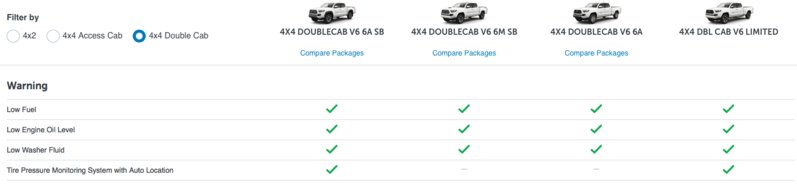

    According to Toyota 2017 specs - some Tacoma models do have TPMS, others do not. Here is a screenshot of the spec chart showing my 4x4 DCSB does indeed have TPMS, however the light does not come on when I installed 4 snow tires with no TPMS sensors.

    Huh. I was under the impression that all TRD, Limited, Pro models had TPMS... it's such a basic feature.
    Keep in mind that TPMS may work without sensors in the wheels, too. The vehicle would simply use the ABS/braking system to detect a slower-spinning wheel and throw a low-tire alert. My '05 330Ci worked that way.
    I wouldn't be surprised if Toyota took this shortcut on some trucks, but still called it TPMS. Just like the hill-rollback-assist shortcut on OffRoad and Pro models vs. the Sports.
    Try actually dropping your tire pressure by a significant amount in one tire (say, down to 15PSI) and drive around the block. You just might see a light come on the dash.
