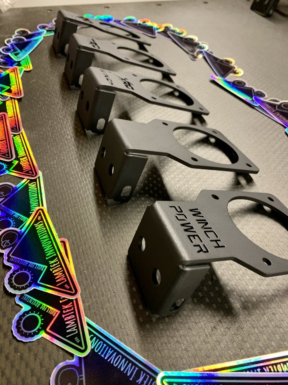

    LambTek Innovations - Winch Switch Bracket!
    www.lambtekinnovations.com
    A GIGANTOR thanks to @ClassyTacos for this awesome unboxing/install video!
    And another GIGANTOR thanks to @SeanS54 for this awesome video!

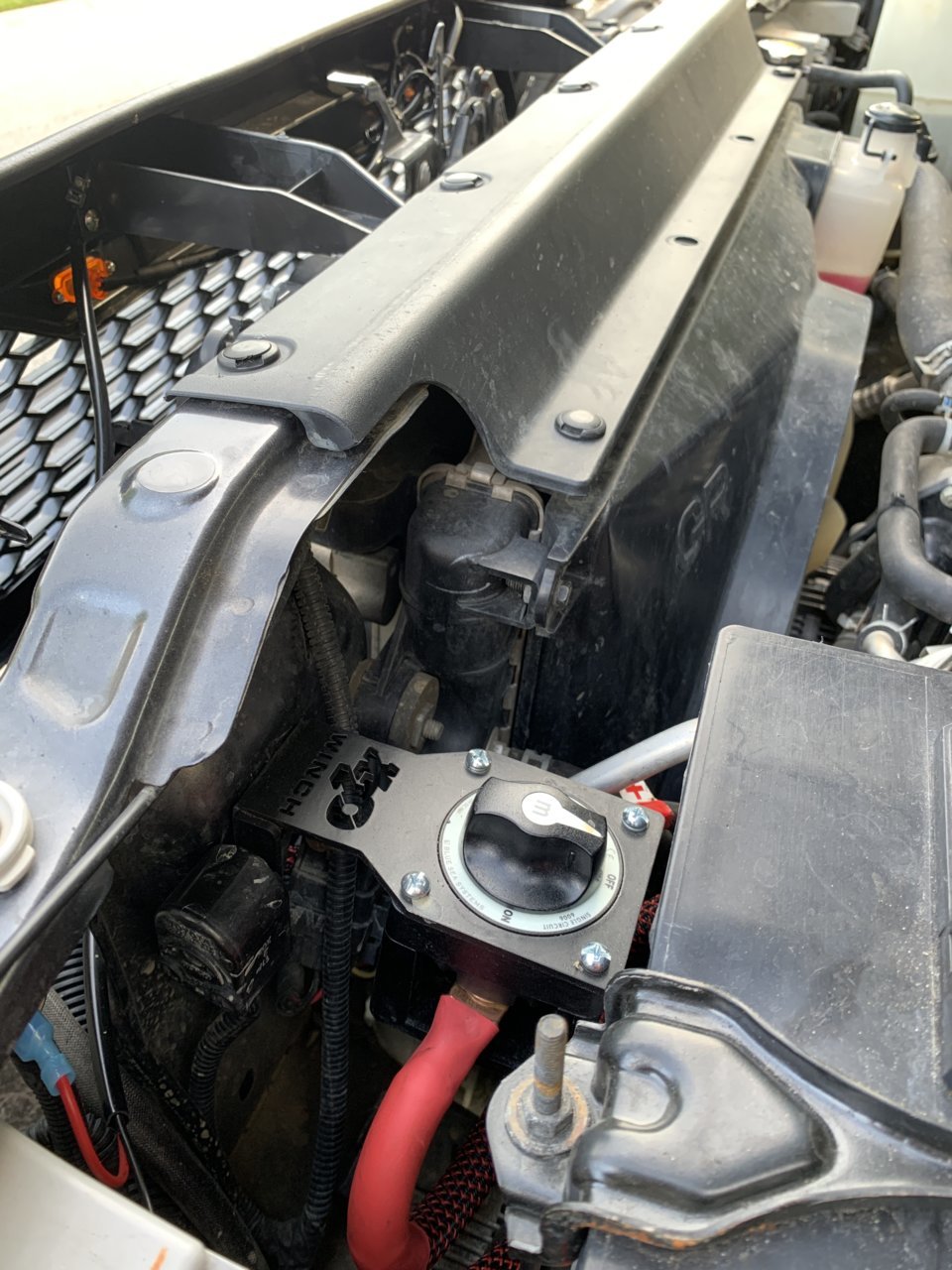

    Hi all, I have recently designed and produced a winch switch bracket to hold a Blue Sea switch, that mounts in front of the battery. These are designed to fit 2nd and 3rd gen Tacoma's! The brackets are made out of 1/8" high grade aluminum and come powder-coated black.
    The current design allows for a sleek and OEM looking installation with easy access, while keeping the switch tucked away in front of the battery. Please note that this bracket will relocate the lock "beeper", as the bracket uses the beepers OEM mounting hole, to fasten to. I have designed the bracket so the factory beeper(if equipped) is easily relocated to the side, as seen below.

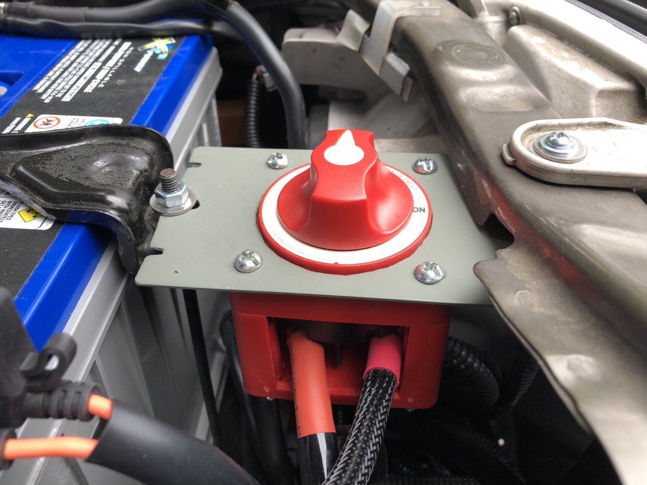

    There is a lot of debate on whether or not you should run a switch to your winch. The reason for me in particular, is that I didn't want a hot lead in the very front of my truck at the winch. In the case of a front end impact, the hot lead could potentially ground out and cause a fire. To me, adding a switch is cheap insurance to avoid this potential situation and save your beloved supreme taco from burning to ashes. Protect your investment!
    So, what about running a fuse?
    The particular switch I designed this bracket to fit is this Blue Sea m-Series 6006 switch. This switch has the following ratings:
    - 300A @ continuous
    - 500A @ 5 minutes
    - 900A @ 30 seconds
    *Please note that this switch has 3/8" studs. You may be required to enlarge the terminals on your existing 12V winch lead via 3/8" drill bit or step bit*

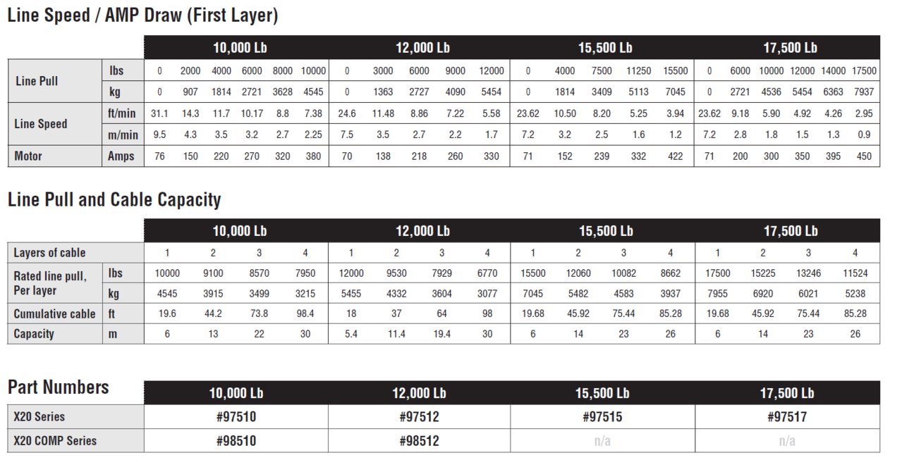

    Referencing the chart below for my particular winch(Smittybilt X2O), the max amp draw is at 380A at 10,000lbs. If I were to ever be in a scenario that requires that pull, I would have to have the winch constantly on for 5 minutes for there even to begin to be any issues. I mention this, to explain why I chose the switch I did.

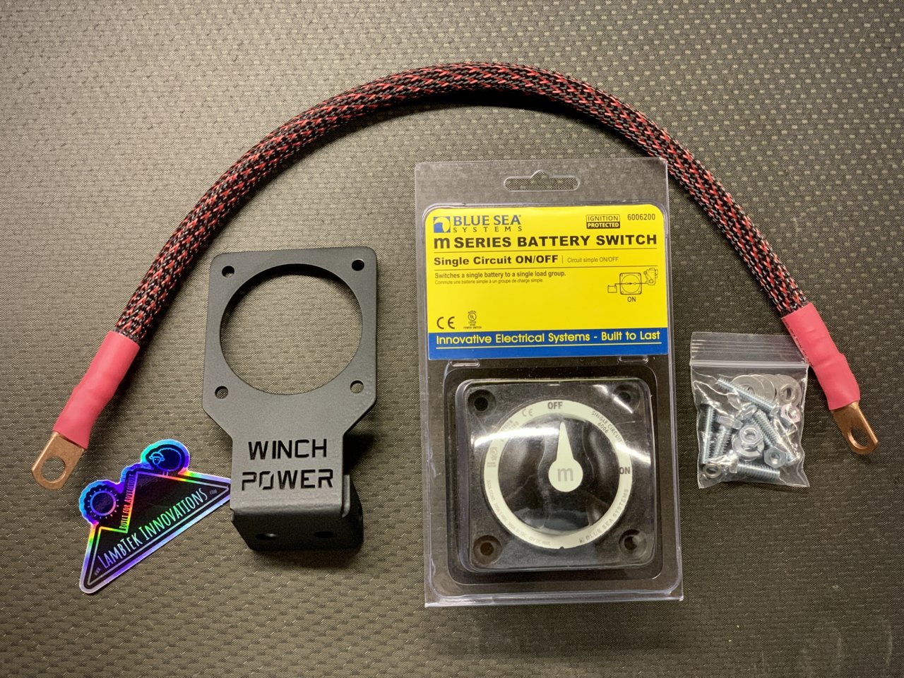

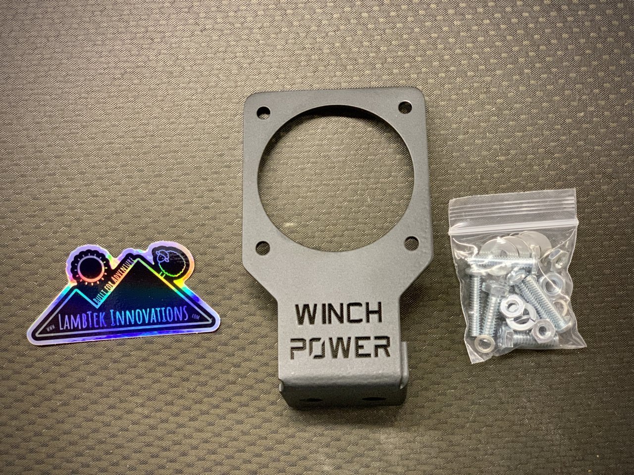

    Bracket Options and Pricing!
    To order, please visit www.lambtekinnovations.com
    Option 1: $145 shipped to Contiguous US - 6006 Blue Sea Switch, 6006 powder-coated bracket, required HW, and 2 gauge 12V lead
    Option 2: $115 shipped to Contiguous US - 6006 powder-coated bracket, required HW, and 2 gauge 12V lead
    Option 3: $95 shipped to Contiguous US - 6006 powder-coated bracket and required HW
    Option 1: $135 shipped - 6006 Blue Sea Switch, 6006 bracket, required HW, and 2 gauge 12V lead
    Option 2: $105 shipped - 6006 bracket, required HW, and 2 gauge 12V lead
    Option 3: $90 shipped - 6006 bracket and required HW
    Please let me know if y'all have any questions, comments or suggestions! Thank you all for your support thus far!

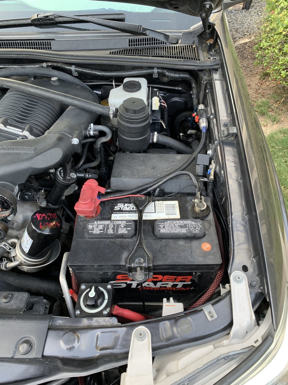

    Check out more photos of the bracket below!
    845EB7AA-179B-42E9-892F-3D91C8D22B86.jpg ECD1C558-763C-4308-A394-36427A4A5137.jpg 53CF8928-9FF0-4CB4-8A79-3EE4452F7F75.jpg

    Wouldn't fusing the (+) lead to the winch within 12"of the distribution point negate the potential fire hazard in a front end collision?
    I like the idea of a switch too, but it's no substitute for a fuse.

    Ideally with something that has a lower amperage draw, that would be the right idea. However, according to the chart below from Smittybilt, the 10k winch will draw right under 400 Amps at full load. Multiply this by 125% and it requires a 500 Amp fuse. These fuses are out there, but are expensive for a quality product and could potentially be unreliable. For me personally, I preferred a hard switch that would just completely cut power to the winch. Your thought is correct though! And there is absolutely no reason why someone couldn't run a fuse and a switch if they wanted, although I feel as if that may be a little bit redundant.
    Thanks for your input!
    The mileage on filter isn't necessary for me being that I keep a detailed maintenance log, but its quick and easy to peek at if Im unsure when I changed it last off the top of my head. I've put 12k miles on the truck since i got it in January :eek: Supercharger is a blast :cool:

    The idea behind the switch is to leave it open unless you're about to use it right? As you're driving around town the switch would be open so that you wouldn't need a fuse?

    That is correct. I leave the switch 'OFF' but when I know I am going to do some heavy off-roading for a day, I'll switch it on. If you need to use the winch unexpectedly, just pop the hood and switch it 'ON' and you're ready to go.

    Updated original post with additional photos!
    B35D64A7-C512-4FEA-90D4-CF1678B037A2.jpg 374DDEEC-825E-45C4-B500-E4C45E023BBB.jpg F36C27B1-B504-4923-AC2A-F0EFBD2F69E6.jpg 114E392F-0538-468F-A5D8-C0AA7557B251.jpg

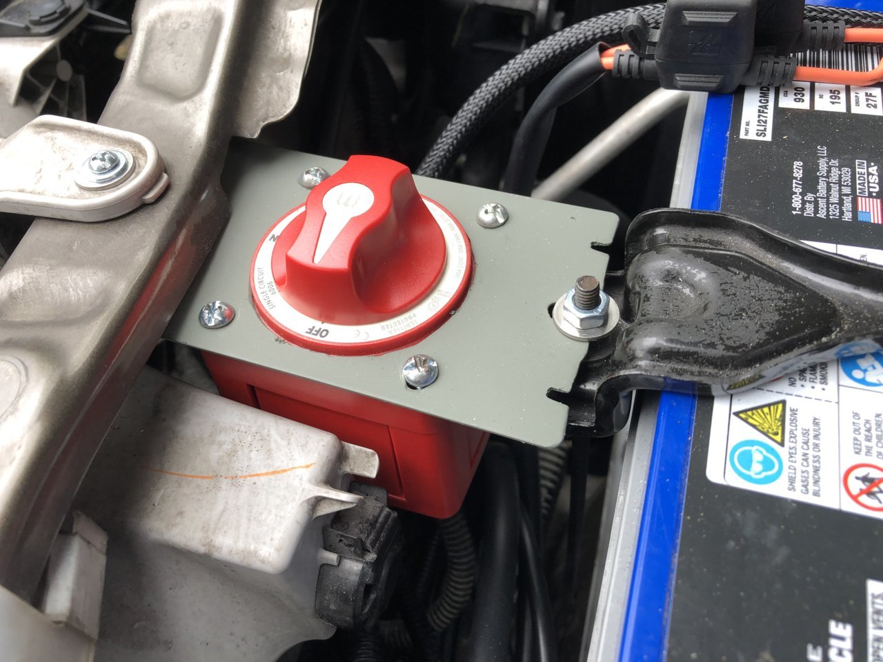

    Fancy bracket:hattip:I like that it's self-supported.

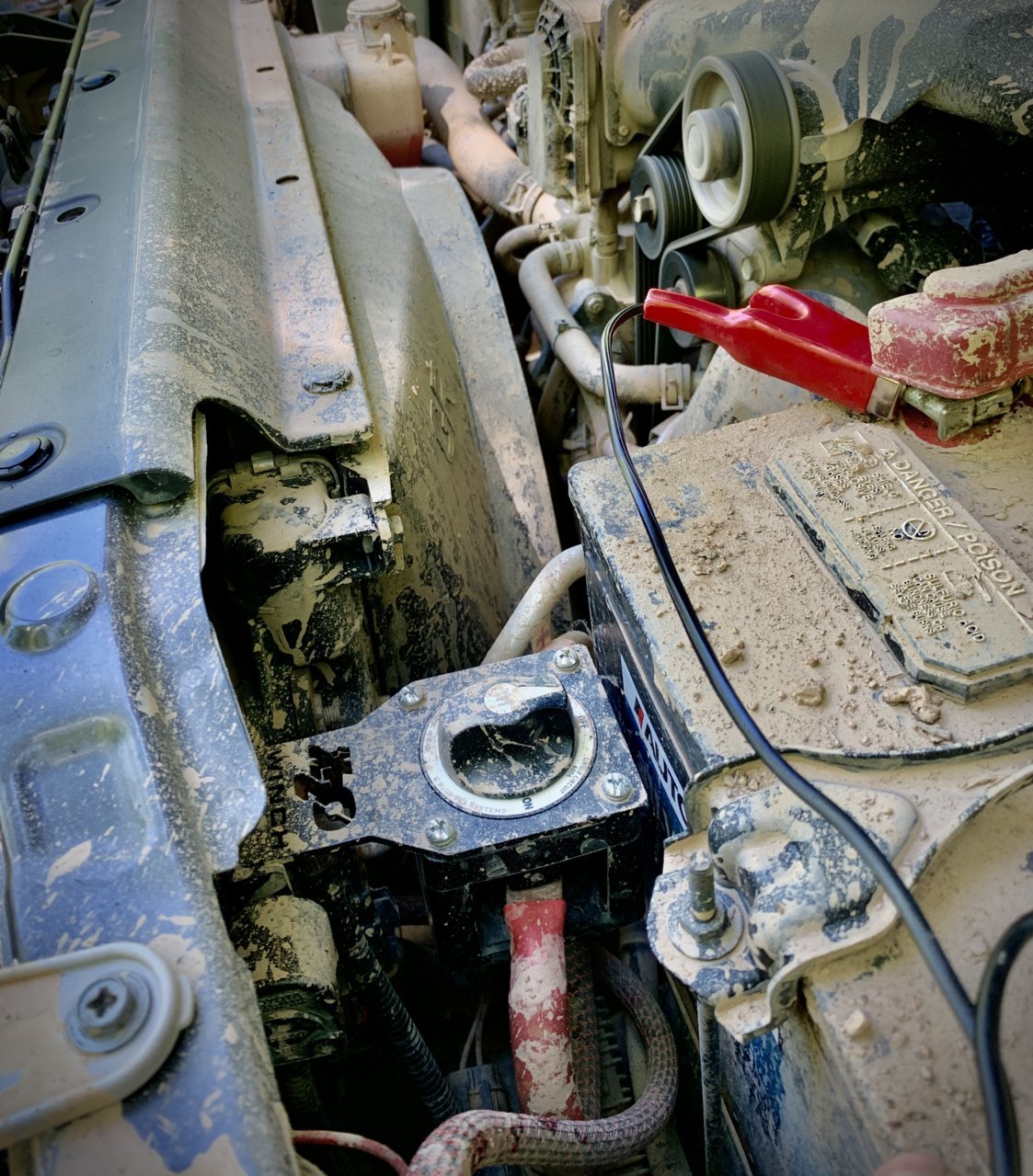

    Here is my example. Just a piece of steel that took many hours to create...
    Good luck with the idea. I personally think the safety of having the main power cut to the winch is critical.
