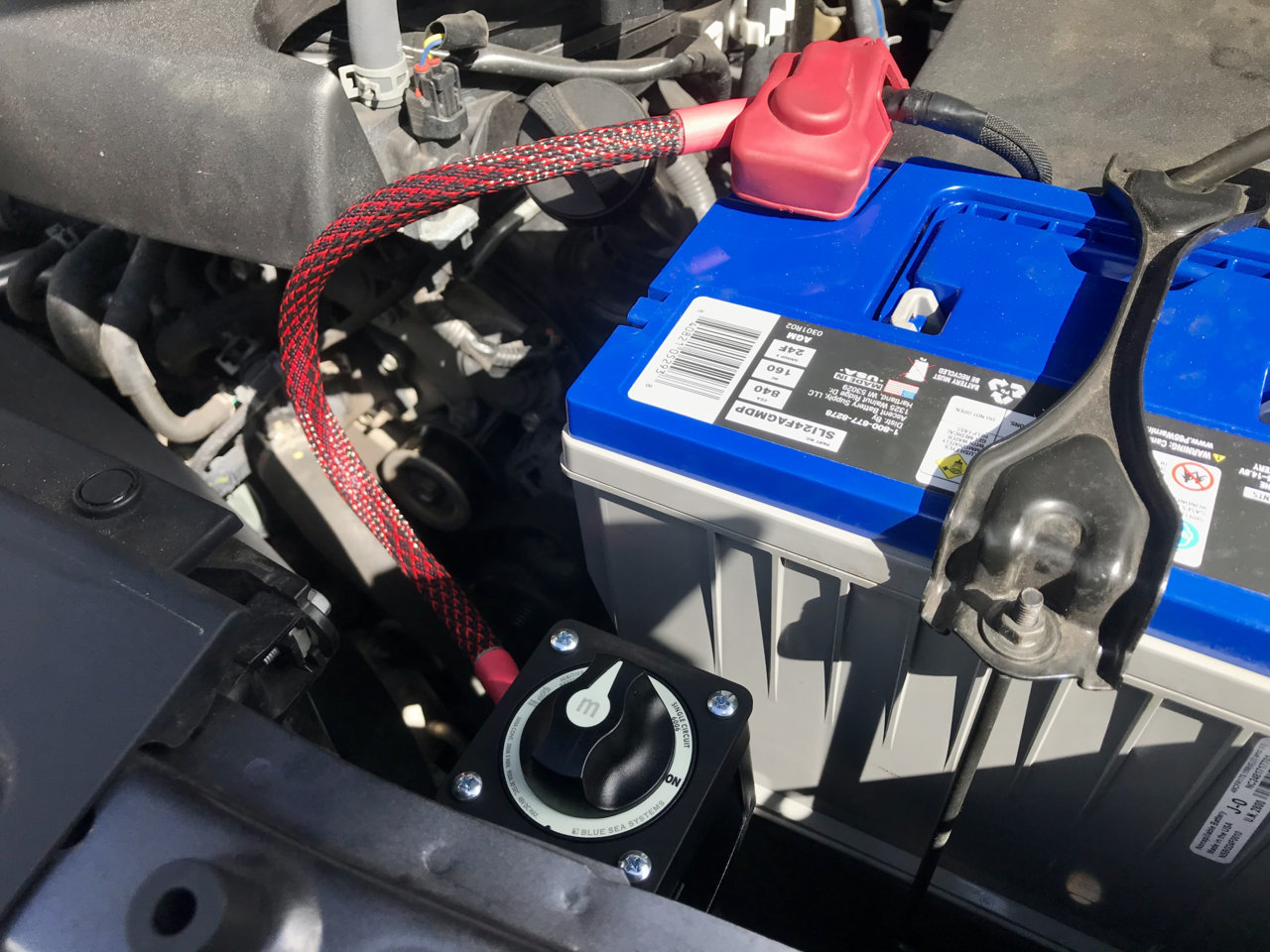

    Done and done. Thanks Chris! Worked out perfectly.

    Looks great Sang! Thanks for the photo!:cool:

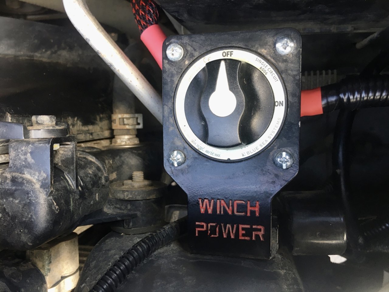

    Threw this on today. Takes about 20 minutes and worth every penny. Very clean install once in.

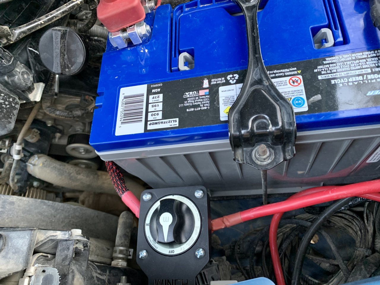

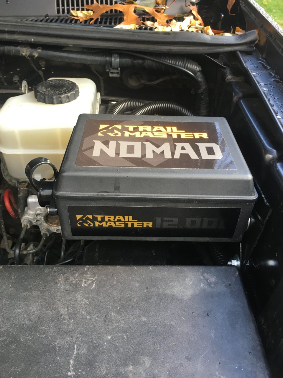

    Finally finished the install. I was dragging my feet on mounting the control box in the engine bay, since it wouldn’t fit on the mounting location on the winch itself. That involved making and installing new, longer leads from the control box to the winch, and making a bracket to mount the box. Although it wasn't overly difficult, it has been a challenge balancing free time being a new dad.

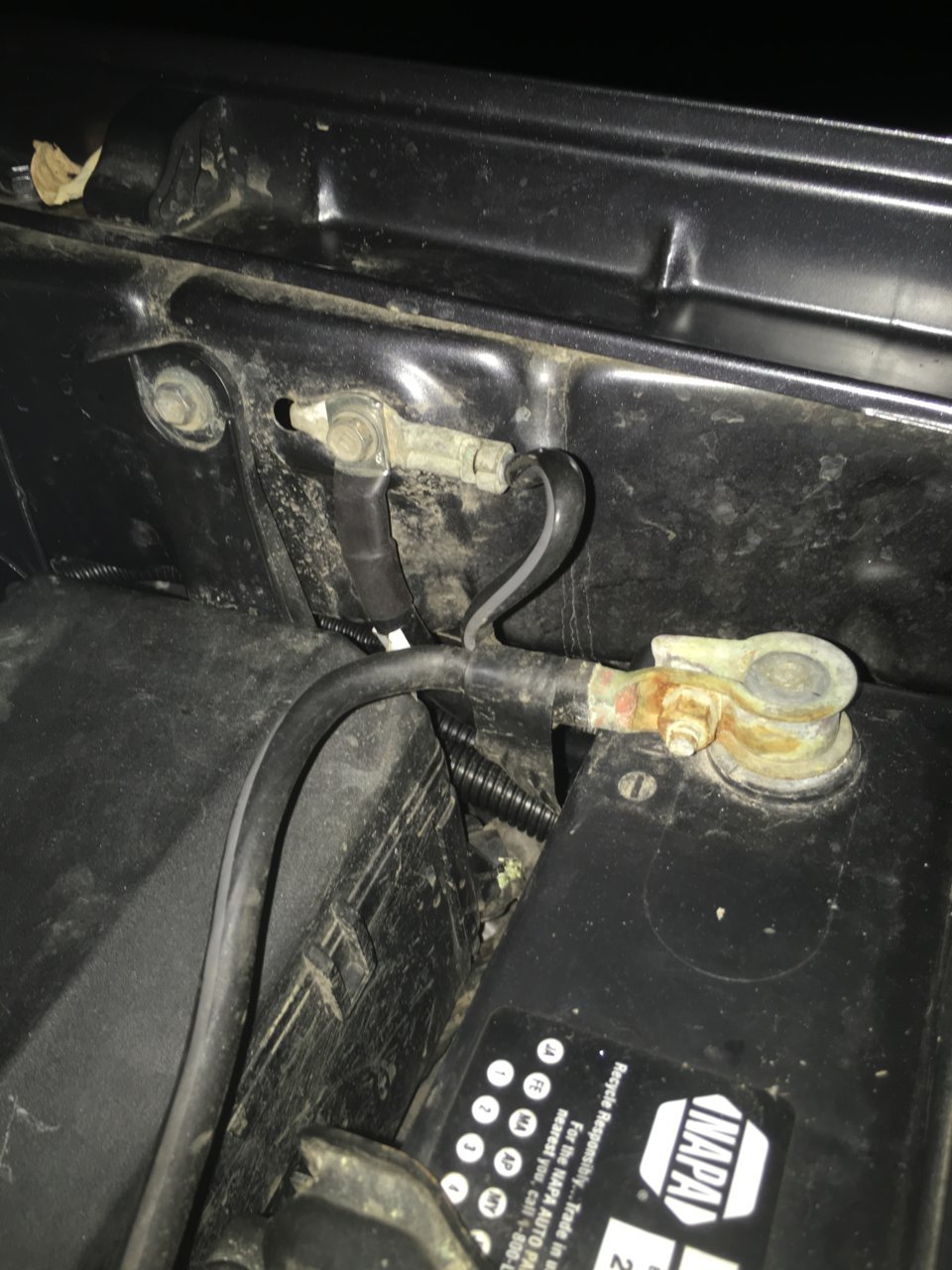

    Good looking install, but how are you doing the ground wire from winch? Most people run that back to the negative battery terminal so surprised not to see it in your photos

    Kind of a crappy photo, best I can do with it being dark. I pulled the bolt from the ground wire to the body and connected at that point.

    Thanks for the feedback man, looks awesome!
    Yes sir, you got it! The switch is ran inline the winches 12V+ cable.
    That beeper is a pain isnt it :rofl:
    It all looks great! Love the location of the control box! That is unless you were planning on adding an accessory panel with a fuse block on it down the road, thats generally where I've seen those mounted
    Same way I have my ground ran as well, haven't had a single issue with mine at all!

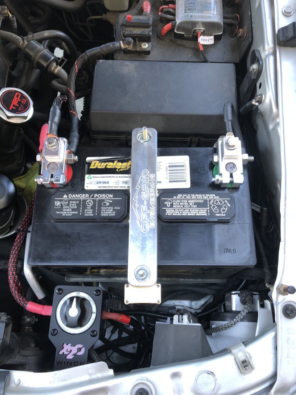

    Thanks for everything Chris, a one beer job!

    Looks killer Casey!!
    As a slight optional installation note to clean up the power wire, there is actually just enough room and length for the wire to come through the original battery boot to allow for a cleaner install!
