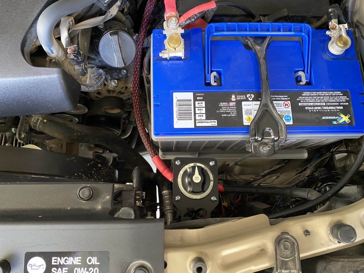

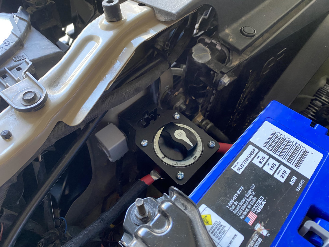

    Pretty happy with this bracket! Very slick solution.
    Couple of notes from the install:
    1) Ended up installing a new ring terminal on the cable that came from the winch since it didn't fit over the stud on the switch. The X2O cable is a 4 awg with a 5/16 ring terminal, the switch accepts a 3/8" ring terminal.
    2) I needed to trim the vertical height of the beeper to fit on the switch bracket.

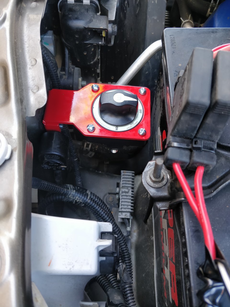

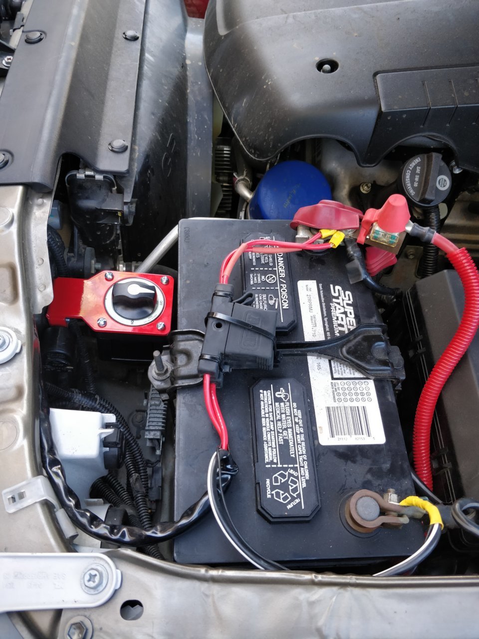

    Looking very sexy in "Red Baron"

    In regards to note 2, you are referring to the opening for the beeper on the bracket itself, and not the actual beeper, correct?
    Looks great brother, thanks for the photos!!

    I just trimmed the mounting tab on the beeper to get it to fit. Figured trimming plastic is easier than trimming aluminum.

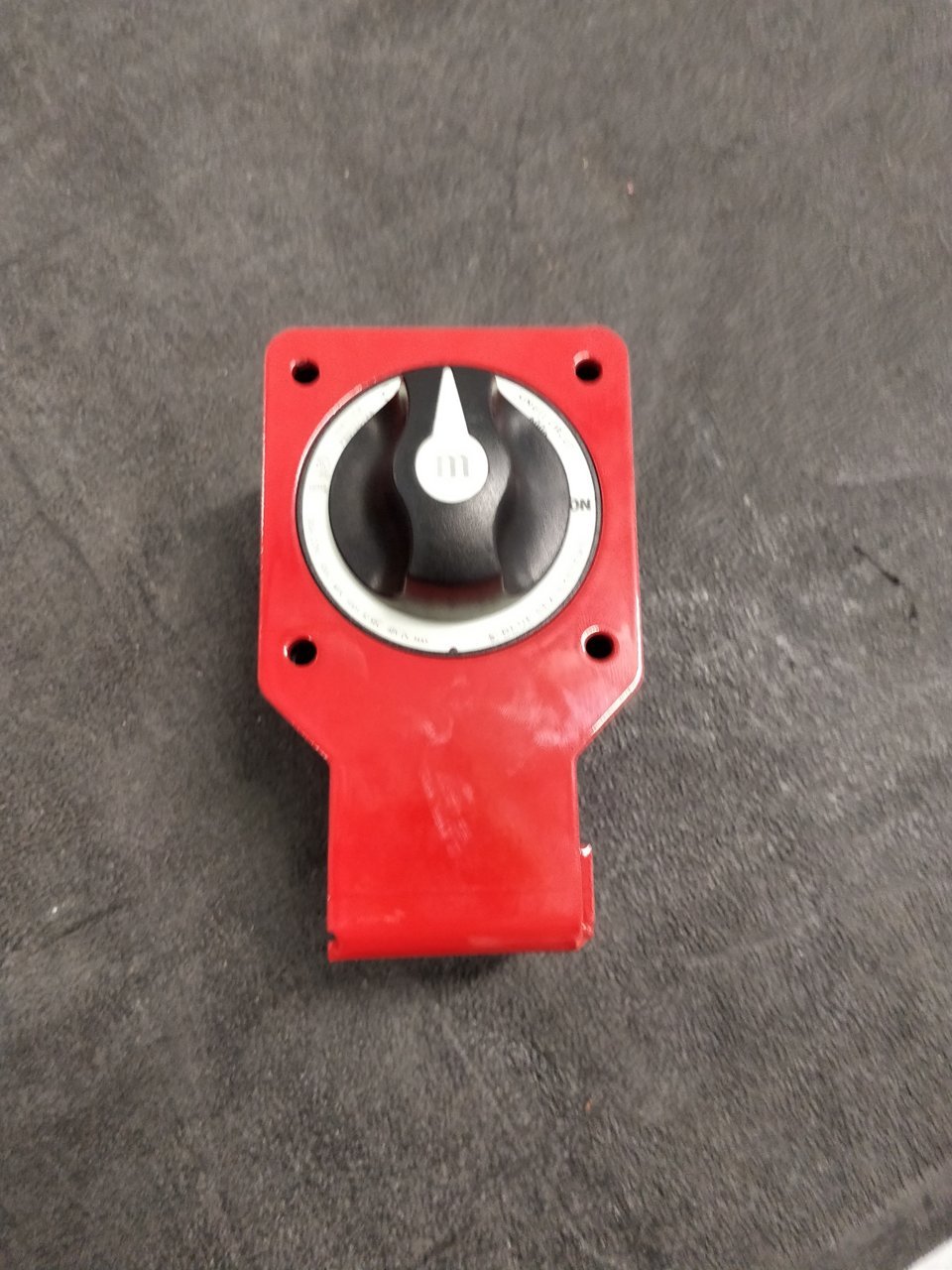

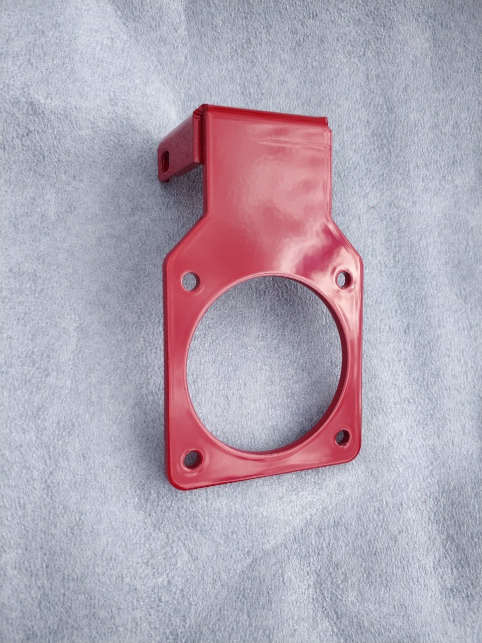

    Got the bracket mounted up today, no wiring as there's no winch bumper yet but it looks cool so I'm doing it. I also had to trim the beeper to get it to fit, I'm guessing since it's made to attach to the tissue paper that is the front support it doesn't like the thicker bracket. Pro tip, test fit and trim it before you mount the bracket or you will look like you tried to pet an angry kitty.IMG_20200426_143126.jpg IMG_20200426_143331.jpg

    Man that looks awesome! Digging the red!
    In regards to the beeper fitment, do you think the powdercoat could have affected it? I designed the bracket to have a pocket milled out where the beeper slot is so that the thickness of where the beeper attaches to is the same thickness as the original mounting point for it.

    I had no issues reinstalling the beeper on a 2019. After looking at some photos, it looks like the 3rd gen beeper is different than older models; maybe that might be the issue?

    Externally it is, but the clipping portion is identical for both, I tested both the 2nd and 3rd gen with no issues as well. After some feedback however, I believe the clip on the 3rd gens is just a smidgen taller which may lead to a tighter fit, but I’ve changed the design so the slot is .050” taller in height overall to mitigate that potential issue.
