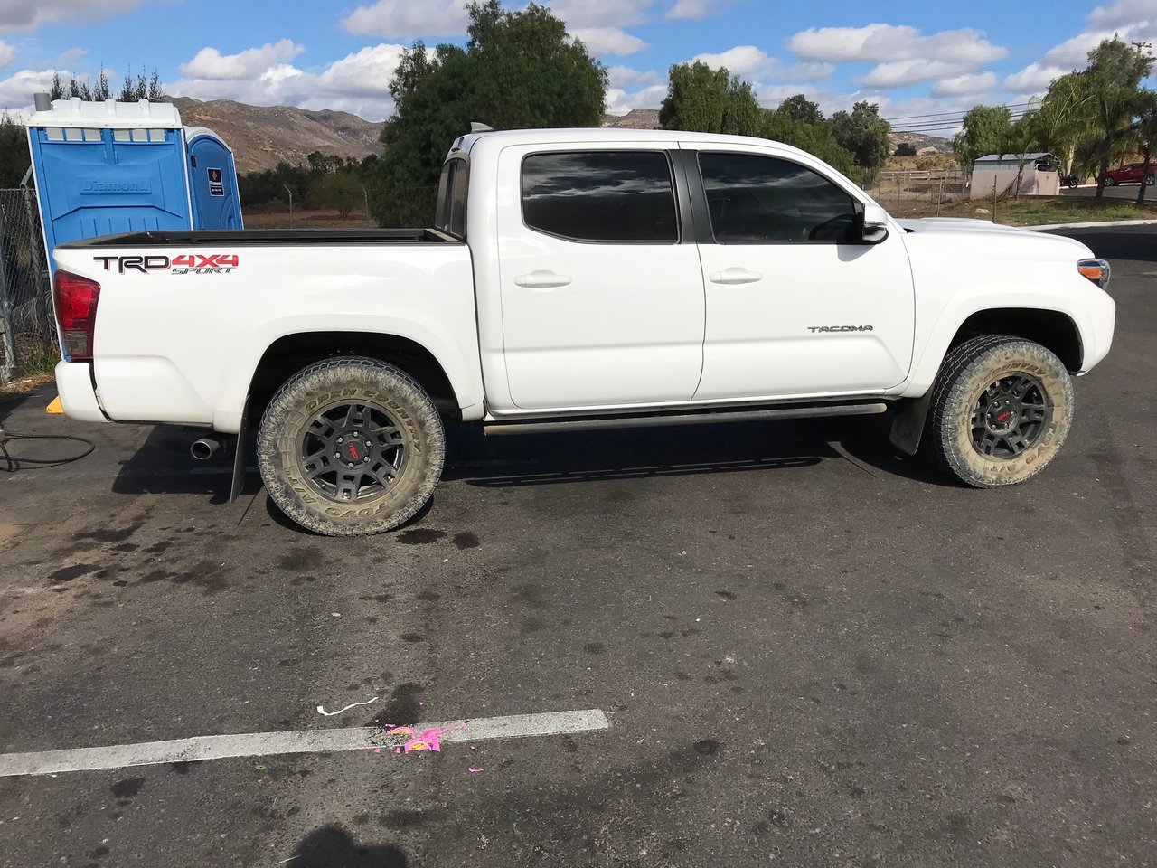

    Here is what my truck looks like with 265/70/R17 tires with 5100's set on the first notch and OME 2887. Stock in the rear. No rub at all and took it off-roading so I had it at full articulation. Not sure how much bigger you can go with the tires but I did rub at in the front at stock height, I also have steel skids and frame sliders that might have contributed to my rub.

    People tend to focus way to much on a lift for clearing larger tires, but you also have to consider the wheel offset etc. There's no "one answer" as there are a lot of factors to consider. That being said, with 285's you'll most likely have to do the CMC
