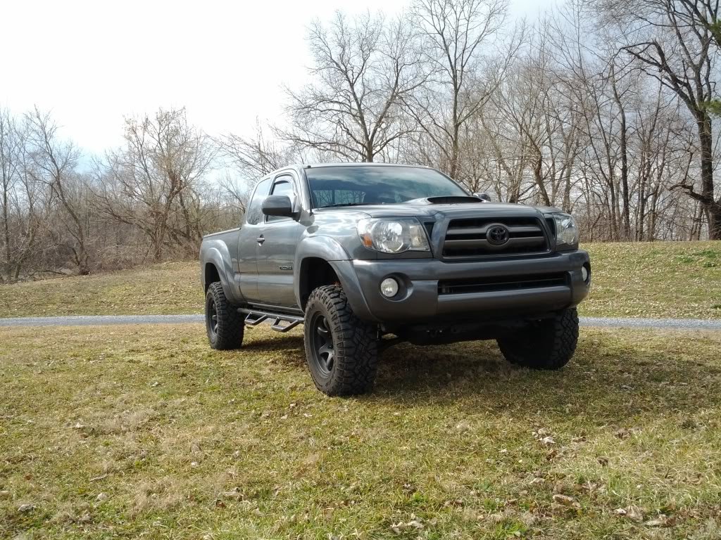

    If you want to keep your stock wheels and not install wheel spacers, then 265/75R16 will be the largest tire size for you. If you go any wider on the stock wheels you'll likely rub on the upper control arm.
    Here's an example of 1.75" - 2" lift that we did with 265/75R16 on 16x8" 0mm offset Konig Countersteer Offroads:
    ^We did not trim anything on this truck, and there was no rubbing. The tires are Goodyear Duratracs - LT265/75R16 Load Rating C.

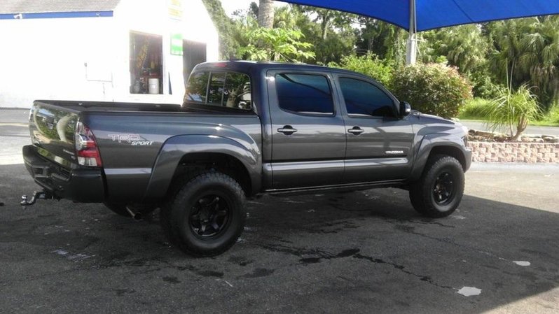

    I have Nitto Terra Grapplers in 265/75/16's on Konig Countersteers with no lift and the mudflaps removed from in front of and behind the front wheels on my 2012 TRD Sport!!! It doesn't rub at all!!!
    Here is a pic of what it looks like. I have the rear mud flaps removed too, but that is just personal preference not because of the tires!!
