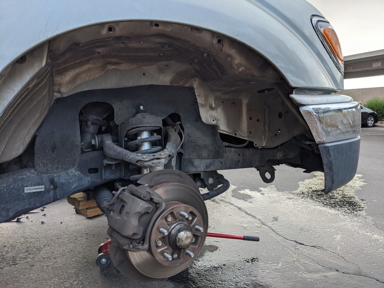

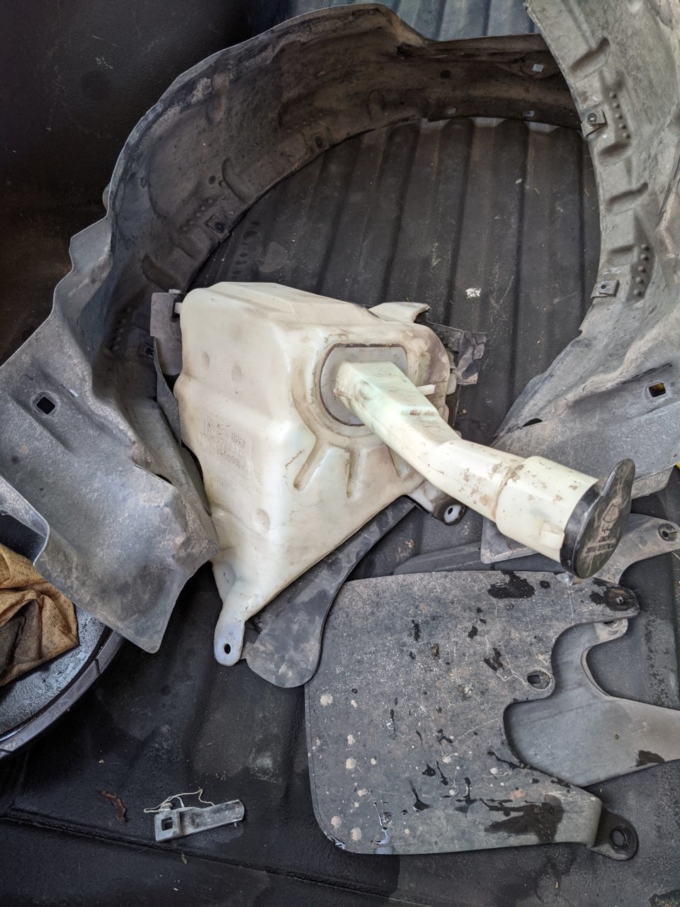

    Pulling some things to fit 31x10.50s stock on my 5 lug, from 235s
    Going to use jeep wheels on the new set. Cutting of fenders/ bashing of the wheel well to come for fitment

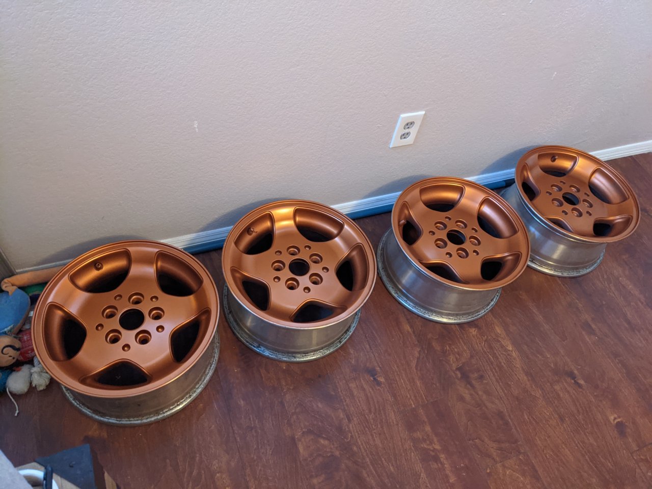

    235/85/16 measures out to be about the same as that guy was running on his build, but not as wide. ( 31.6x 9.50 versus 31.6x 10.50) I was looking into those instead of the 31x10.50, but could not find a set of cheap 16s on CL or offerup, the jeep wheels came up for 50 and i jumped on them. Think our bore is 67.1 iirc
    my wheels are flush with stock steelies and 235/75/15, or 28.9x9.50

    Crap, so a 3.5 bore is a no go? I thought wheels that fit Cherokees were supposed to fit these little taco's?
    This guy selling the wheels says it is a 3.5 bore and that they were on his Cherokee. The internet seems to be telling me Cherokees from '93 to 2020 are 71.5?
    Maybe he means the lugs are 3.5? would that make any sense?
