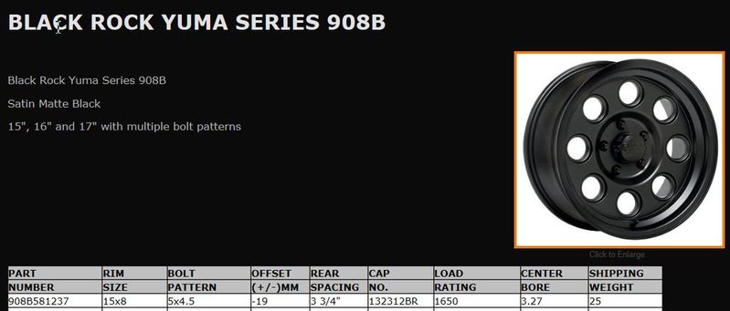

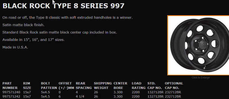

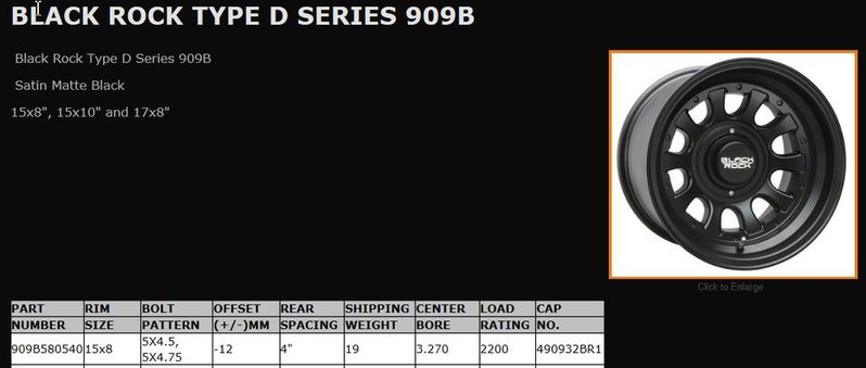

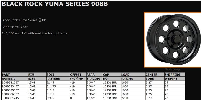

    Hi all,
    Can some folks help me evaluate whether these wheels would fit on my 2015 2wd access cab base model?
    I will post more tech info and specs about the wheel when I get to work but I wanted to get these up there since I can't post photos from work...
    http://www.blackrockwheels.com/

    Here is what I see on Tire Rack for recommendations. Unfortunately all their recs are more car oriented so hoping I can find more options.
    -Bolt Pattern: 5-114
    -Hub centric
    -5x4.5
    -Offset 35-45
    -Backspacing 5.5 to 6
    -Center bore 3.27
