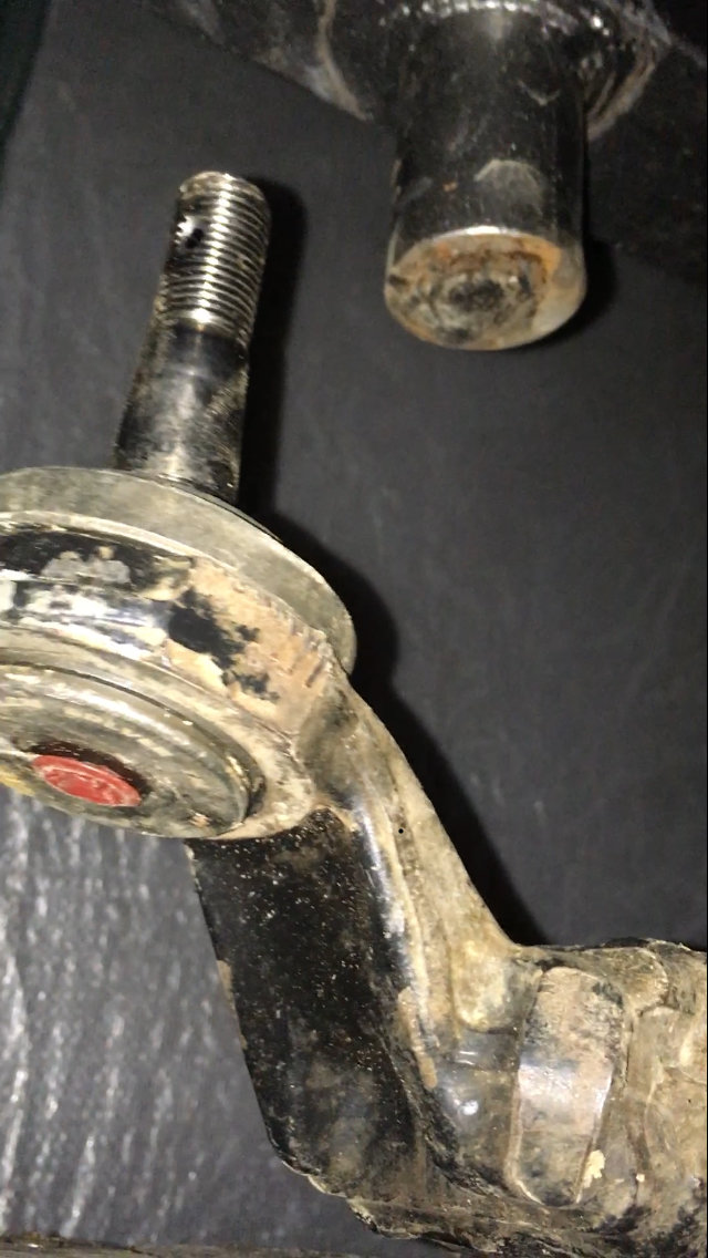

    I’m getting new tires installed and a professional alignment done on my 2nd gen taco in 2 days. I figured that would be sufficient time to replace the lower balljoints and outer tie rods on my truck... and it should have been (I purchased a 20-ton shop press yesterday for this installation).
    Long story short, today I accidentally installed my passenger LBJ Upside-Down... :anonymous:
    How do I get the bugger out?? If I have to smash it out, is the LCA salvageable? Is there any way the balljoint is salvageable? Thanks in advance for speedy replies, I have to somehow go and pick up my tires if I can’t make this appointment with the tire shop...

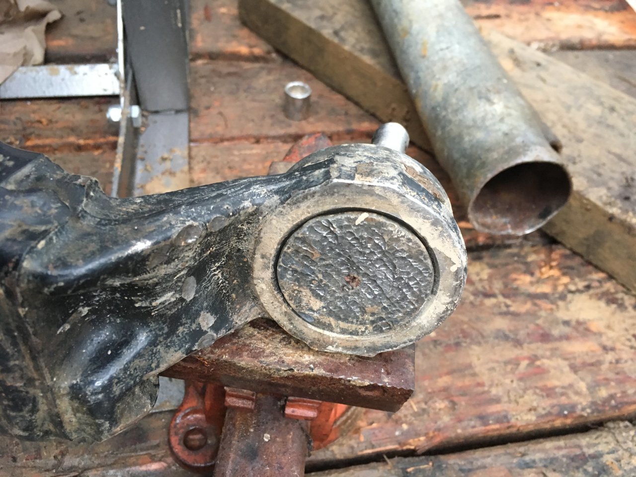

    Thank you this answers one question flawlessly, however, regarding:
    In a perfect world that would work, in my current world of hell the joint is actually pressed in from the stud side. In order for the LBJ to come out it would need to be pressed from the back, where you can see the red cover for the zerk fitting.
    This would be an easy task if there were overhang on the stud side, but it’s pressed flush. You can see the toothmarks on the stud side where I had tried to use a vise to back the LCA for pressing - but it was just a sliver of metal on each side and the vice easily slipped off... i may try heating the LCA with a torch and drilling through the joint then smashing it out, but I don’t want to bend it...
    Do you see what I mean when I say theres nothing to press against? I have a piece of pipe that fits snug around the joint, but theres no flat surface on the wrong side of the LCA to keep the press from sliding. It can’t apply pressure because on one side (left side in picture <tire side>) theres no overhang at all.
    Even when it comes to bashing it out, there’s no way to brace the arm so that I’ll be smashing the joint straight out (If I were to attempt to hit the joint out, it would be zerk-side up, stud side down)...

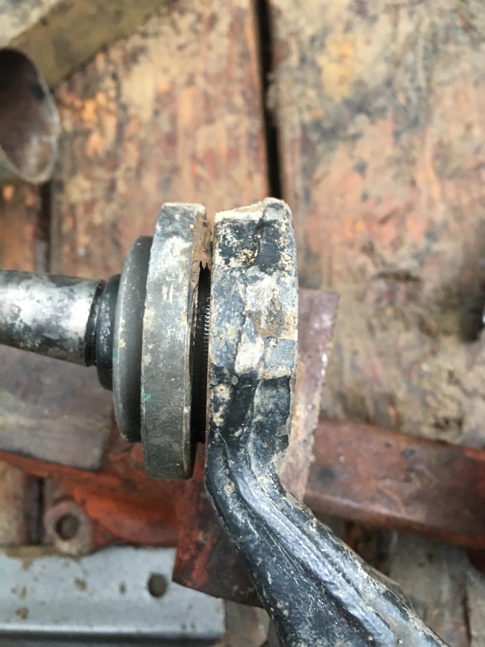

    You might try a "bearing separator". It has two halves with a tapered edge that thread together to split bearings from whatever they are resting against. So in this case maybe it will have enough force to split the ball joint from the lca and get it moving/lifting. Maybe see if the local auto parts store has one they can loan. Heat the lca with a torch to expand it as much as possible, then try to get the two halves of the separator between the lca and the lip on the ball joint and start to pull it up and out. Once it's started it should start to move easier and then maybe a BFH will get it the rest of the way? Other than that I'd try to very carefully cut it out with hacksaw, angle grinder with cut of disc, and dremel.

    I have a small welder but have almost no experience with it... looks like I will be using the BFH method for sure, maybe imitating the function of a bearing puller using two wide-tip chisels. If I can get a big enough gap between the joint and the arm to fit a saw blade, from there I will cut them apart and press out the rest.

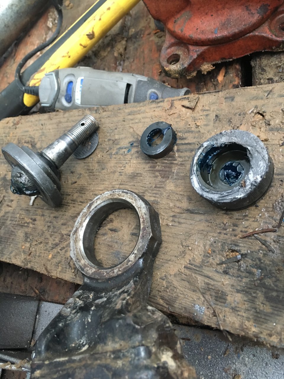

    Thank you so much to everyone who chimed in, you got the gears in my head turning when they would not budge thinking about step 1.
    I did it!!
    Dremel with 1” cutoff wheel, hacksaw, cutting fluid, BFM, solid steel chisel, 8” bench vice, 20-ton shop press, and now I’m left with a 50$ trophy to remind me to double check anything and everything!!!

    Nice work!! Looks like the LCA survived the whole process really well too.
