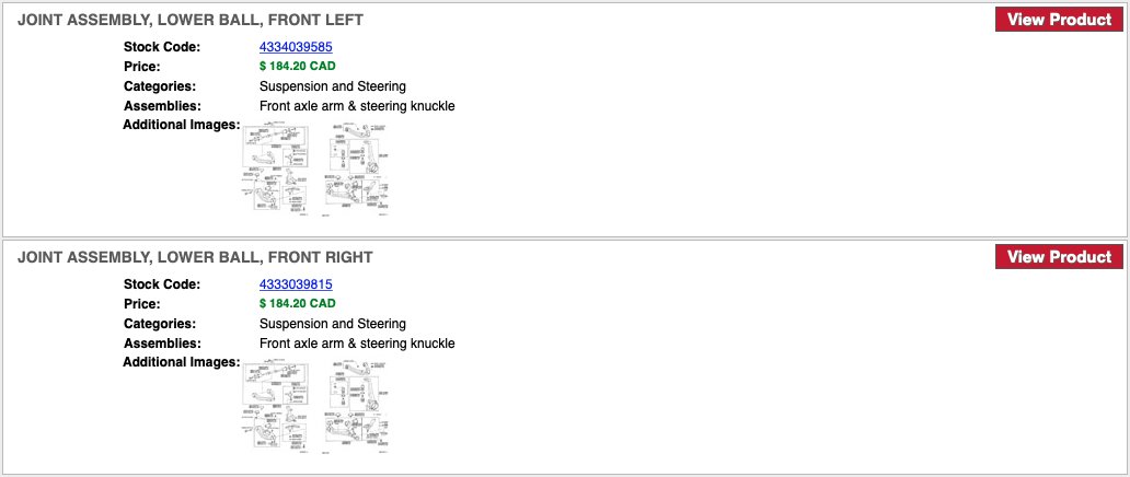

    This is what I got when I put your truck's info into Toyotapartsdirect.ca and searched lower ball joint.

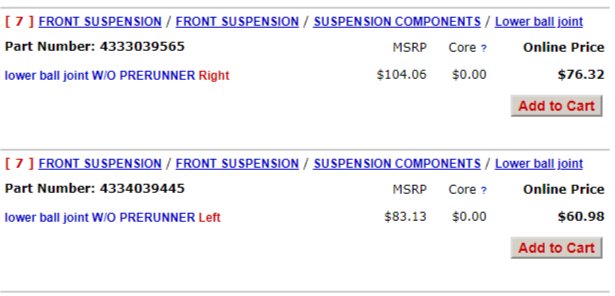

    The ones you have listed at the bottom are for a 5 lug.

    The ones in the image I attached of the Camelback parts?
    Those are the same numbers as what @Taco-Bell posted which he claims to be the 6 lug ones I need.

    The one from your dealership are the correct number, the Camelback ones are for a 5 lug like @01GreenTacoma said (I believe).

    Yea your right. I didn't think to search the part numbers he provided me with online. They come up as the prerunner 5 lug ball joints.

    You want the ones for a pre-runner/4wd. They are the same ball joint. The 5 lug is completely different.

    Pre-runner is same as 4wd minus the transfer case, differential, cv’s. All other pre-runner suspension is the same. Both are 6 lug.
    The 5 lug completely different from the other two aforementioned styles
