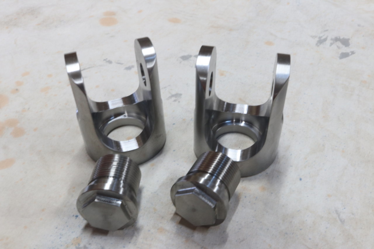

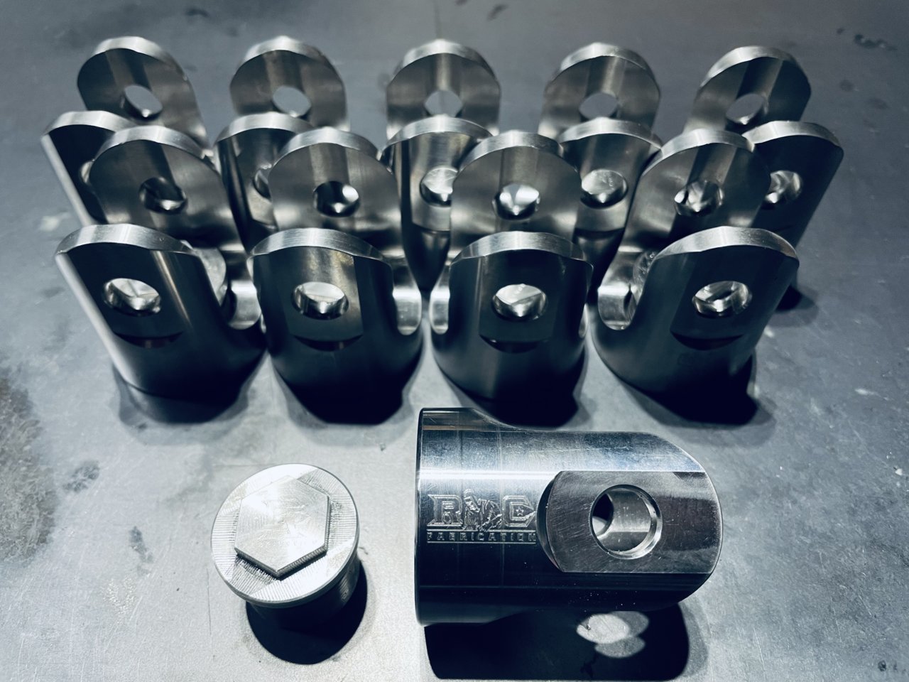

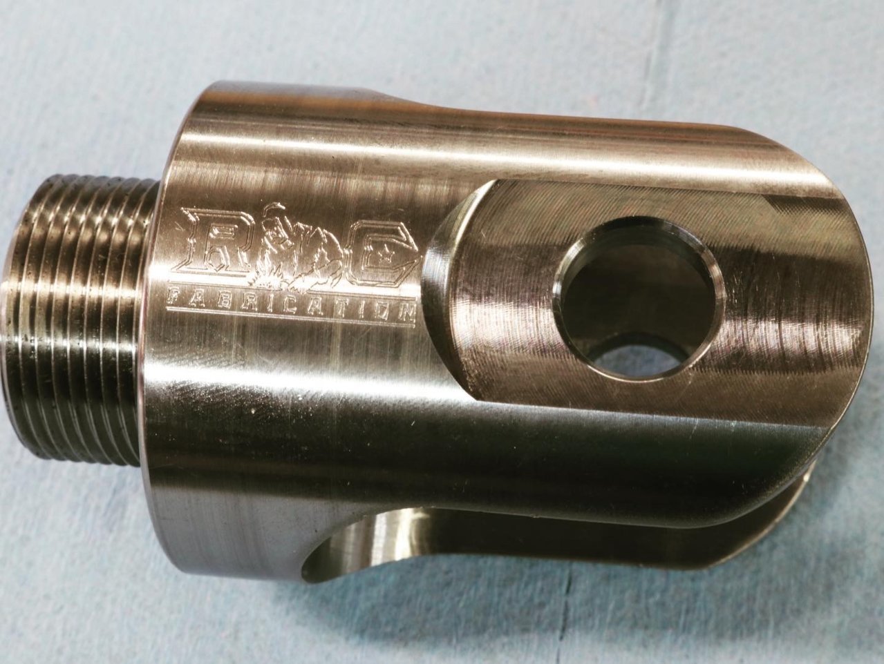

    I've made several of these for guys running a LC200 rack in their RCLT Kits. Now that running a LC200 rack is growing in popularity, especially among FJs and 4Runners, I've been getting requests for more and more.
    First batch made:

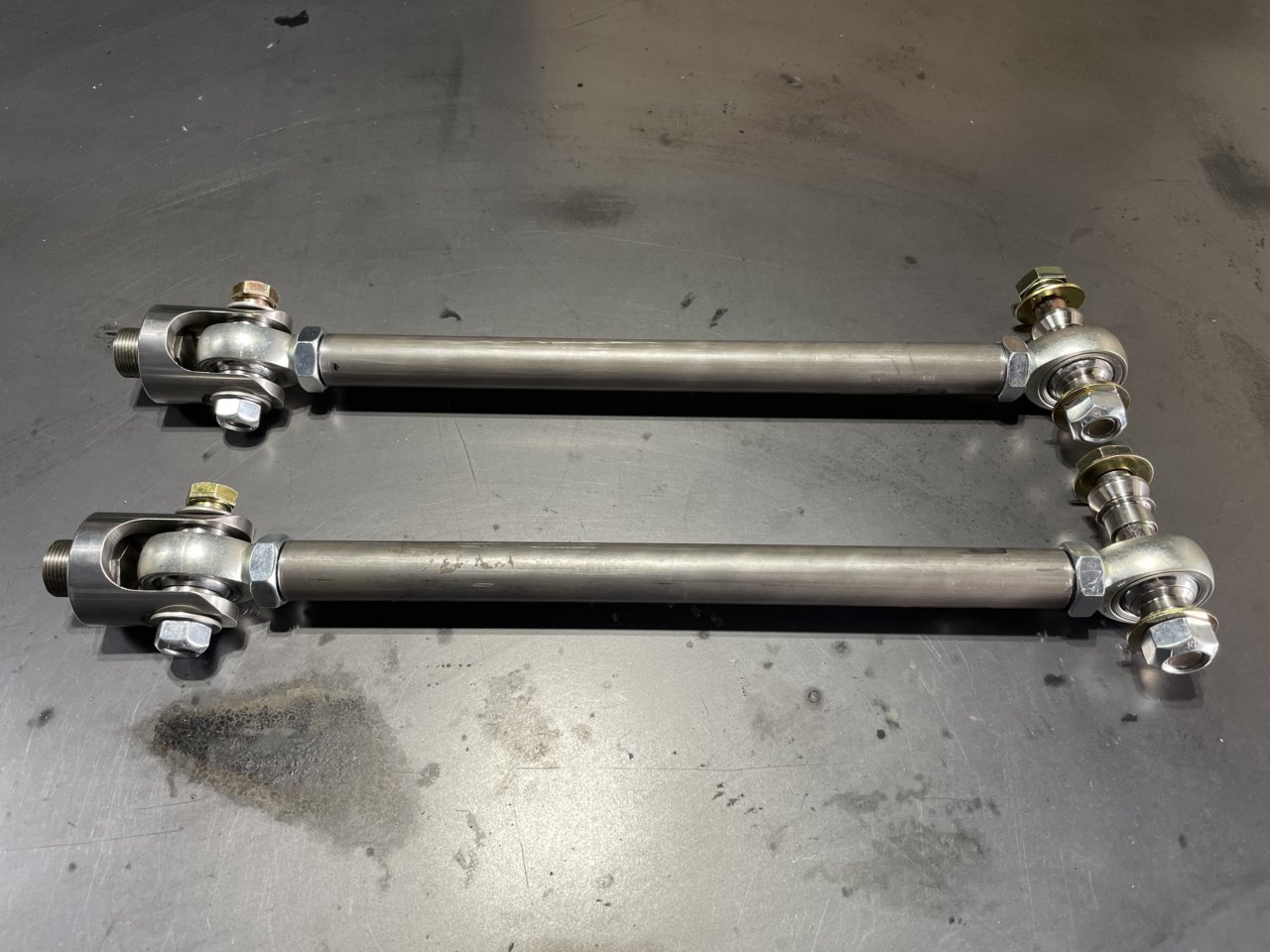

    Depending on what kit you have, I've been getting feedback that the stock inner tierods will bottom out. With the clevis, this is eliminated.
    Once you have the clevis, you can then run a chromoly rod from inner heim to outer heim.

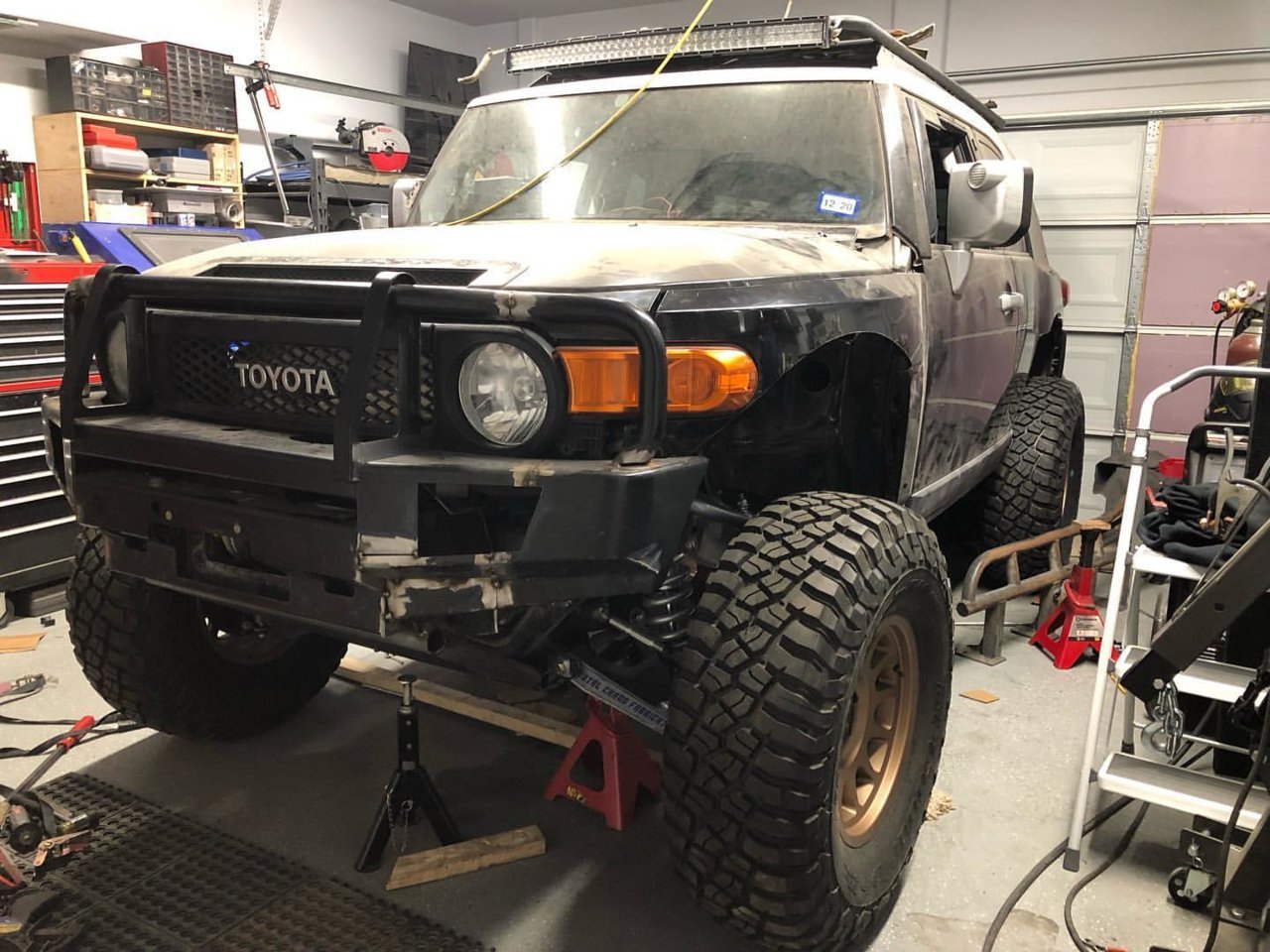

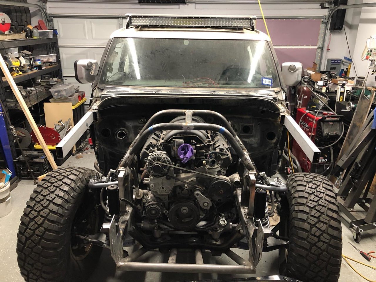

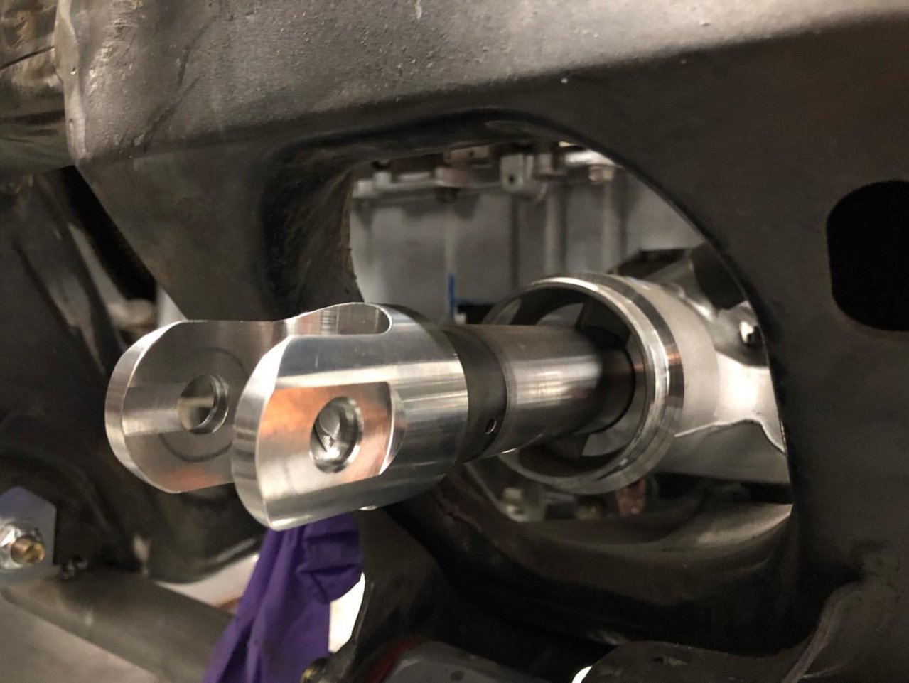

    Here is an FJ running a LC200 rack with my steering clevis'.
    263862434_320123463292338_2566726780112320262_n.jpg 266196599_1060362411427982_3924681438681109411_n.jpg
    Yeah, it also has a LT swap in it!

    Very cool, price? What is being done for boots? Have any feedback on running the LC rack with stock length arms?
  4. Dec 16, 2021 at 8:51 AM
    m00seNUckLEz
    m00seNUckLEz [OP] tAc0 aFiCi0nAd0
    Dec 20, 2015
    #172698
    824
    Fresno, CA
    Under Construction
    So right now I’ll be honest, they are a tad spendy. Currently selling for $350. What I’m doing is buying Tacoma Clevis’, then modifying them (making a new bolt / opening the bore) and making all the sizes that the big companies are not.
    For boots, I just bought new OEM boots and used them. I have inner clevis’ and chromoly rods on my personal truck as well.
    So far, no feedback on stock length arms. Everyone that has reached out to me has a LT kit on their truck.
