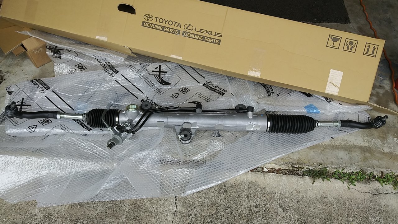

    Becoming a fan of McGeorge Toyota. Have had several good experiences with them. Ordered Saturday Morning at a pretty good discount, received this Morning-5 days total.

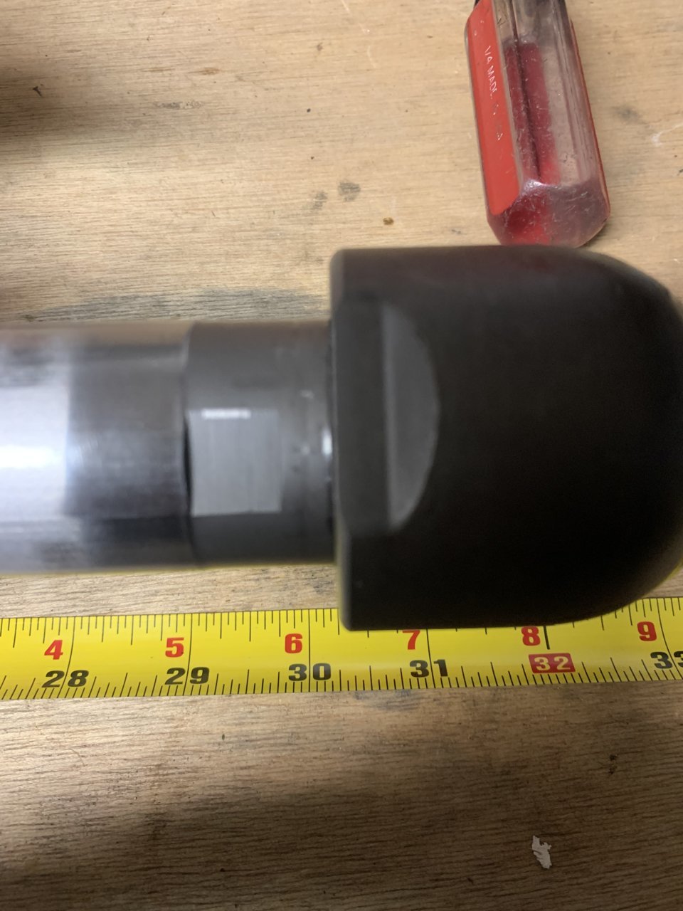

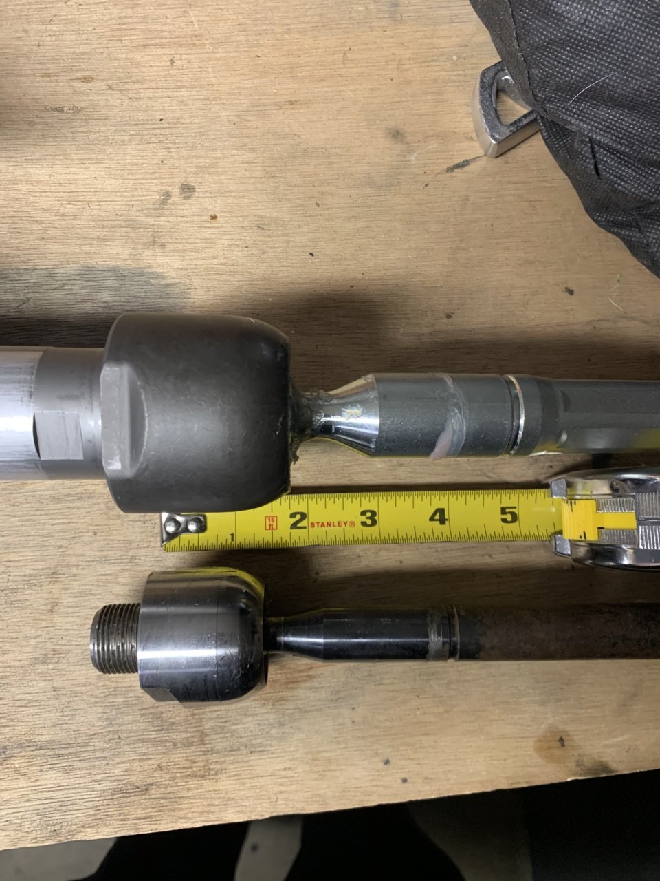

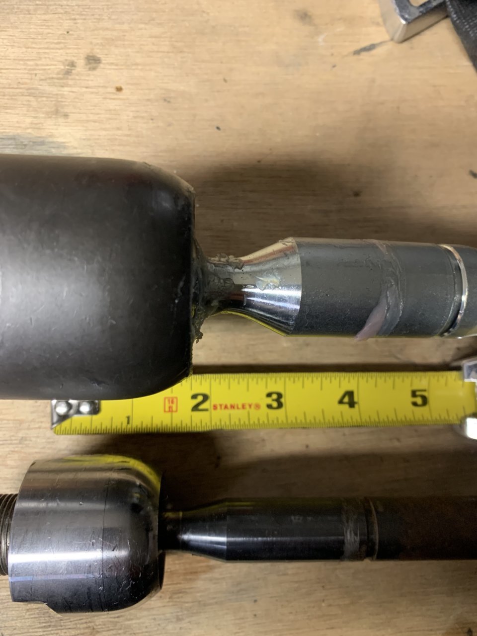

    I got mine today as well, I came up with 30.25" TRE mount-TRE mount, and 33.75" from the outer edge of the TRE, which is likely more important as the ball joint is way thicker than a 4Runner one, 1-3/4" vs 1-3/8". Also 3-1/8 turns lock to lock.
    Updated stats:
    LC200:
    • Stroke: 6.22"
    • Length between ITREs: 30.25
    • Turns lock to lock: 3.125
    Tundra:
    • Stroke: 7.81"
    • Turns lock to lock: 3.69
    • Length: 31.5"
    4th Gen 4Runner:
    • Stroke: 6.25"
    • Length: 28.5"
    • Turns: 3.06
    2nd Gen Tacoma:
    • Stroke: 6.7"
    • Turns: 3.63
    • Length: 28.5
    FJ:
    • Stroke: 5.67"
    • Turns: 2.81
    • Length?

    Interesting. Seems the LC200 rack still needs to be chopped down 1.75" (similar to the Tundra rack) to make it match the width of the Taco/4runner racks. Bummer, I thought it would be closer in dimension.

    Just curious, what are the thread diameters on both the 4runner/Taco inner TRE and LC200? Maybe the LC200 thread could be machined down to 4runner/Taco thread diameter/pitch? Then the weak point would for sure be the rack. Hmmm

    @DocME posted 28mm for the LC in the FJ thread, pretty sure the 4R/taco are 22mm.

    That's what @Basikbiker does with the tundras, so you can run the 4R/taco ITRE on the tundra rack.
