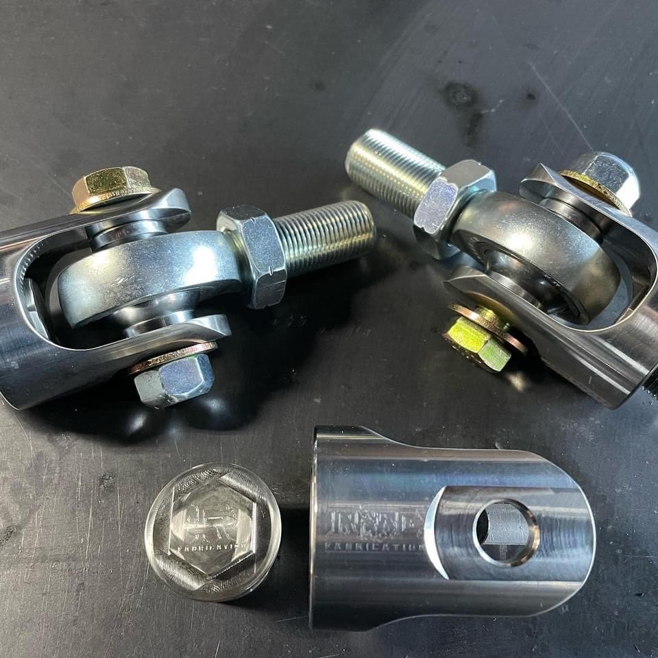

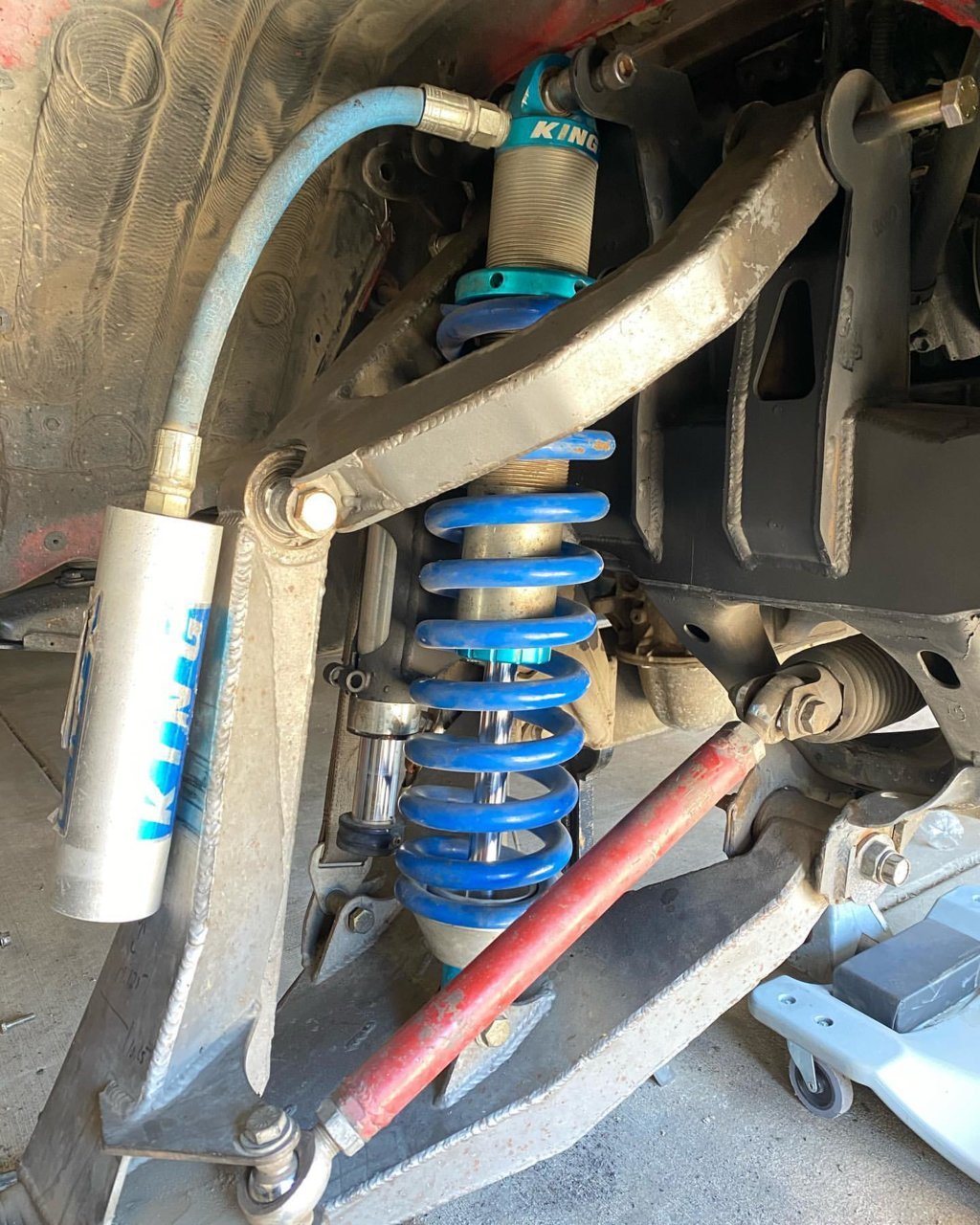

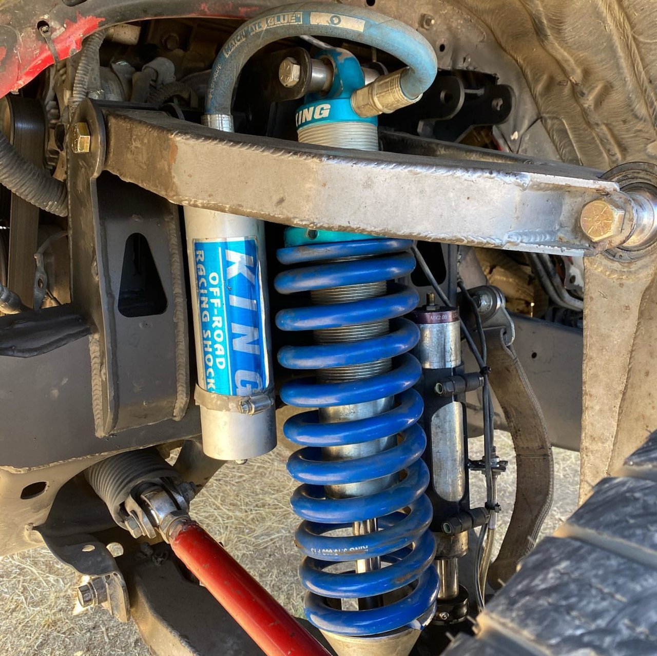

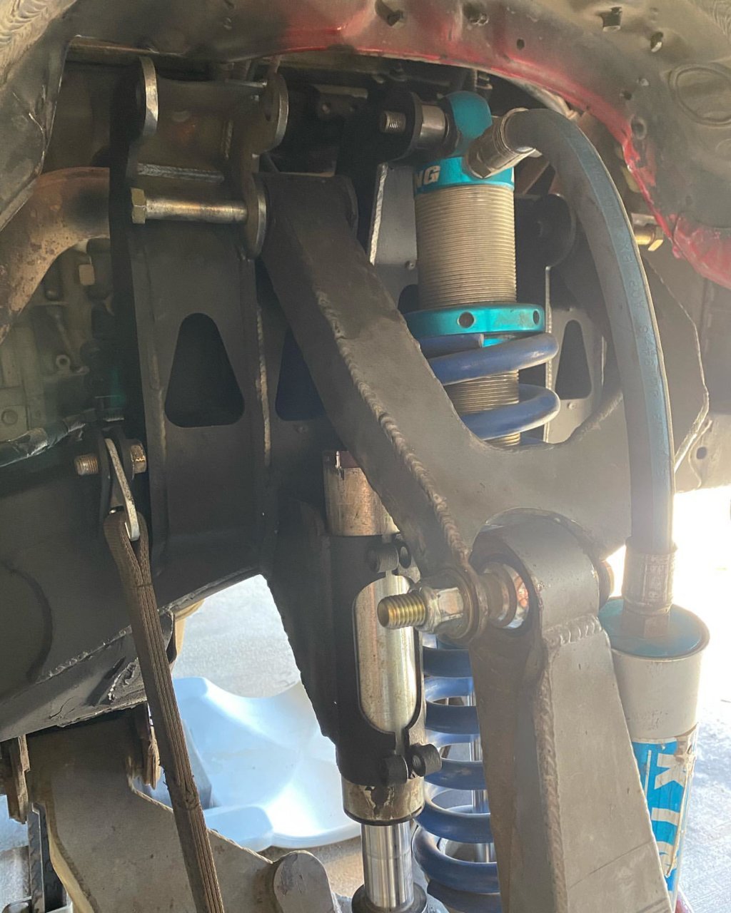

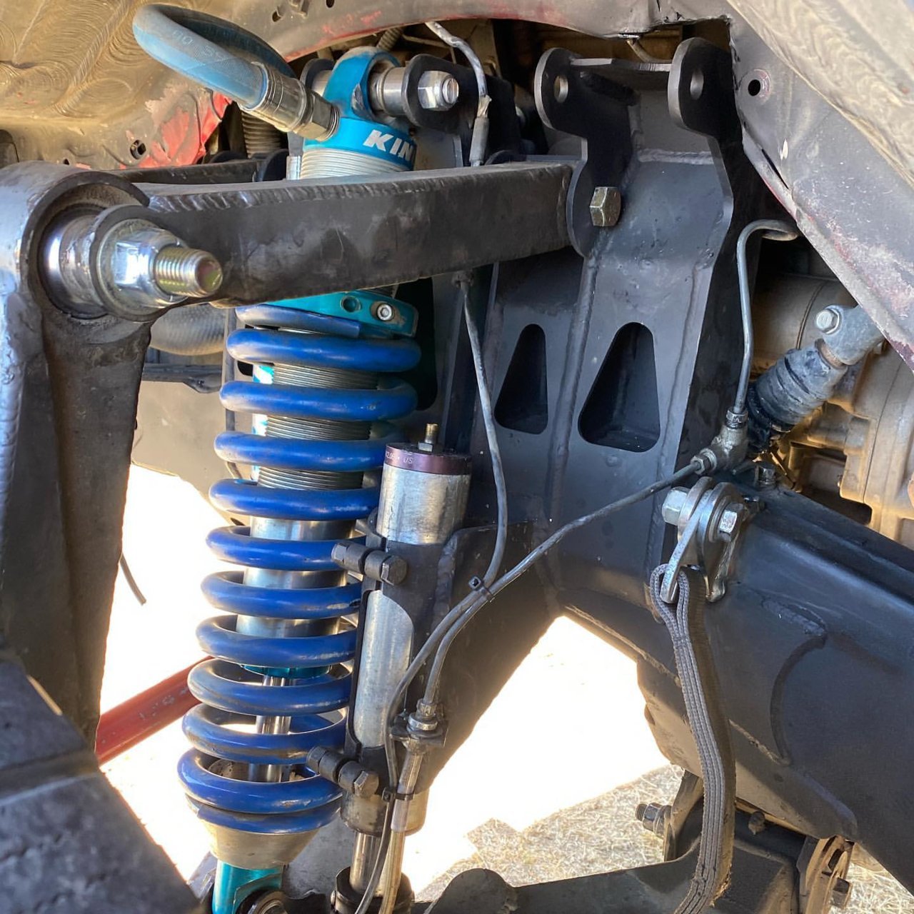

    More LC200 steering clevis’ for a buddy with a sweet long travel FJ prepping to install a LandCruiser rack.
    RoaminRoman likes this.
  15. Jan 12, 2022 at 4:38 PM
    #75
    m00seNUckLEz
    m00seNUckLEz [OP] tAc0 aFiCi0nAd0
    Dec 20, 2015
    #172698
    853
    Fresno, CA
    Under Construction

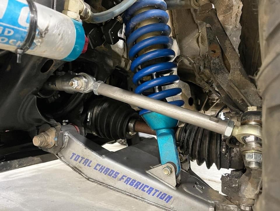

    Here’s a 5ThGen4Runner running a LC200 steering rack, my custom clevis’ and solid piece tierod setup
    9C6623BC-108F-4D02-BF3B-004E933A9C19.jpg DCB3FFC1-F6FC-4B6D-A0E1-B8842DBB87A7.jpg 493B70E0-3707-4D86-AD59-2B8E837C948C.jpg 8D0A9041-EF6A-4253-B2B0-31B398855B00.jpg
    Wero94 and Wishbone Runner like this.

    Would it be possible to machine a lip, so the factory boots could still be used? Or is that shoulder too small to work with?
  18. Jan 23, 2022 at 10:27 AM
    #78
    Wishbone Runner
    Wishbone Runner Because 4R
    Sep 9, 2012
    #86546
    6,338
    James
    CO
    04 SR5 4Runner
    King/Dirt King
    I think the bolt is too wide to go over the boot, the tundra boot is 2” wide at best when stretched out, and I think the bolt would tear it.

    Do you mean the diameter of the opening at the end of the boot? The clevis isn't larger than the tierod it goes over, is it?
  20. Jan 23, 2022 at 3:30 PM
    #80
    Wishbone Runner
    Sep 9, 2012
    #86546
    6,338
    James
    CO
    04 SR5 4Runner
    King/Dirt King
    The rack side yes, the bolt head and nut stick out quite a bit from the clevis.
