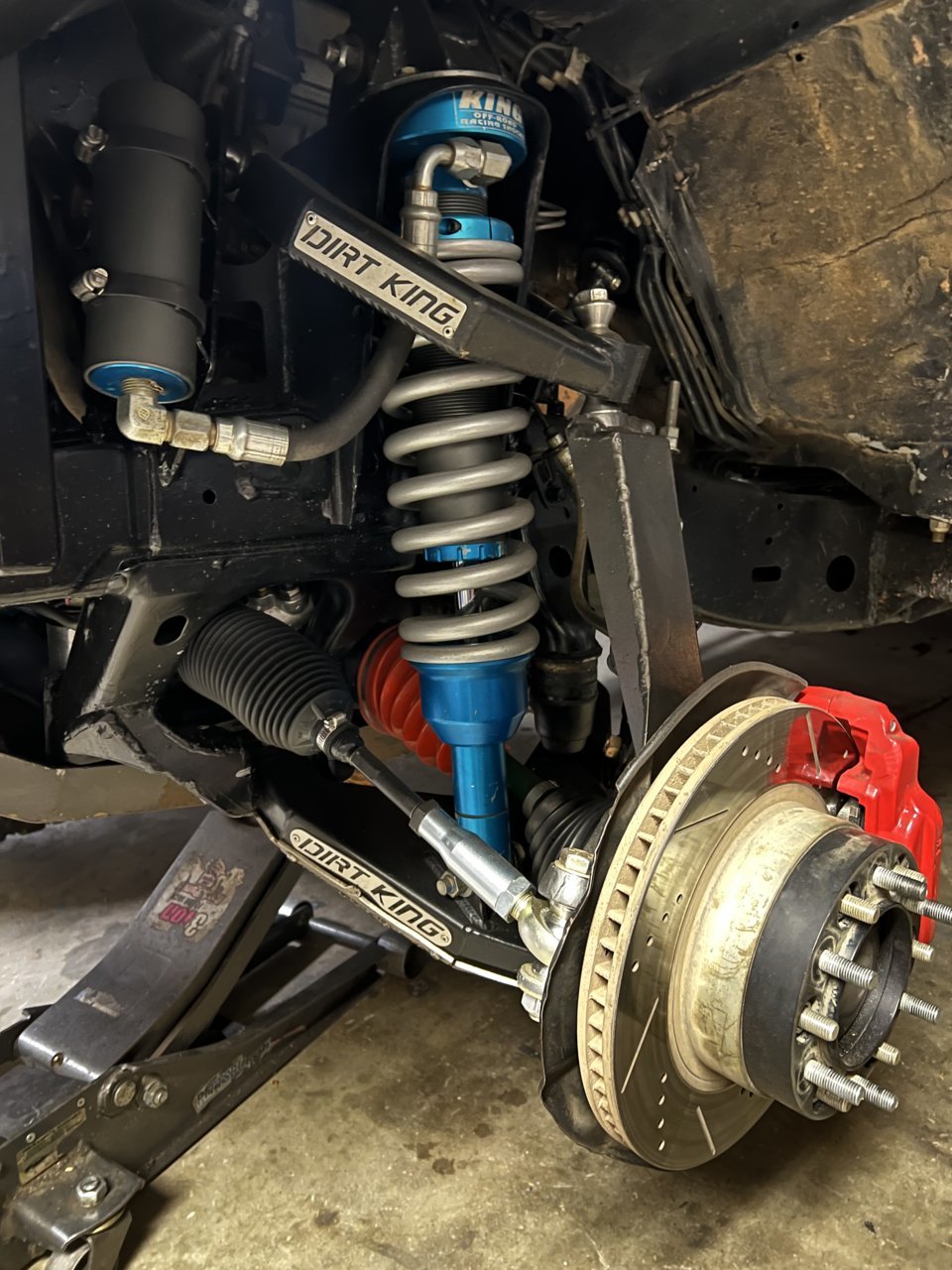

    04 SR5 4Runner
    King/Dirt King
    Tundra is 24mm, 4Runner is 22mm, taco is 14 or 16mm, I don’t remember off hand. The issue is the rack gear is now at the edge of the rack whereas the stock Tundra rack has some unmachined bit to it at the edge, and the larger ties would not leave enough material to thread into.

    04 SR5 4Runner
    King/Dirt King
    I have been running that same setup all summer and it has been great. Get to keep the tundy boot too which was huge in my book.
