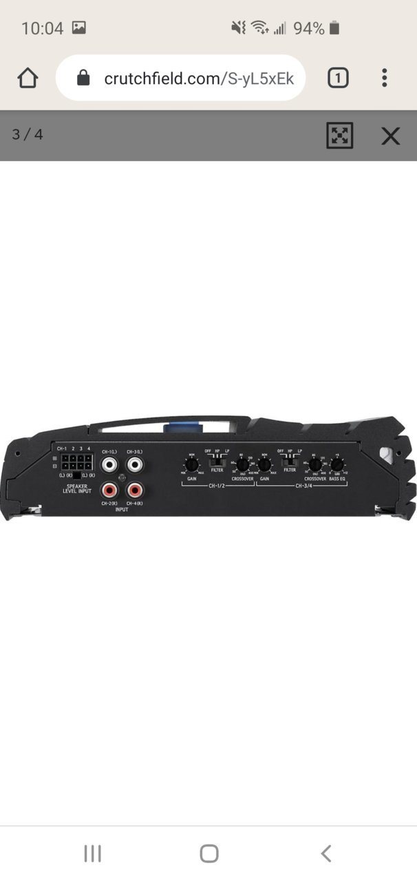

    I started with some Hertz 6x9s and 6.5s in the rear paired up with an Alpine MRX-F65 (see below for amp connections pics). Great upgrade for the last few years. Now after some reading through the TW black hole :spending:

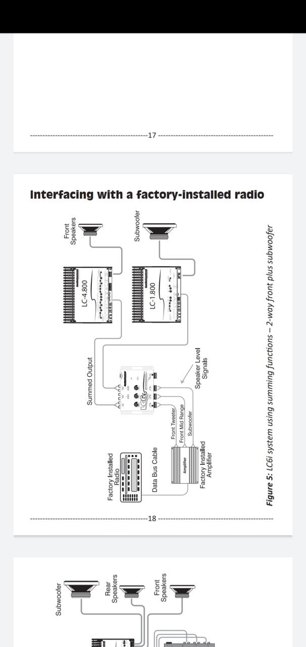

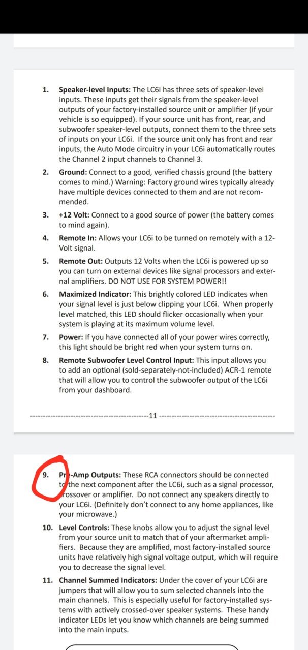

    The LC6i manual (attached) recommends to NOT connect a speaker directly to the Line Output Converter and the traditional method as most of you know is Head Unit- LOC- Amp- Speakers (see attached).

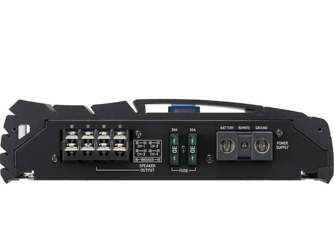

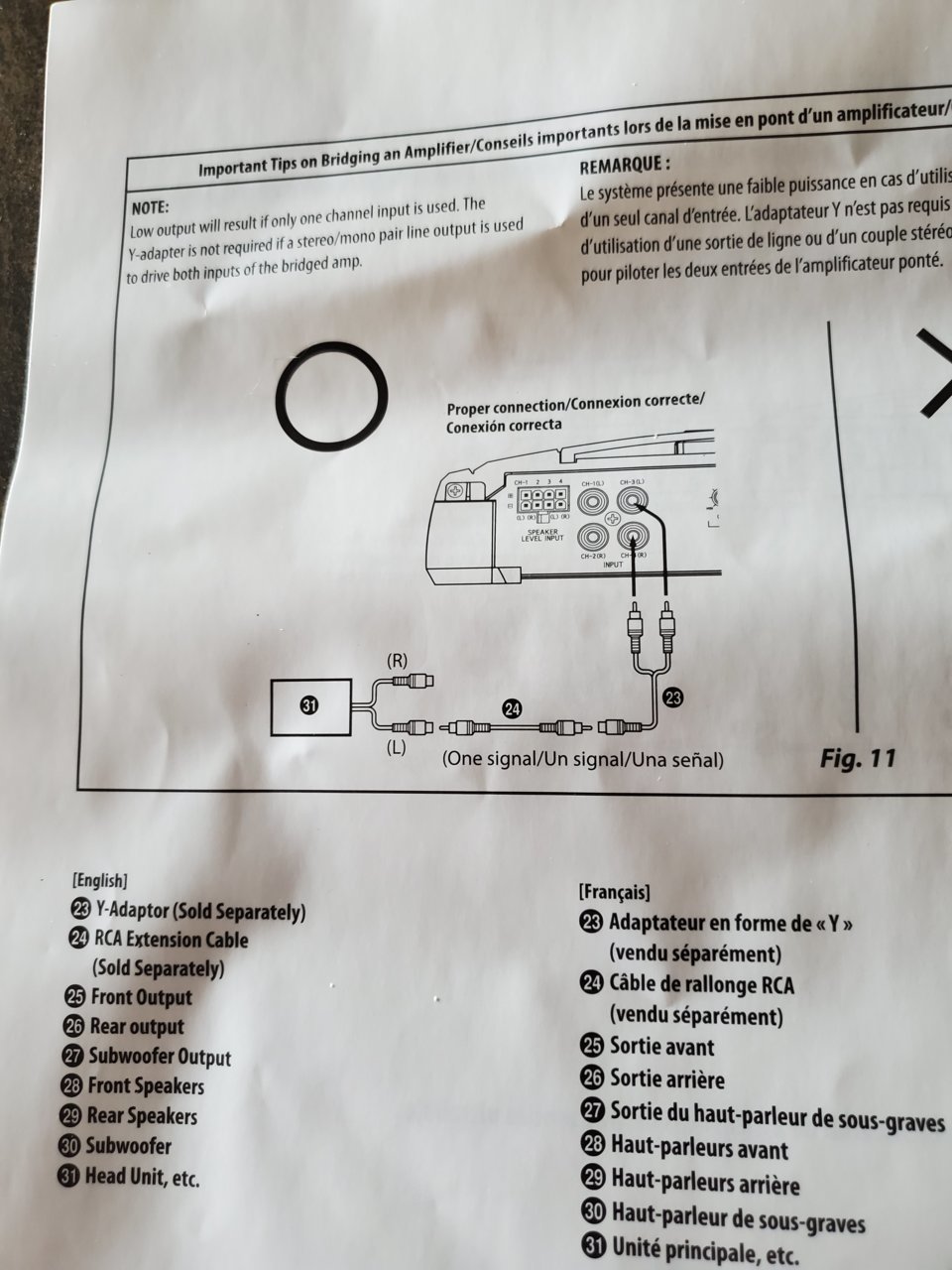

    The amp manual shows a pic of bridging, and specs say 4 ohm and 2 ohm loads are possible.

    And I thought the same thing but according to the diagram in their manual you cant use the LOC outputs to go directly to a source (speaker).
    It has to come from the Amp - I think.

    Gotcha that's what I thought and why I just assumed a LC6 vs a LC2 would give me that option but after looking at the manual and their diagram it looks like that's a no go? Unless I'm missing something? Check out #9

    “Subwoofer connection” meaning, as I wrote in the previous response, either a subwoofer amplifier or a powered subwoofer. Both cases is an amplifier input.
