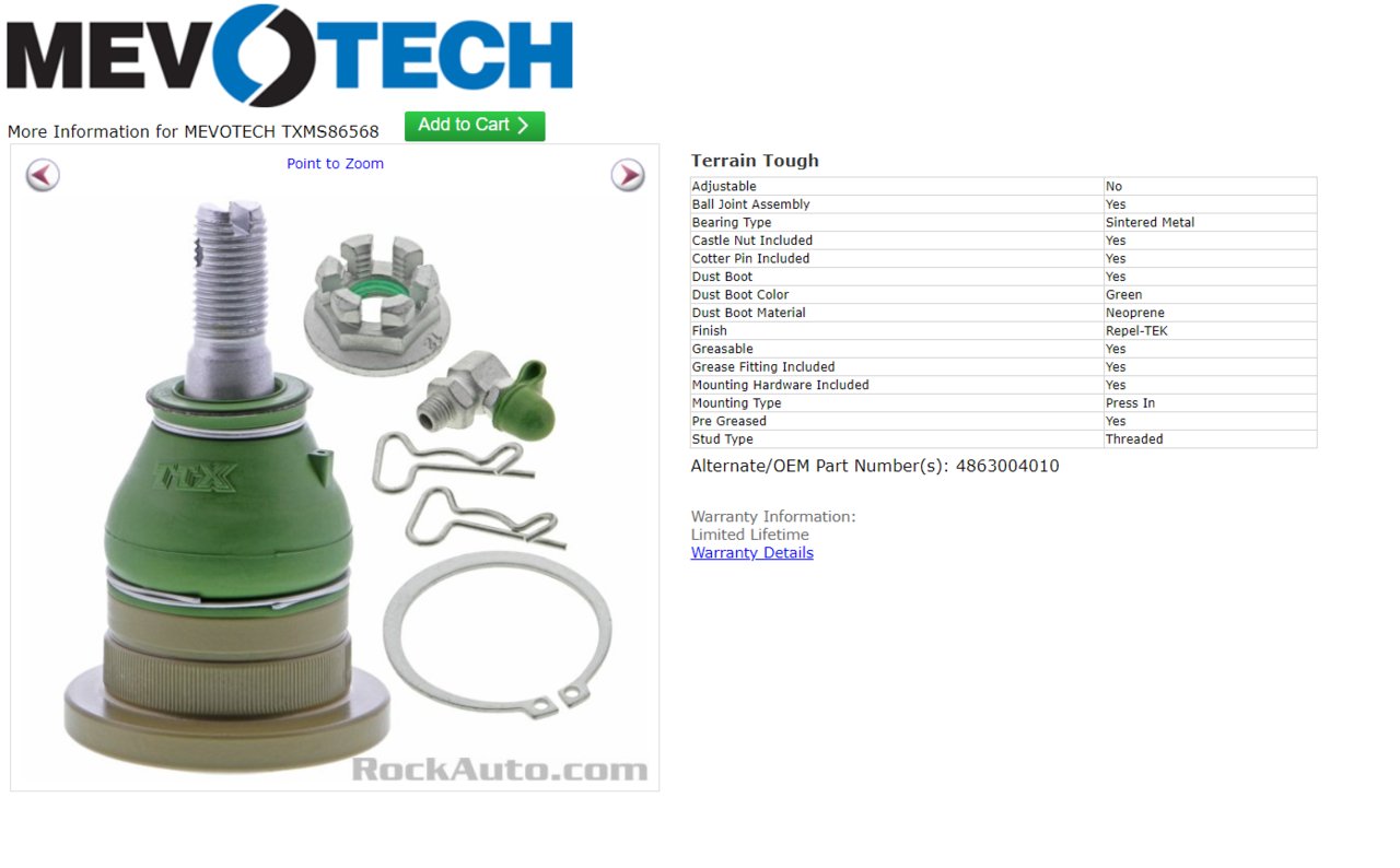

    Yours the green boots?
  9. Sep 15, 2020 at 6:47 AM
    Xringer07
    Xringer07 Member
    Sep 25, 2019
    #306261
    12
    Justin
    2012 TRD Sport DCLB
    No, mine have black boots
  10. Sep 15, 2020 at 8:30 AM
    Aardvark13
    Aardvark13 Sultan of Squeeze, Wizzard of Slide
    Mar 23, 2018
    #248164
    677
    Byl
    Knoxville
    2014 DCSB OR
    doopity doo.. gettin places..
    Ah, ok. I went with these. Their 'Terrain Tough', for whatever that's worth, lol
