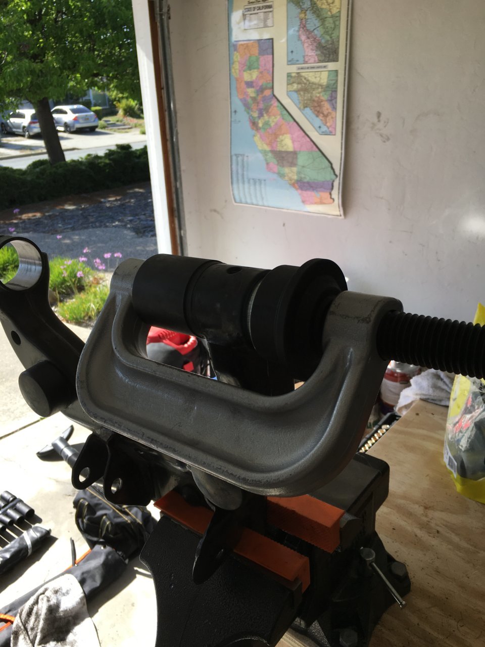

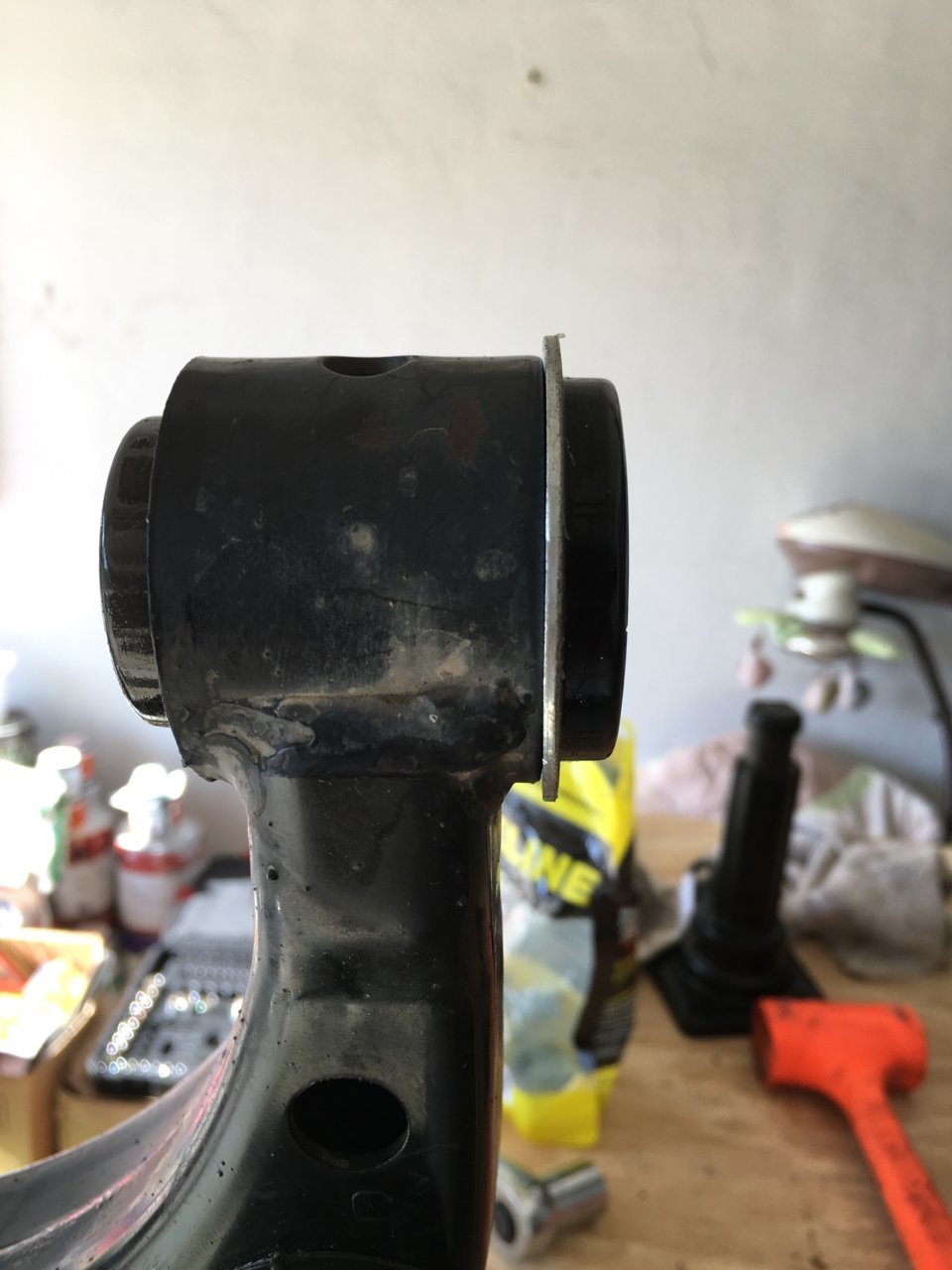

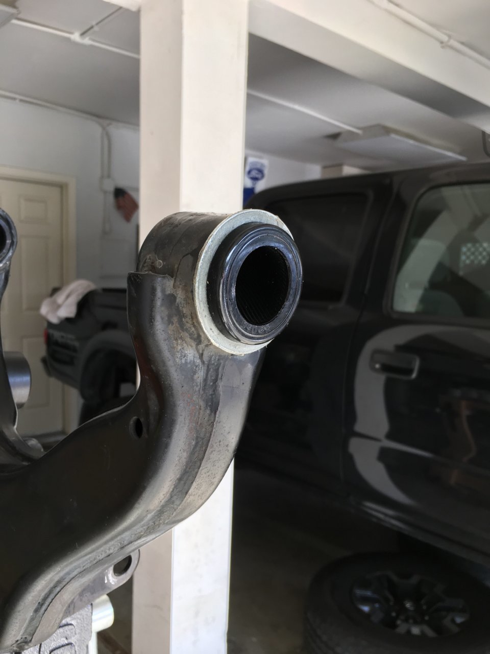

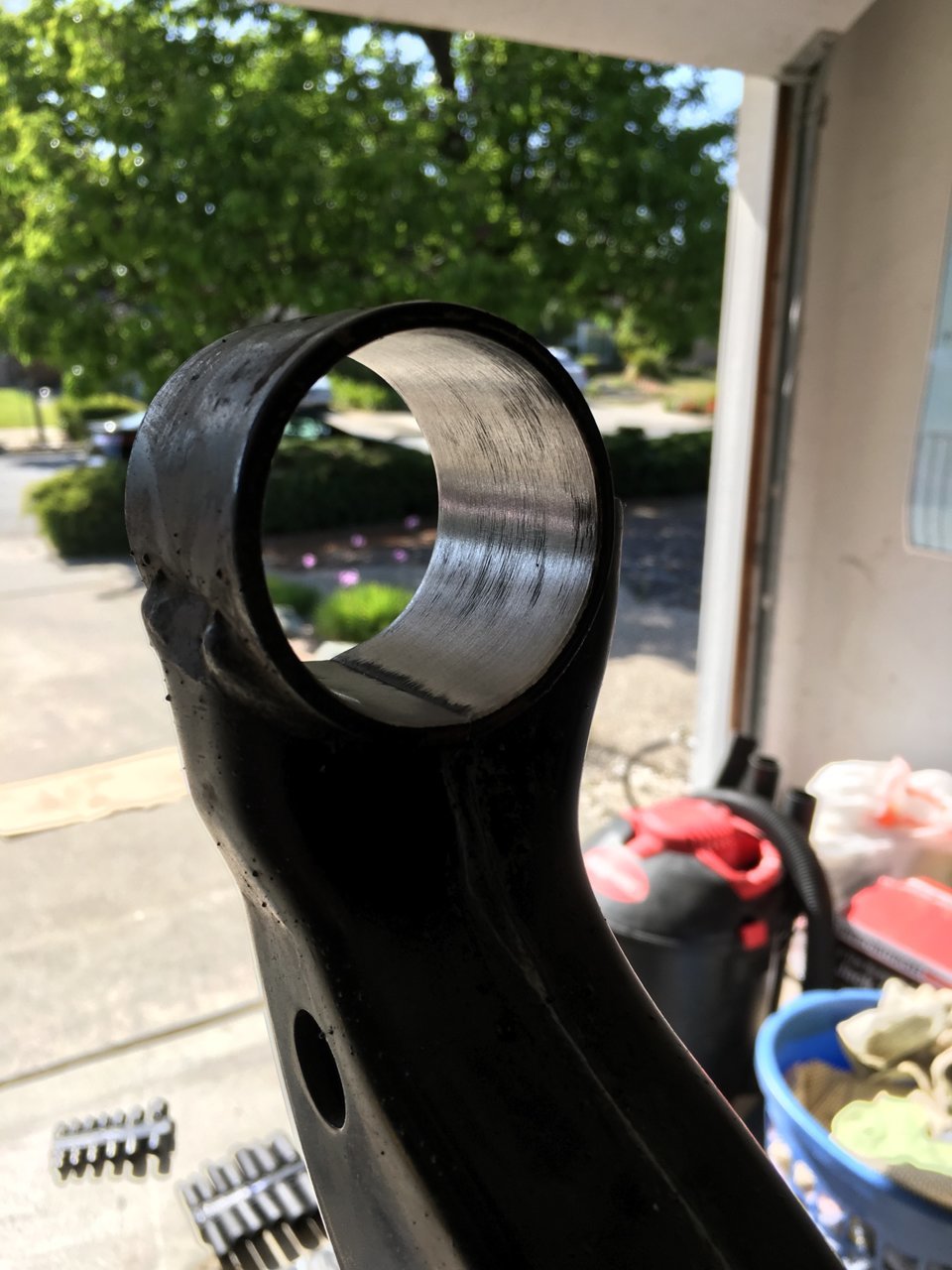

    Got the Whitelines installed last weekend.
    Bottle jack and Mapp gas torch to get the old ones out.
    Wire wheel to clean.
    Pressed in the Whitelines with a balljoint press.
    The cam bolts weren’t seized. Everything went really smooth. Not a squeak as of yet. My steering is much tighter, but...
    I also installed SPC UCAs and replaced inner/ outer tie rods, LBJs, steering rack bushings, sway bar endlinks and sway bar bushings.
    Thanks everyone for all the great info! Without this site I would never have got this stuff done.

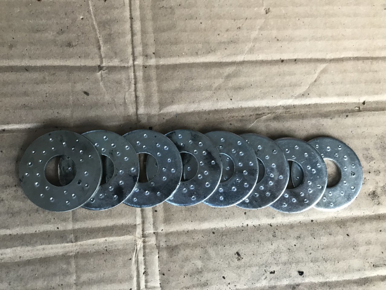

    Since doing this "mod" to the LCA bushing washers, have you had any slipping problems?
  17. May 30, 2019 at 7:24 PM
    #197
    Snowman
    Snowman I have a problem for your solution…
    Sep 8, 2010
    #42917
    3,249
    Craig
    Somewhere in Canada
    Check out my build
    I have not had any issues. Not saying that the “mod” worked though, may not have slipped without the dimples anyway.

    I figured that much, thought i'd ask though. Looks like you just used a center punch to make all the marks?

    Correct. Went at a slight angle to make the ridge more pronounced.
