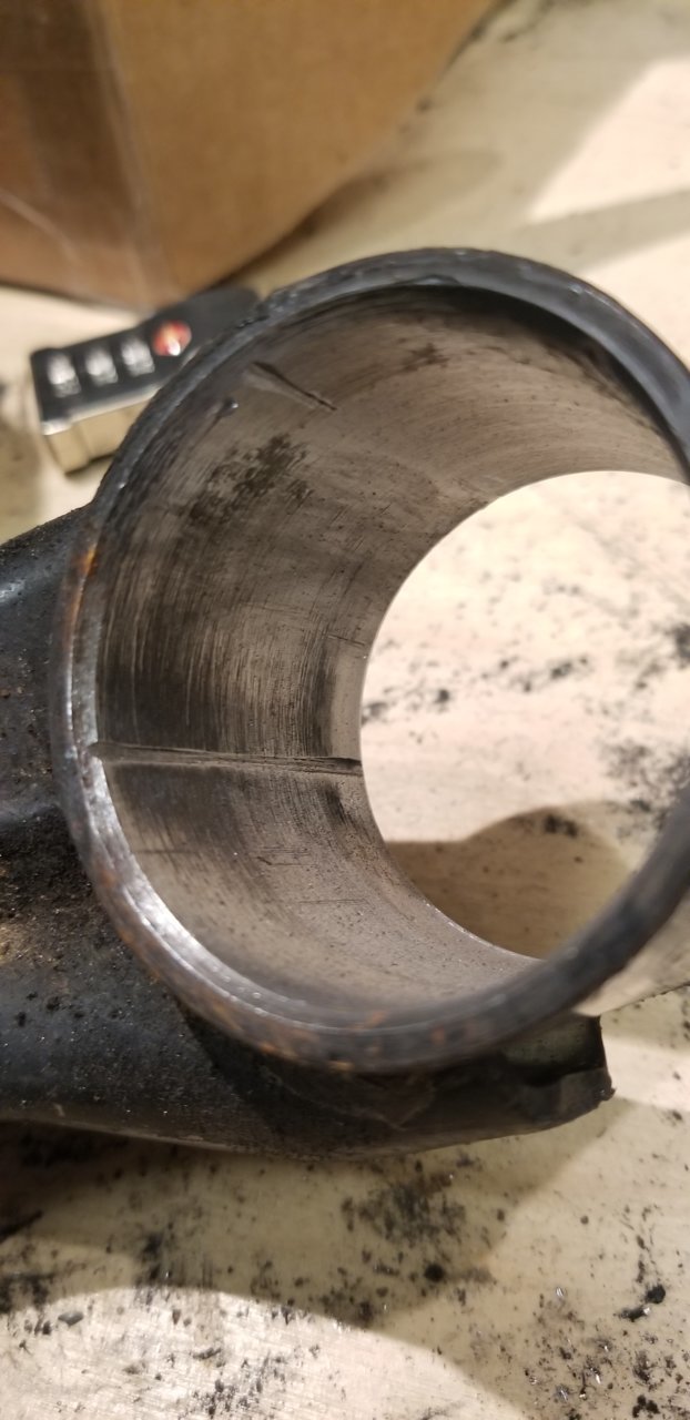

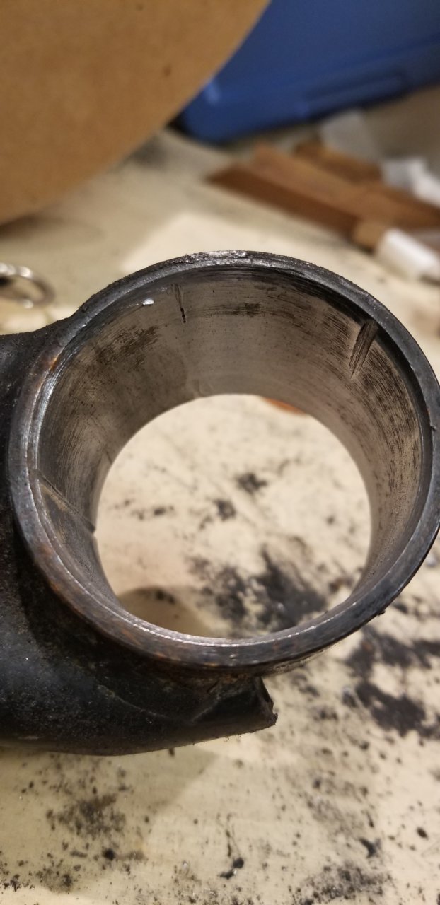

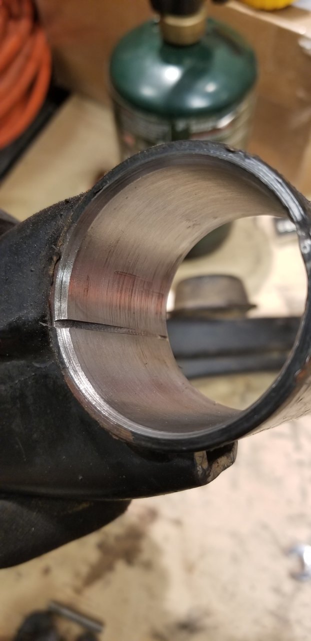

    I did the same thing. Got a used LCA from a forum member and worked on putting the whitelines in this last weekend.
    I don't have a toyota factory bottle jack since my truck didn't have one from PO, but I had another cheapo that I modified to do the job. Then pressed in the new one with a ball joint press.
    The first attempt didn't go so smooth as the center thru piece pushed out of the rubber and outer sleeve. So had to burn out all the rubber and use a sawzall and punch to remove the outer sleeve.
    After cleaning up the inside with a wire wheel, i found some interesting marks. Seems as if someone before did bushings on this LCA and used the same sawzall method but cut a little too deep past the outer sleeve.
    Did anyone see marks like this on the LCA's?

    That's what I figured. Given how uneven the groove is, didn't seem like something that would have been left from assembly at the factory. At least it's between the welds that attach the pivot to the LCA.
    Are you talking about a pair of LCA's or ES bushings?
    I'll sell you my ES bushing kit (8.3115) since I ended up going with whitelines if you're interested. Brand new in box
