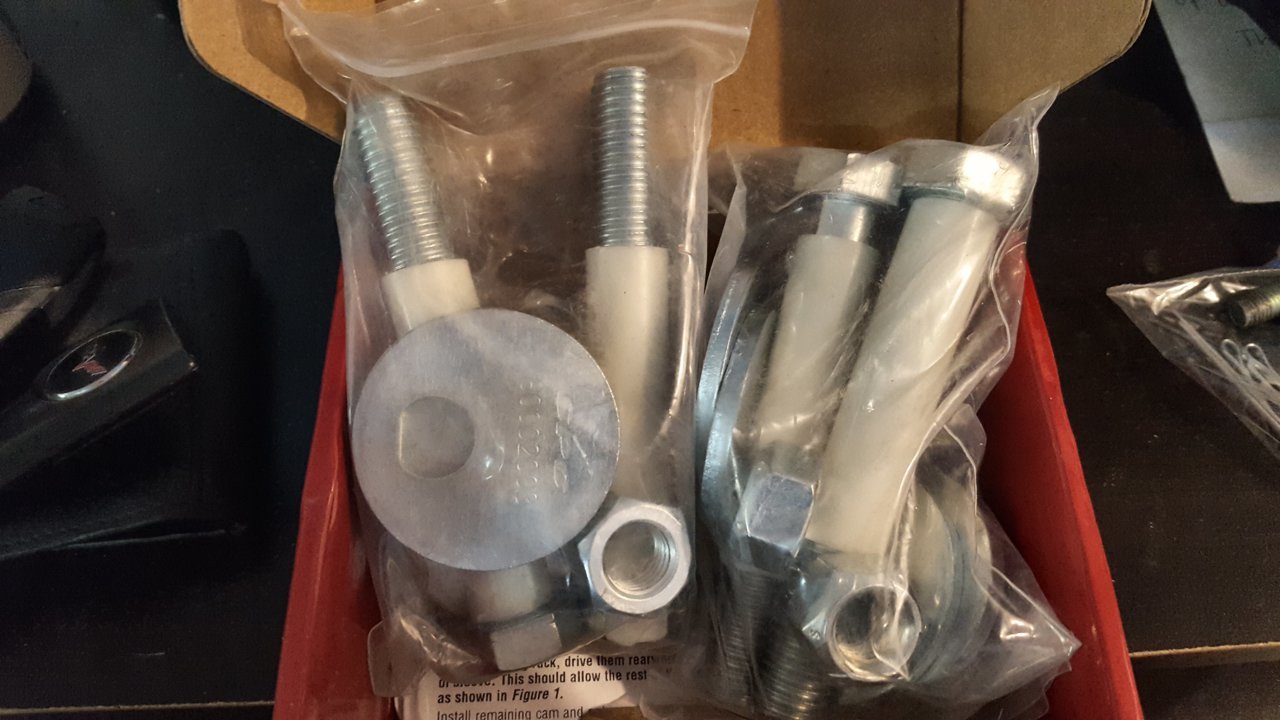

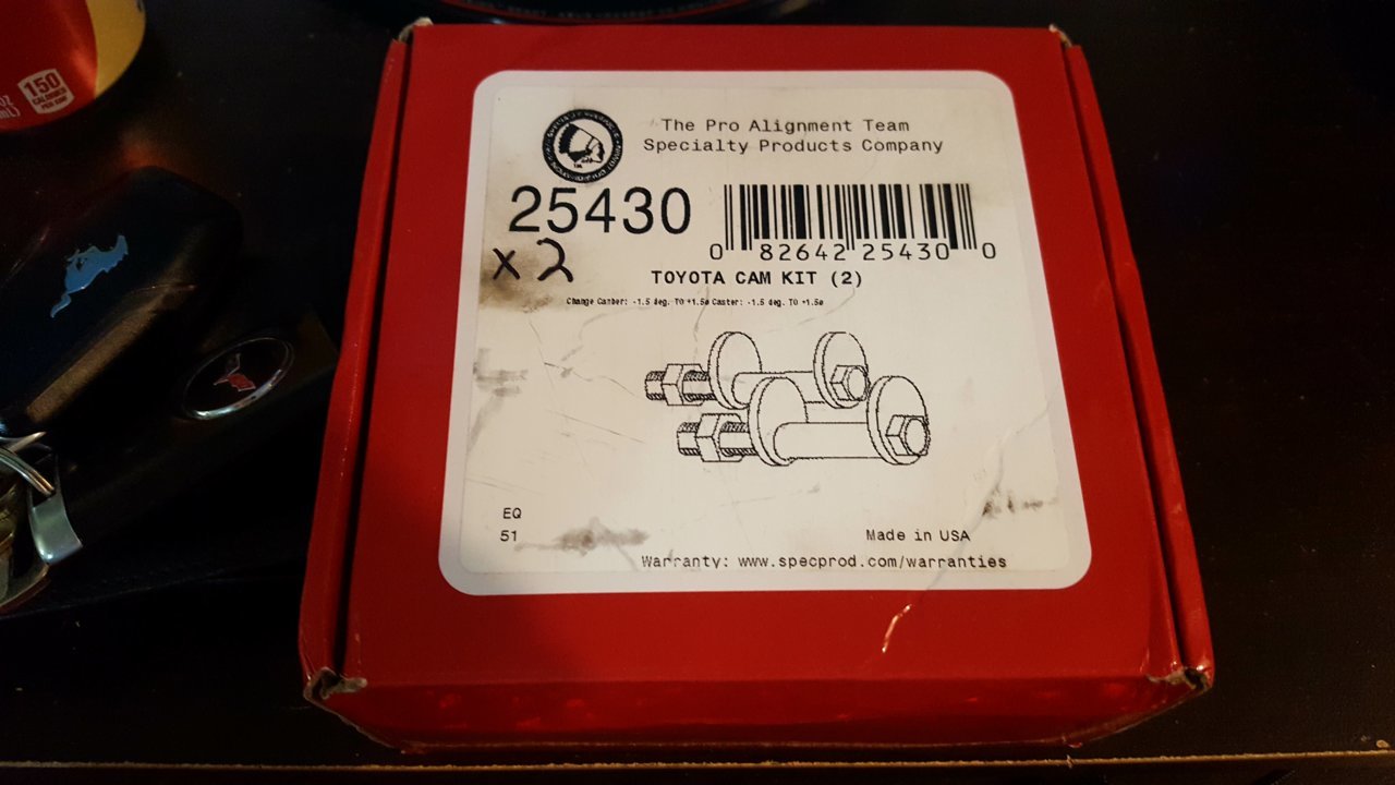

  14. Aug 13, 2019 at 7:20 AM
    #234
    Kwikvette
    Feb 27, 2019
    #284735
    81,754
    Fresno County
    4 run, 2 don't
    Didn't have to cut mine; having said that I have a new set by SPC if you want for less than new.
    Bought them about 2-3 months ago when I replaced my LCA bushings.
    acal and BThorson like this.
  15. Aug 13, 2019 at 7:53 AM
    #235
    Squeaky Penguin
    Squeaky Penguin Nothing Ventured, Nothing Gained
    Apr 5, 2012
    #76340
    10,079
    Brett
    Steamboat Springs, Colorado
    '01 4WD, SR5, TRD & '13 TRDOR AC
    Lots of dust and custom dents, Check Build
    Don't waste your time and money on the SPC cams. They won't hold an alignment, and will strip out sooner than later, and not allow it to be aligned at all.
    MedicMutt likes this.
