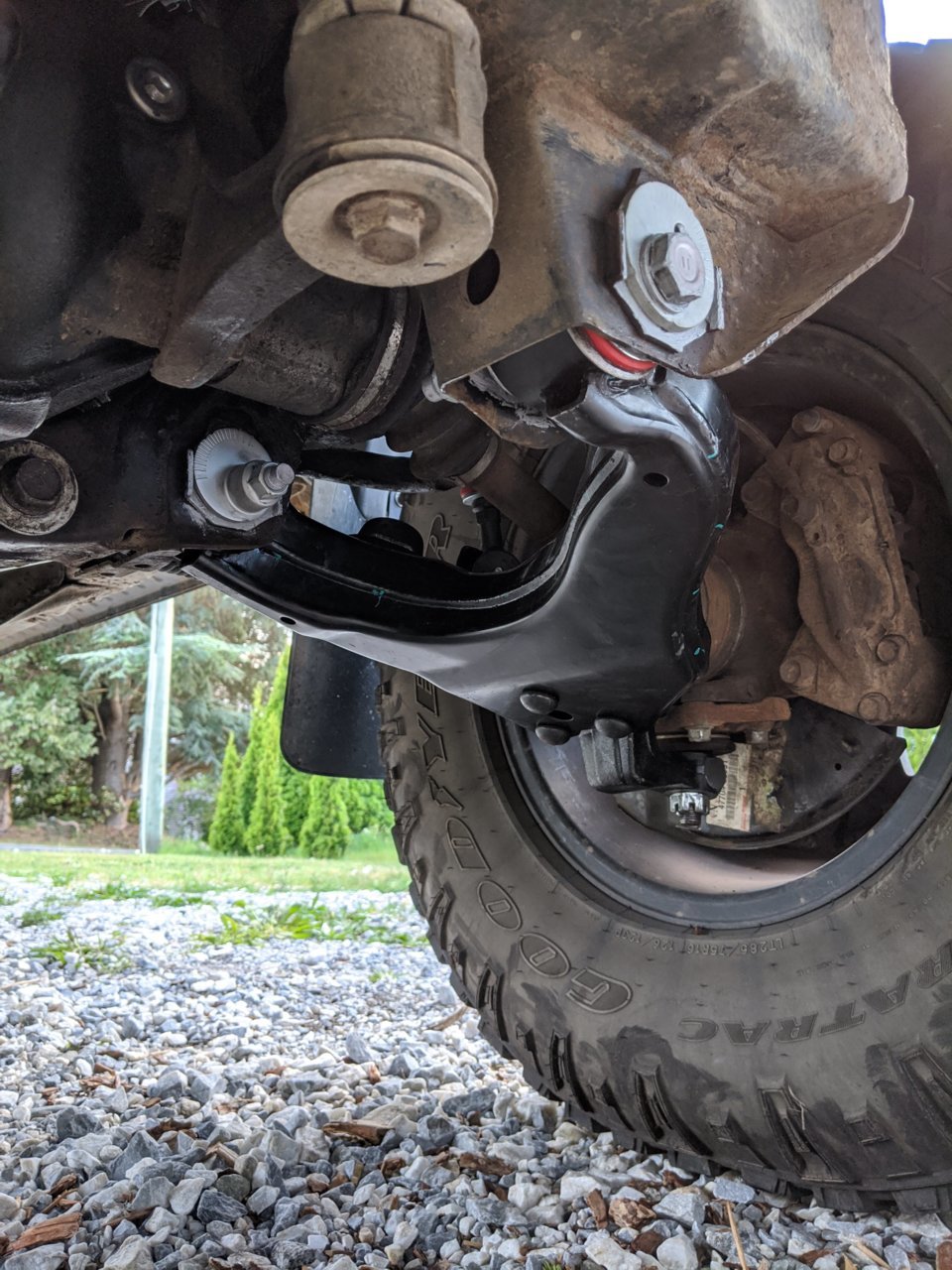

    Mevotech LCA's are installed with new ES bushings and new OEM cambolts. What a F$%#ing battle.:bananadead:
    Took it for a quick test drive after putting everything back together. I think it may have actually made my ride quieter - maybe placebo, I don't know.
    Surprisingly, my driver-side cambolts weren't fused and I was able to knock them out with a hammer. Wooo!
    Passenger side was a different story...:anonymous:

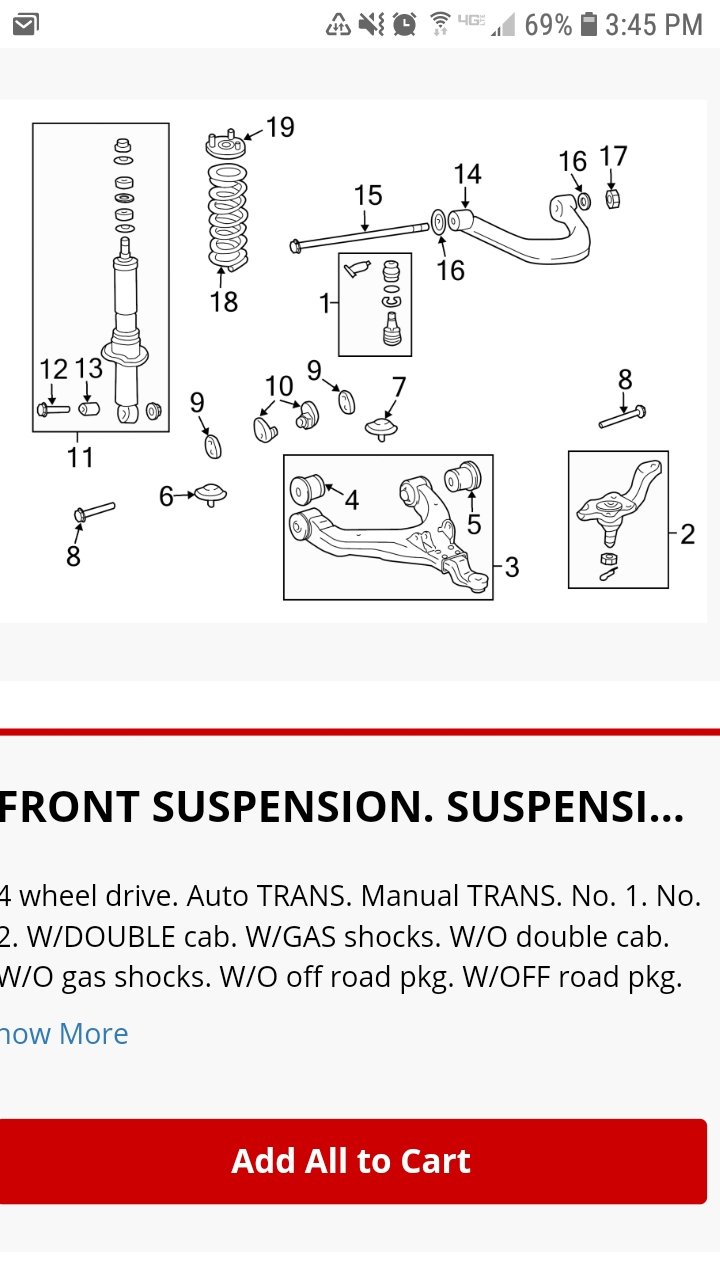

    This website is nice to diagrams and tracking down part numbers. Here's a link to the that suspension section but with it configured for my truck. Your PN's will be the same though as all 4x4 first gens have the same front suspension parts for the most part.
    https://partsouq.com/en/catalog/genuine/unit?c=Toyota&ssd=$*KwGeqrue4f_nytvsxcSXy8bS8vXrmpWYmYuVp9eP3omWj_CK2dmEjpeY1tLYw8y1gMXPxM6Jlp-GipOSg46XiJ-UnZmK2dmOwo-QiZiVmpnDyaKO0NTdxcnq09eYhI6Xiomamp6cw8vFgI2IwtiPkIjXq6b-7OeJgI2IxZbZ3YyP-PHinJyZudaz_uDu4O3viITV2ZHPj5CLwtjGxNnbxcrEzomWjZvVAAAAADHg3nc$&vid=0&cid=2&uid=284727&q=
    9008011283 - thru bolt
    4840935050 - sleeve that the bolt goes through
    4845235020 - rear cam plate that the bolt threads into
    Depending on your situation, you might be able to reuse some of the parts if they are salvageable.
    Definitely take care of it while you're in there though. No sense in pulling it back apart shortly after to fix something you could have done at the same time in the first place

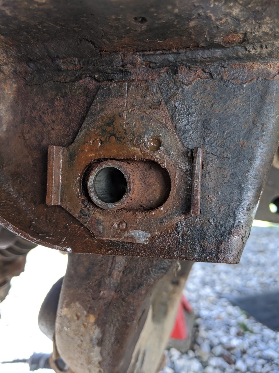

    It's the sleeves that rust to the bushing. If you don't live in a rusty place there's a good chance you can save a couple.
    The bolt and cam plate/nut are usually fine.
    Might be worth trying to pull it apart and see what you can save before you spend a lot of money on new hardware.
