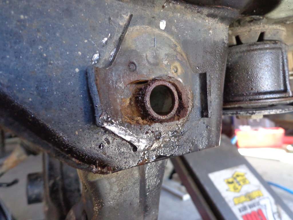

    On mine, I only had to cut on one of the four, and the bolt came out, and it was the sleeve that was rusted. I think this is quite normal. Sometimes the bolt will be frozen as well and you'll have to cut through it as well. Stick with OEM for the replacements, and you also should be able to reuse most of the original hardware.

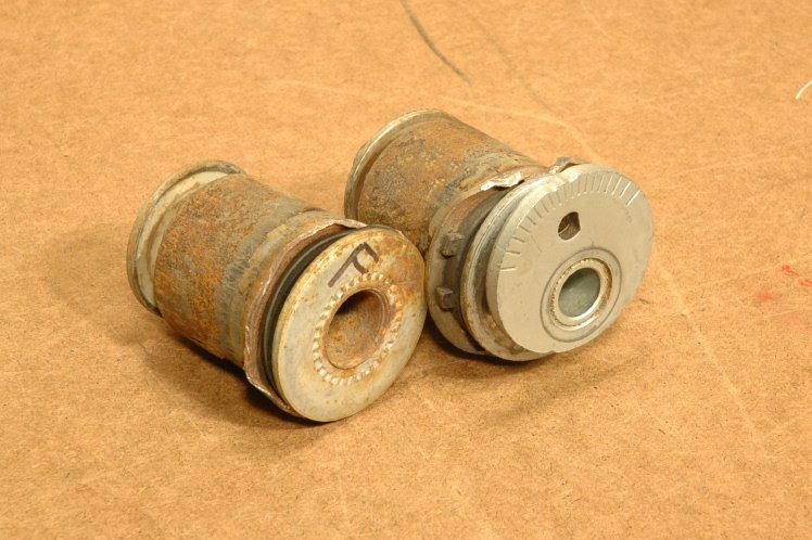

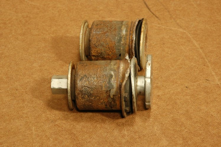

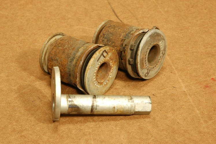

    There's some confusion here.
    The bushing has an inner and outer sleeve. One of the cam plates also has a sleeve, the other cam plate is just a plate and also serves as the nut for the pivot bolt. The "bolt" runs thru the cam plate sleeve and screws into the other cam plate. When the cam plate sleeve rusts solid to the inner bushing sleeve the whole deal must be cut out.
    Cam plate sleeve is best procured from Toyota. Seen in bottom of pic below, the other plate/nut is not shown.
    It lives inside the bushing and is needed with all types of replacement bushings.
