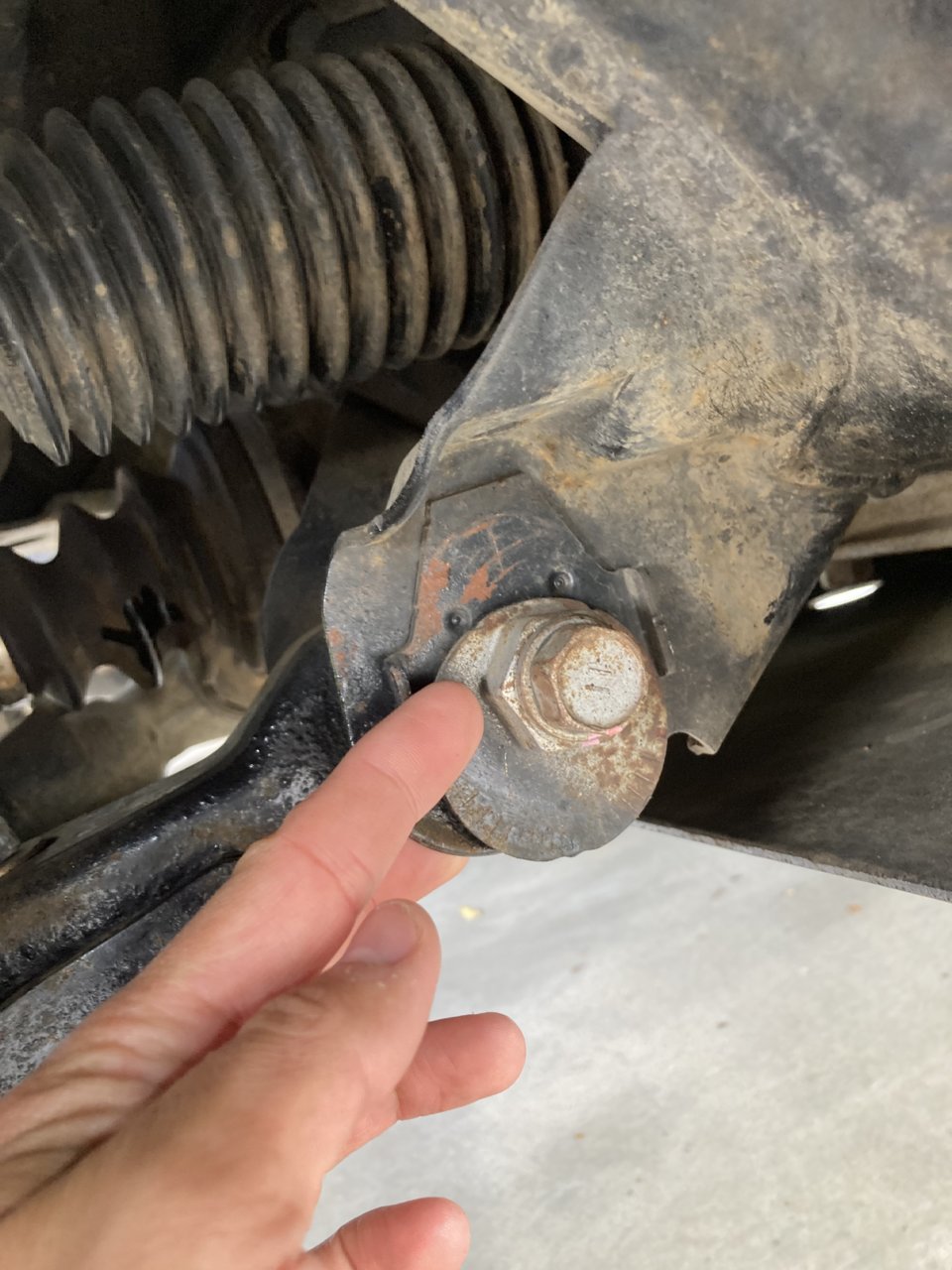

    5C155A0E-F466-49EC-8EB8-3307D5C16CB7.jpg I just dealt with this a couple of days ago. Secure the vehicle with some jack stands. Step 1.take pictures and make markings of the current location,with vehicle s upported, remove front bolt Soak everything in PN blaster and let it seat a couple of hours. Step 2.(before installing heat the interior of the cam, this is optional) Replace the front bolt,Loose the rear and front bolt just enough that you can tell it’s not making any pressure over the tabs. Step 3. Secure a 19mm socket in the back and a large enough Wrench(can’t remember the size, apply a lot of force back and forward, spray, heat, twist, do not pry on the front(it needs to come off on the front). Step 4. You should be able to remove the rear with no issues. Then bang with a rubber mallet, of a piece of solid wood in between a solid mallet of hammer( you will deform if you hit it directly) step 5. Repeat the process until a ol wack sends the sleeve flying. Don’t be alarm if the front round tab in the front falls off, you can re align and press upon installation. Just remember DONT hit the sleeve directly with a solid hammer. You’ll fuck it up!
    edit* picture for reference on the once you should be twisting to include the one in the back(19mm)

    Again, I did it this last week with 100% success. After being removed wire wheel the fuck out of them and used silver anti-seize prior to re installation.

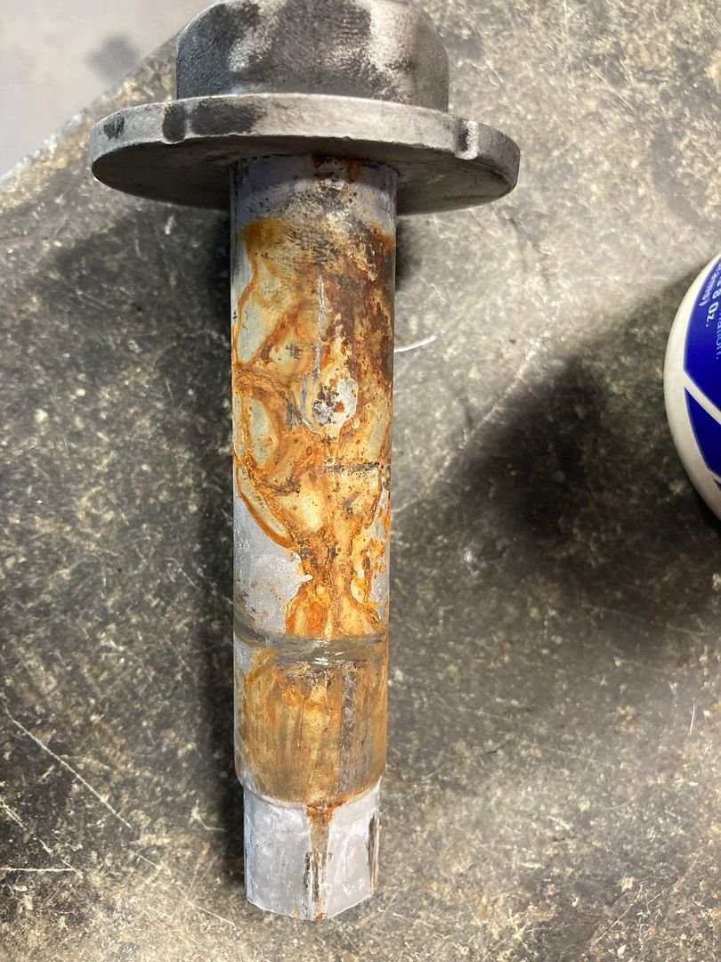

    The thing that many folks - especially those who don't live in areas where they use road salt - don't realize, is just how fast these bolts corrode and just what a pain they are to get out once rusted. As evidence I offer the following pic of one of the bolts that came out of my 2021 4Runner (same front suspension as a Tacoma) when it was just 5 months old after having gone through just one Rochester, NY winter. Note the corrosion that has already started and imagine how bad it could get in 3, 5 or more years. And the corrosion isn't limited to the bolts. It also extends to the sleeves the bolts go into. The two parts literally corrode together and that's what seizes them.
    So, what should one do to prevent this from turning into a disaster that requires new bolts and lower control arms? The reason I took (all four) of the bolts out of my almost new truck was to liberally apply Never Seize to the bolt shanks before reassembling everything and getting an alignment done. Once everything corrodes together, the likelihood of getting the bolts out of the LCA sleeves is pretty low. And slapping new bolts into already rusted sleeves is just going to lead the same problem down the road.
