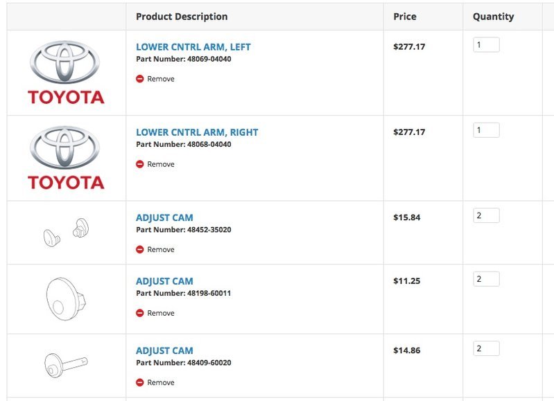

    Hi Guys,
    I'm going to replace the LCA on my '09 4x4 (non-TRD) tacoma. Seems off roading, winter salt, etc. has caught up with me. :)
    Would anyone know if this is the complete list of parts I need to do the job or if I am missing anything?
    Thanks,
    Chuck
    LOWER CNTRL ARM, LEFT Part Number: 48069-04040
    LOWER CNTRL ARM, RIGHT Part Number: 48068-04040
    2x ADJUST CAM Part Number: 48452-35020
    2x ADJUST CAM Part Number: 48198-60011
    2x ADJUST CAM Part Number: 48409-60020

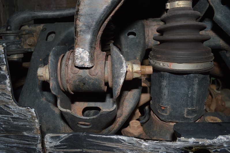

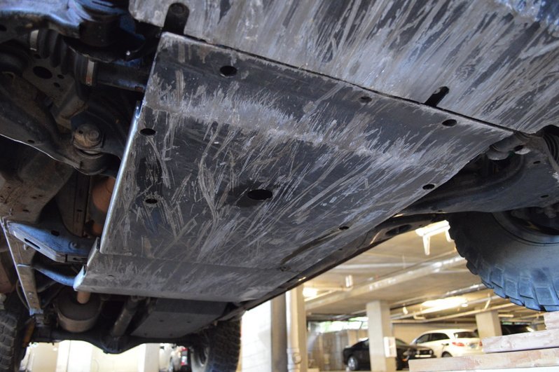

    Alright, so I got under the truck just a moment ago to do a little inspection for myself. It appears I caught a rock and bent the LCA mounting point and bolt on one side. That might explain the lack of adjustment! :eek:
    Any ideas on how to fix the mounting point? I'm thinking heat it up and bend it back. Just curious if anyone has a creative solution. Also, it looks like the budbuilt's are doing their thing! :)
