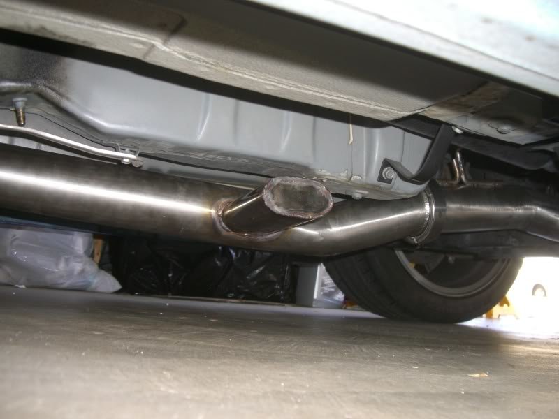

    There quietflow muffler toned things down quite a bit but the drone remains. I understand that this is sort of inherent in the geometry of the piping and not necessarily because of the muffler.
    I've seen pictures around of people running a helmholtz resonator. I like this idea but I was wondering how you determine the right length accurately enough. It seems like it would take some tuning of the length to get the intended effect.
    Has anyone around here tried this?

    There's a formula to figure out the length. I believe you need to first determine the frequency that's annoying you and plug it in to the equation.

    I don't think they're that simple. Temperature comes into play also and that can change with drive duration, intensity, or weather.
    Where to put it? You'd have to measure the temp of the pipe at the location you have space/plan to install it and put the temp in your equation.
    It's an interesting idea, and I'm all for modding and experimenting, just think that the results may vary widely and wouldn't expect results.
    If I tried it, I imagine installing a longer tube and cut and capping it somehow, driving on each length for bit, then determining which was the best and install a final piece.
