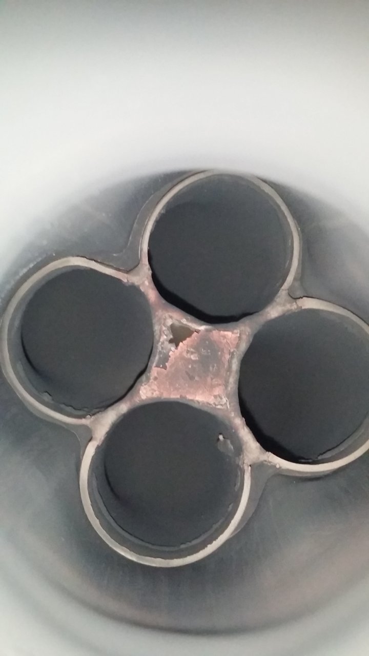

    Could this be galvanic corrosion? I’m coming at the question from the rock climbing world, where a stainless bolt next to a zinc plated washer will corrode. Would be another argument for welding with stainless.
  5. Nov 18, 2017 at 12:11 PM
    #25
    05Taco4x4
    05Taco4x4 ToyotaHubs
    Jun 29, 2011
    #59085
    6,222
    2TR-FE Enthusiast
    FJ Tcase, Manual Hubs, 2017 Head unit, Mirror Riser
    Galvanic corrosion will occur at the boundaries, this is uniform
    Farcedude[QUOTED] likes this.

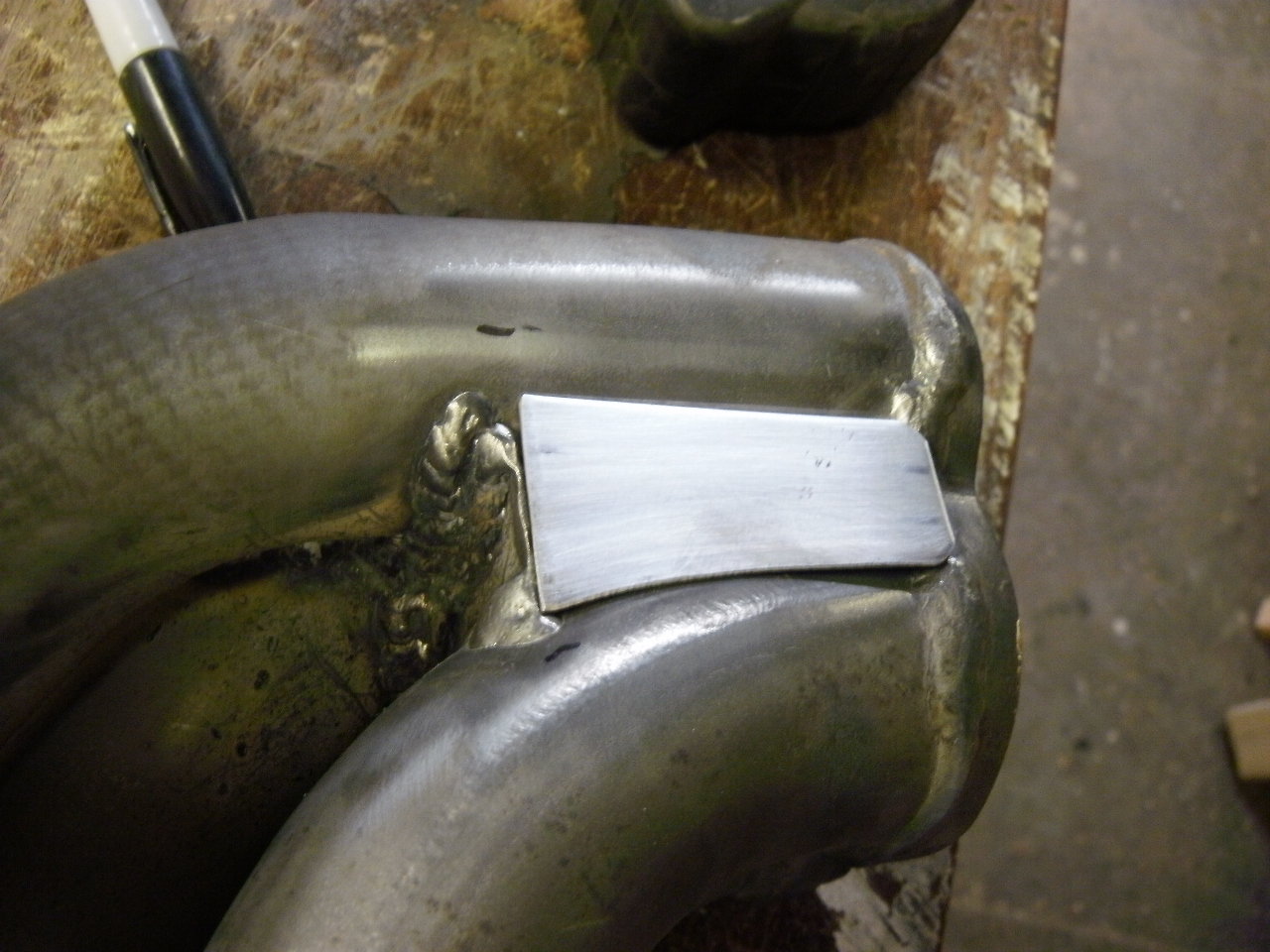

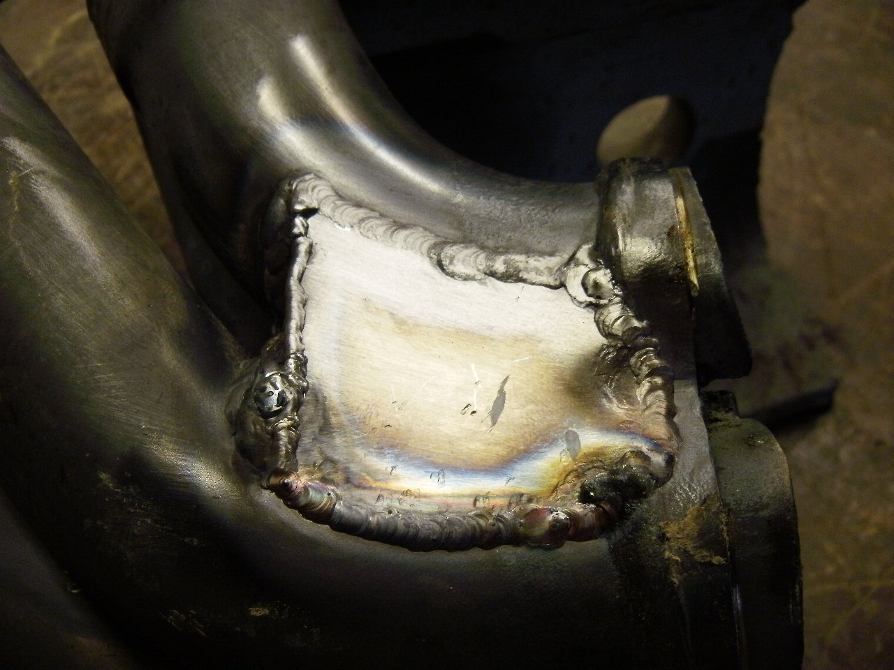

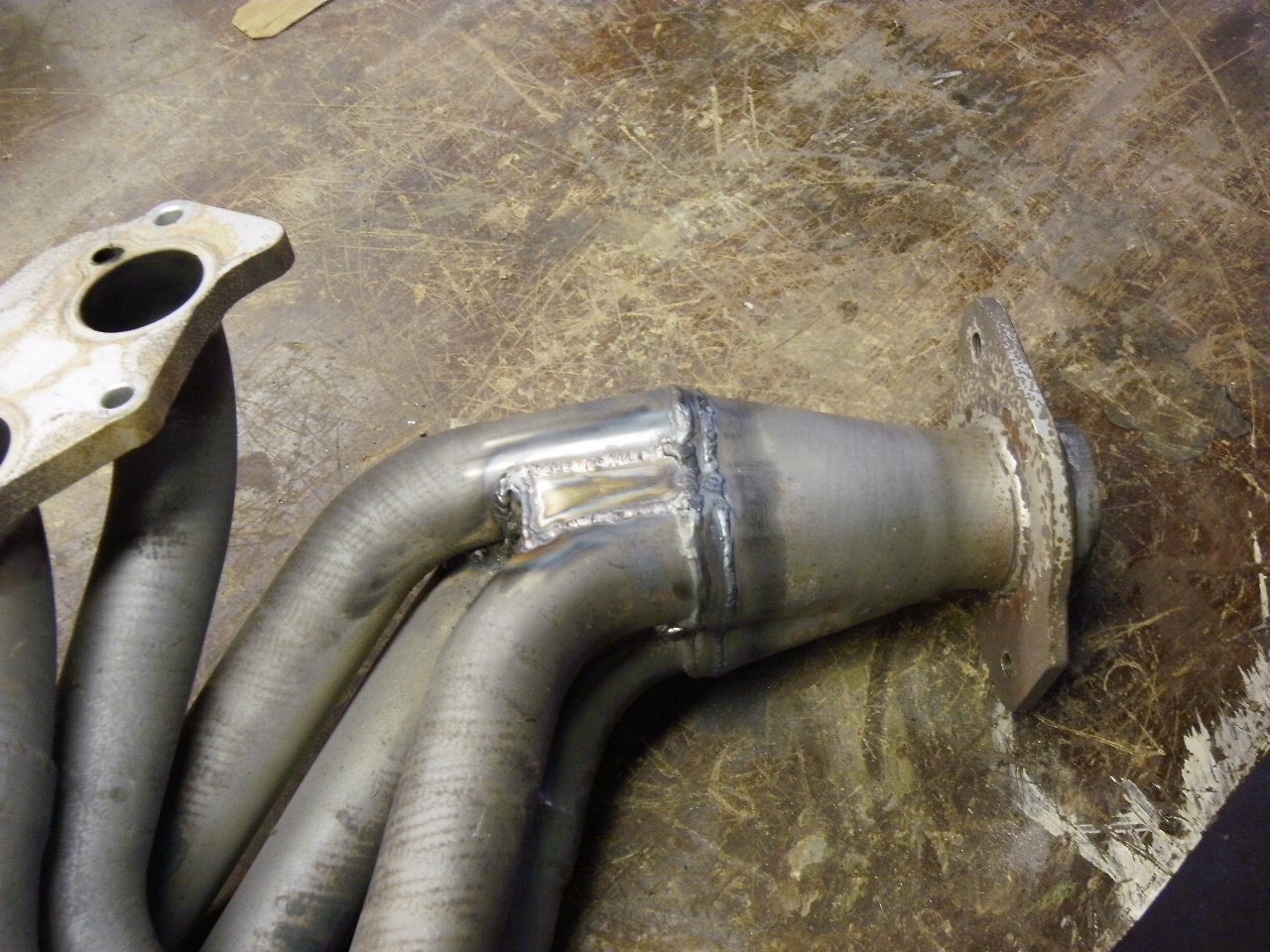

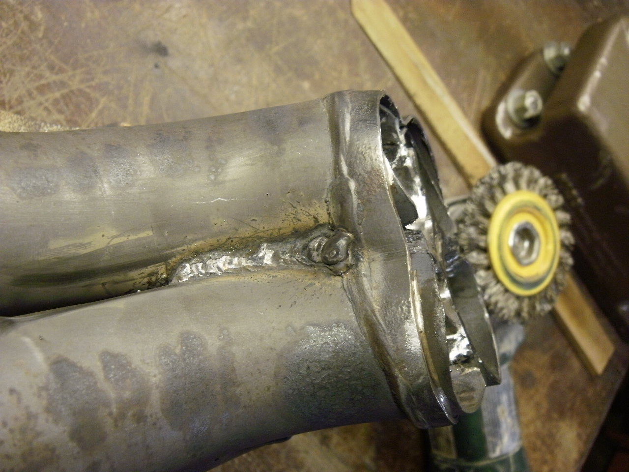

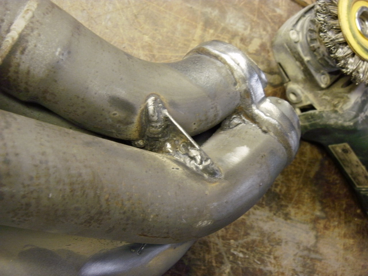

    After letting this project sit around all winter I finally completed the repair. I'm not super thrilled about how the welds came out honestly. I used to weld for a living but not for the past seven years so I'm a bit out of practice...
    The stainless wire I used seemed to work OK but it behaved in a way I wasn't used to. It didn't seem to wet to the edges very well. Could've been my settings, could've been me, it was tough trying to get in between those tubes.

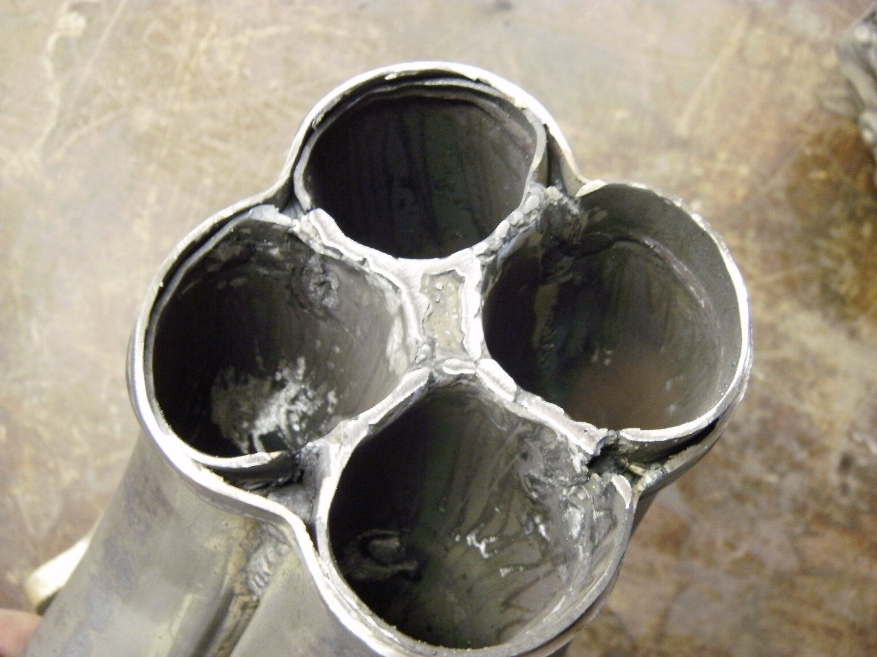

    I then filled in the gap between the tubes with a small piece of 14ga stainless.

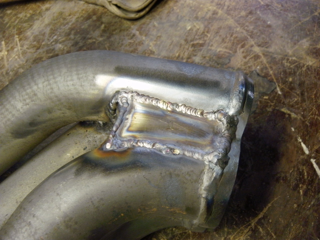

    I Checked the tubes by turning off the workshop lights and shining a flashlight into the ends, looking for "leaks" of light. I did find one that I had to spot weld from inside the tube. A bit of dremeling the insides and I was ready to add the side patches to seal the last few inches of primary tube.

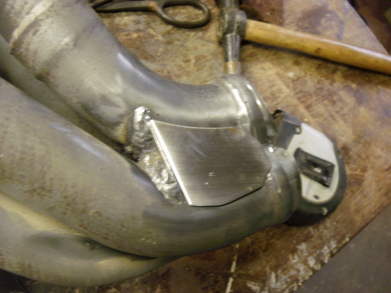

    Again, not super happy with the welds but they are solid at least. Patches were made with 14ga stainless, 304 I think.

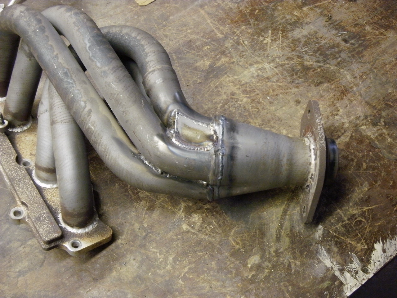

    At last the collector was re attached.
    I know it's a bit Frankenstein lookin' but I hope it will save me $450! I actually miss the little extra power/torque on the highway.
    Now I'm gonna work on packing it up and shipping it out to Jet Hot Coatings. They have 3 options for color coatings. A 1500 degree for $187. A 2000 degree for $200 and the 2500 degree coating for $300. I'm doing the coating mainly for corrosion protection. The 2500 is the toughest coating but I will probably try the 2000 to save a little money. They also charge $50 for stripping, and then whatever return shipping will be.
    The coating's gonna be kinda pricey but if it keeps the header looking good for years to come I think it'll be worth it.

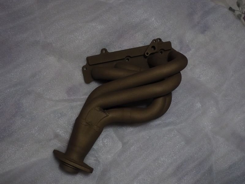

    Woooo! Just arrived today!

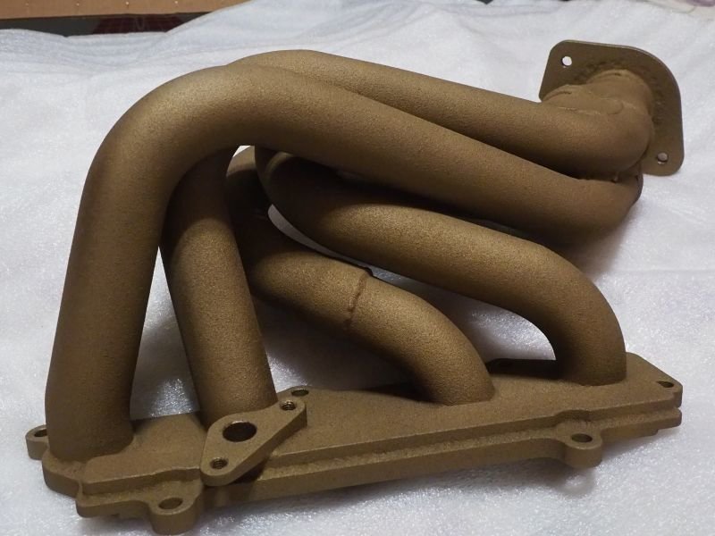

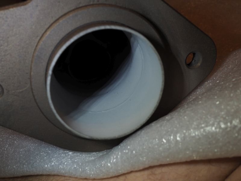

    The header was very well packed and the box is heavy duty. First impression of the coating, it's very rough, like 60 grit sandpaper. They tell you not to scrub or polish it. I went with an antique bronze like color because why not I guess. The color is nicely uniform, there's a bit of overspray on the flange, I'll prob give it a light sanding with a block or something to make sure it's flat. Looks like any threads will need to be chased as well.
    The coating really shows the shittiness of my welding though :oops:. There's a few areas where the weld is cold and kind of rolled over. There's nothing structural here, just for sealing purposes. I've got my fingers crossed...

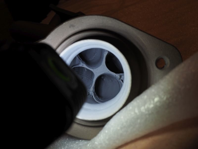

    A view of the inside. It looks like grey primer. Not sure if it's coated or just a blasted finish. Looks like maybe coated. Speaking of blasting, there was residual grit still in the header. Turning it every which way allows it to fall out. I'll probably blow it out as well. Grit is likely bad for the cat and the air injection system.
    So there you have it! I'll post more detailed pics and some of it installed, and some impressions of it's performance. Jet Hot has a great warranty. If the coating performs like they say, it should give great corrosion protection for many years. I'm really hoping it was all worth it.
