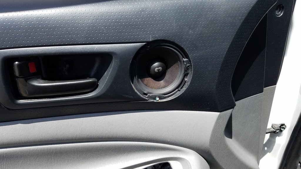

    For the first time I competed in Amateur SQ at the Texas Heat Wave this past weekend and took 1st in my class which is pretty cool! But the judge gave me some great pointers where my system is lacking.
    ^Note: The speakers fit fine in there now, I trimmed the mounting points for the stock grill so its a nice smooth opening now.

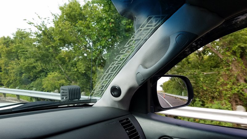

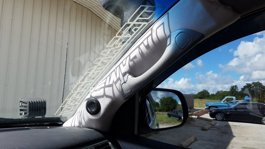

    nice, got any build pics of the pillar tweets?
    i've got mine in the sail panels but would like to see options. did it raise the sound stage any? mine sits just above the dash. [no DSP/time alignment yet]

    Yeah it really brought everything up. I may redo them once I get the new tweets in.

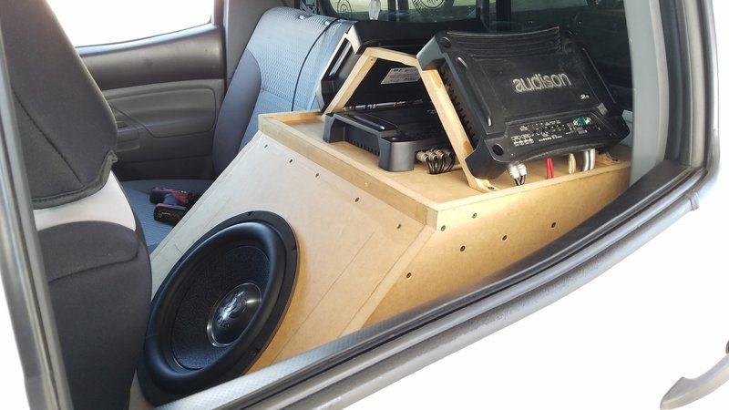

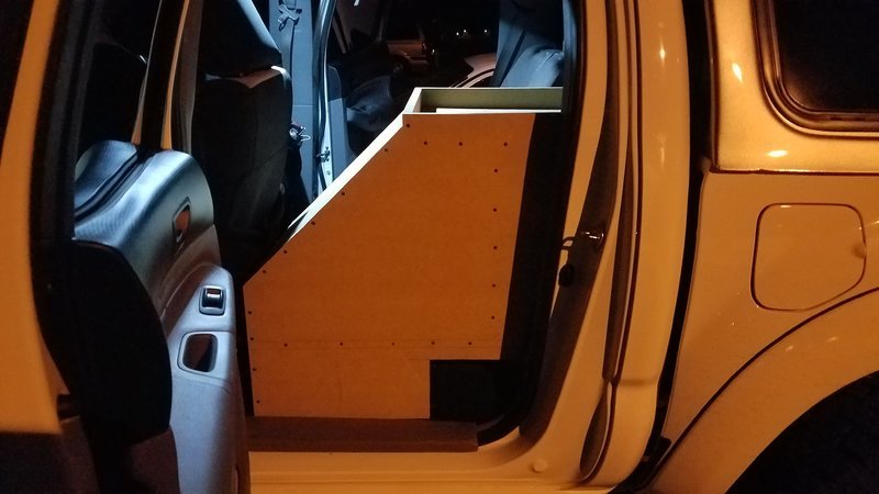

    Some progress from today and last night.
    Last night got the Daytons installed and the pieces for the box cut out and got a good start on the box.
    Today got the scans installed and the box in. Also got my order of wire from KnuKonceptz in as well.
    Tomorrow gonna get the amps mounted and wired, sub hole cut out, and possibly a beauty panel for the sub face.
    Here's some pics. Didn't get many of the box build.

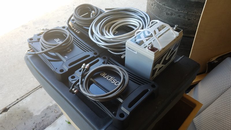

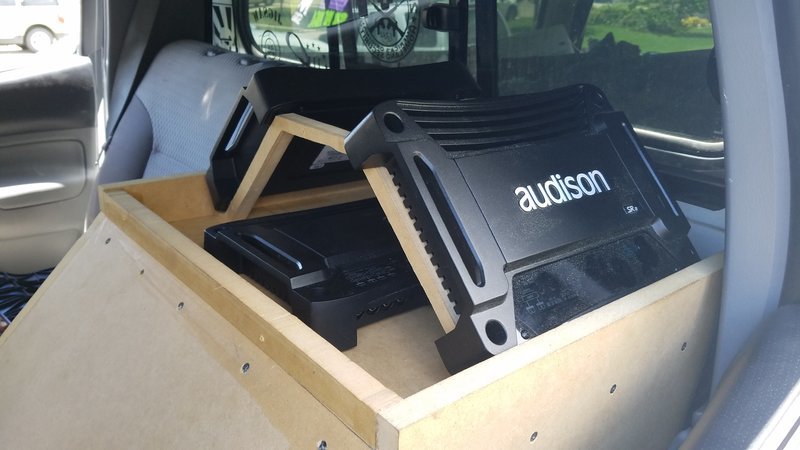

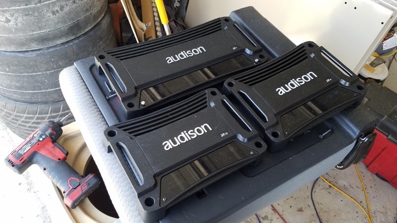

    Got the amps mocked up

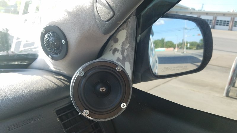

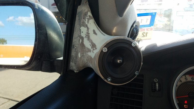

    Well moved the 3's and that made a big difference. Gonna end up doing the same with the tweeters soon too.

    are you mirroring the angles or making sure you get the same offset from the drivers seat?

    Props for going big. Any reason why you didn't build a pod off the pillar instead of the sail panel? Didn't want to deal with obstruction from the gauge cluster?

    Trying to keep them on axis towards the driver.
    Didn't wanna lose the grab handles
