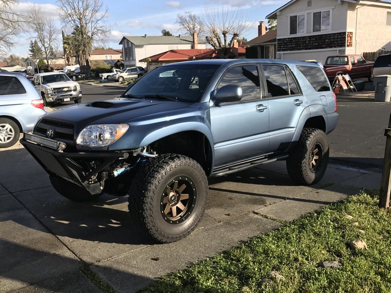

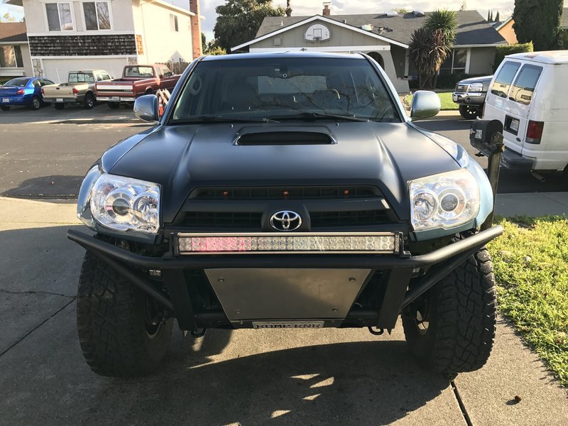

    Replaced my Methods with SCS SR8s. Really happy with how it turned out. I also wrapped my sport hood in a satin black vinyl wrap and removed my roof rack and plugged the holes so I don't fill up the interior.

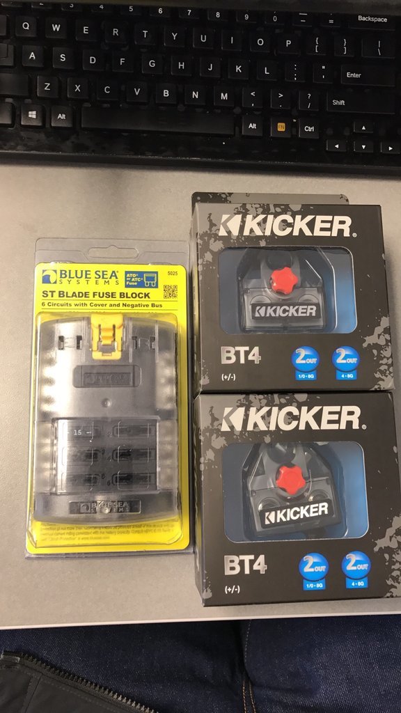

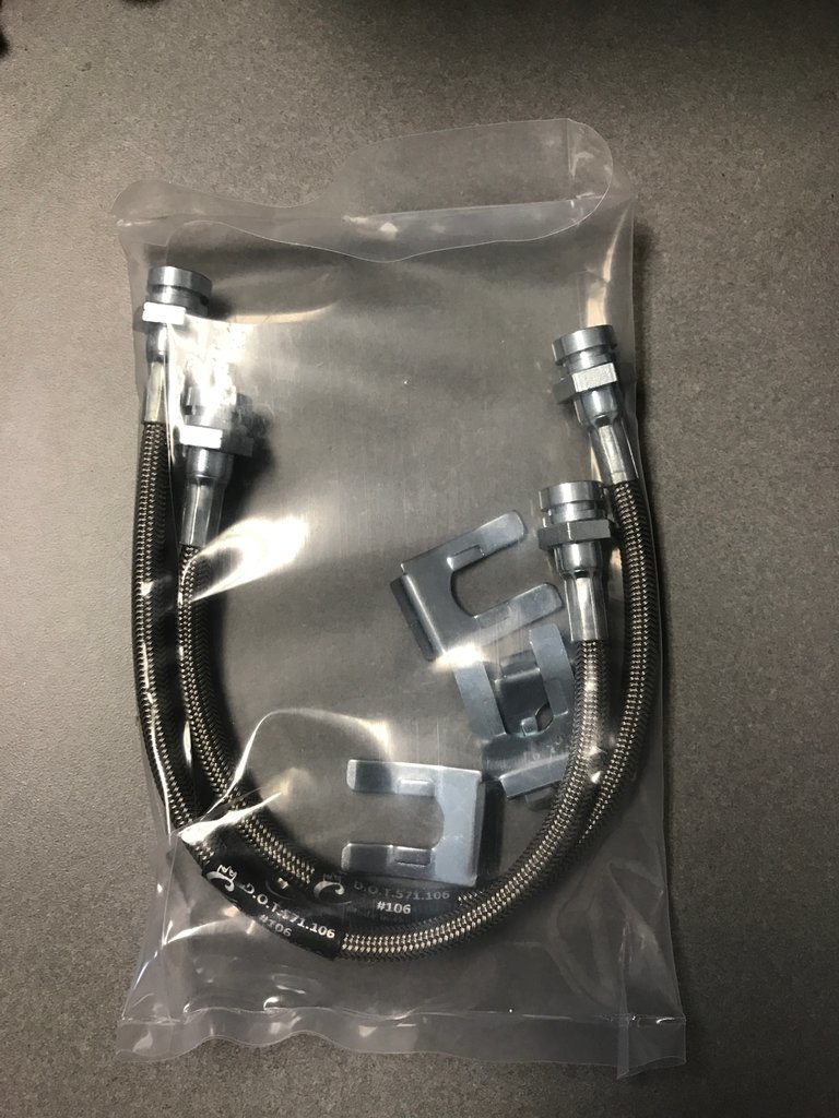

  14. Mar 10, 2017 at 8:04 AM
    #34
    LTDSC
    LTDSC [OP] 32oz of fun
    Apr 7, 2013
    #101544
    13,385
    Sam
    NorCal

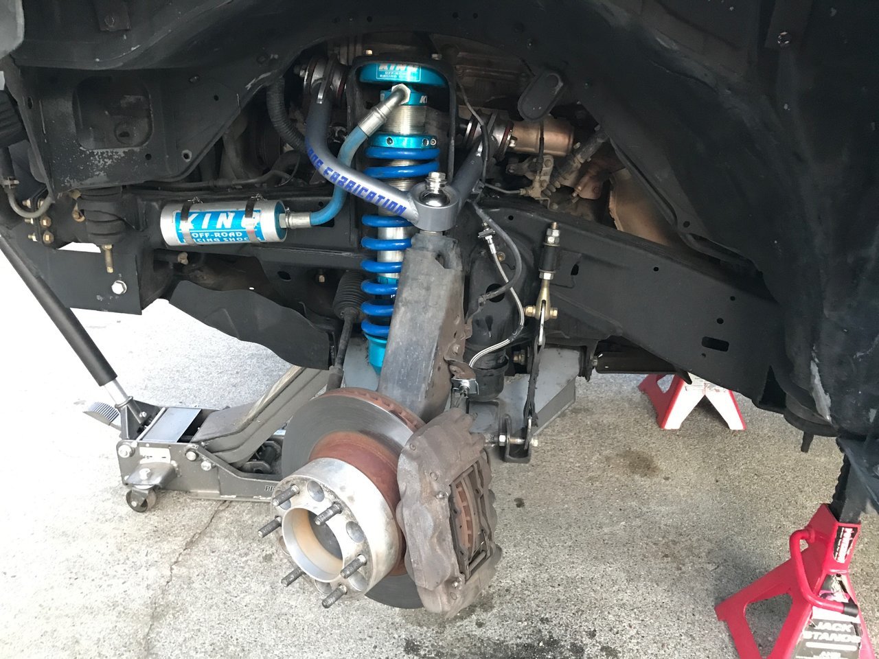

    Bought two battery terminal posts in an attempt to clean up my wiring and add more available locations for my accessories I have coming soon.
    Also got these for the front. Matches the rears. Crown Performance Brake lines.

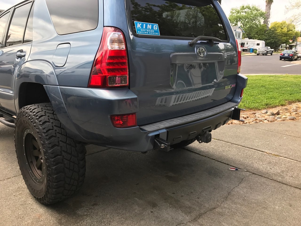

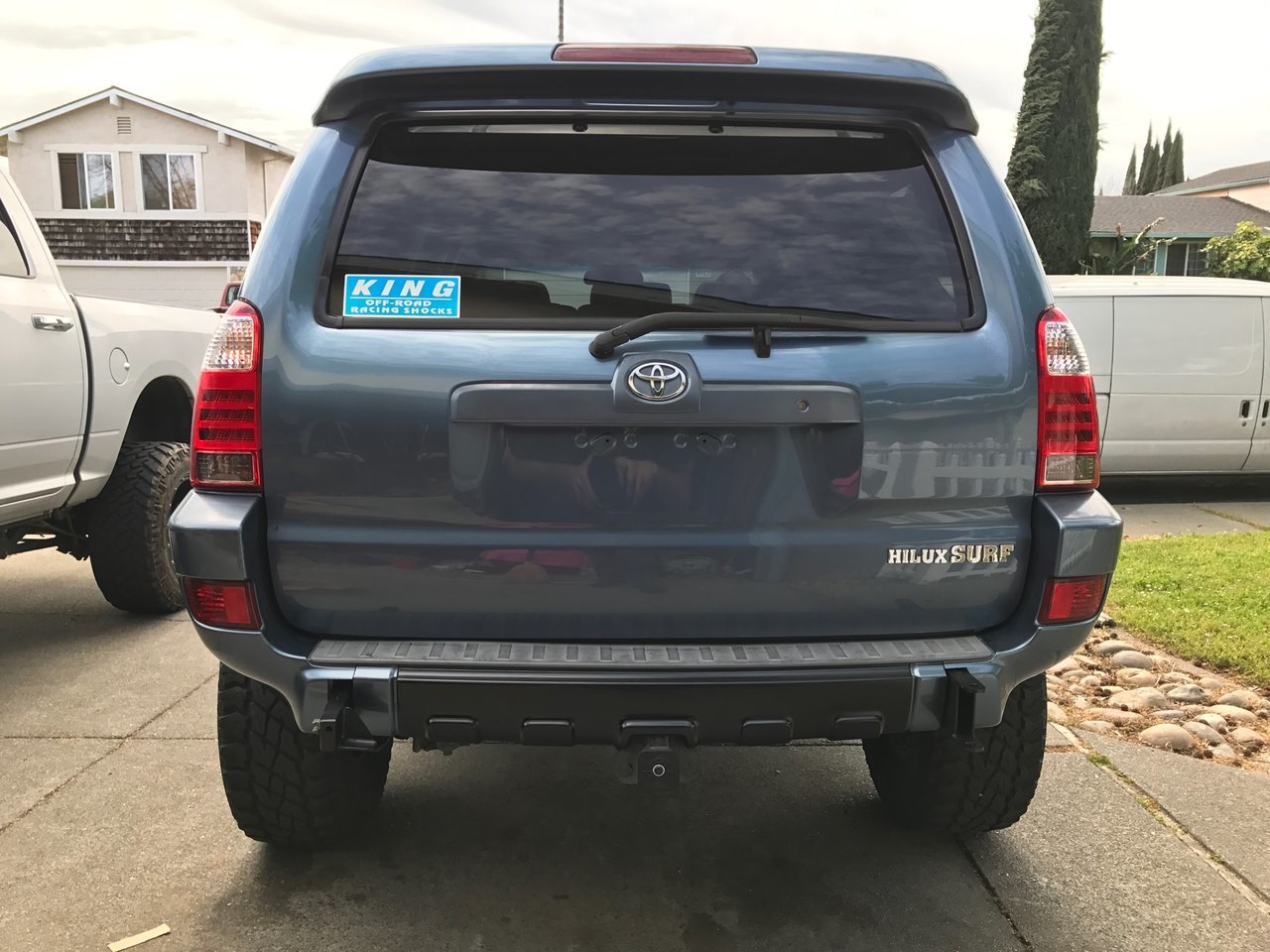

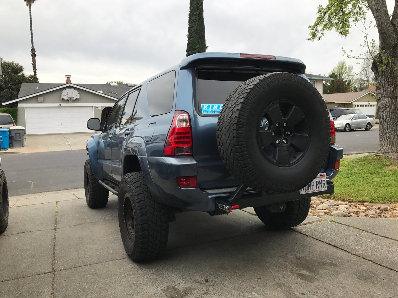

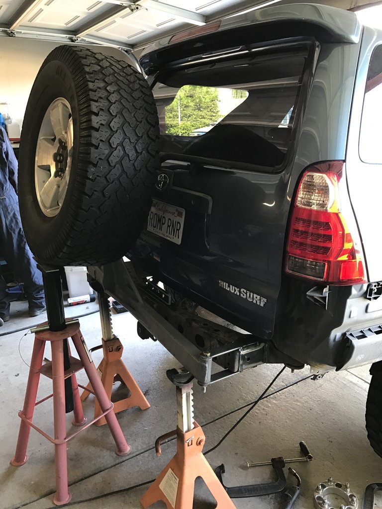

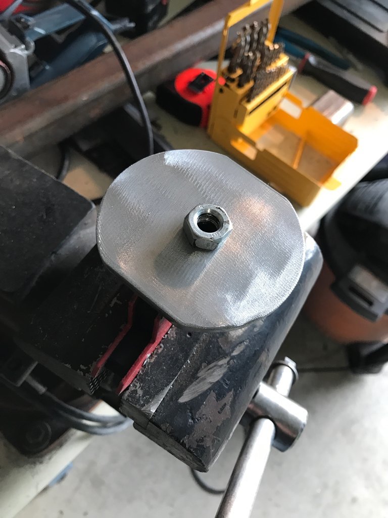

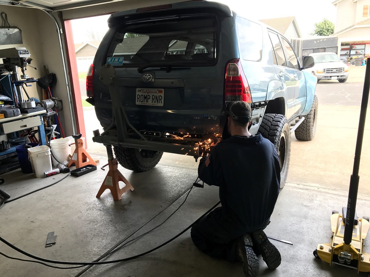

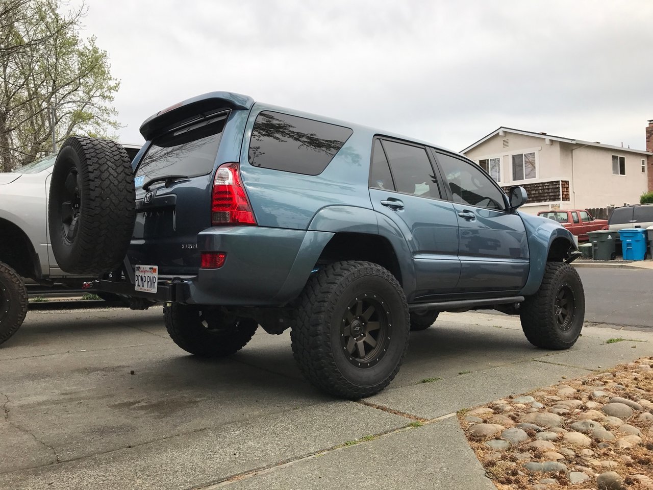

  15. Mar 19, 2017 at 5:11 PM
    #35
    LTDSC
    Apr 7, 2013
    #101544
    13,385
    Sam
    NorCal

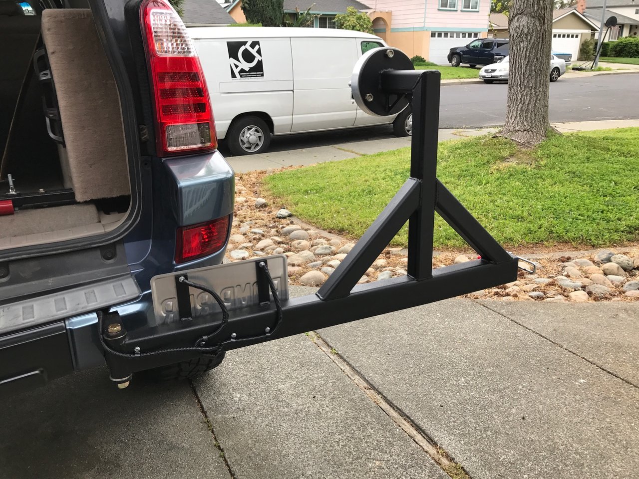

    Was a busy weekend for me.
    Installed my front brake lines
    Then I fabricated some bump pads for my superbumps for the rear.
    I also started on my rear tire gate.
  16. Mar 19, 2017 at 6:00 PM
    #36
    4Running Daily
    4Running Daily Long Live ZS
    Mar 25, 2012
    #75625
    8,702
    Connor
    Tempe/San Diego
    1996 Toyota 4Runner
    Oh I'm a fan of that

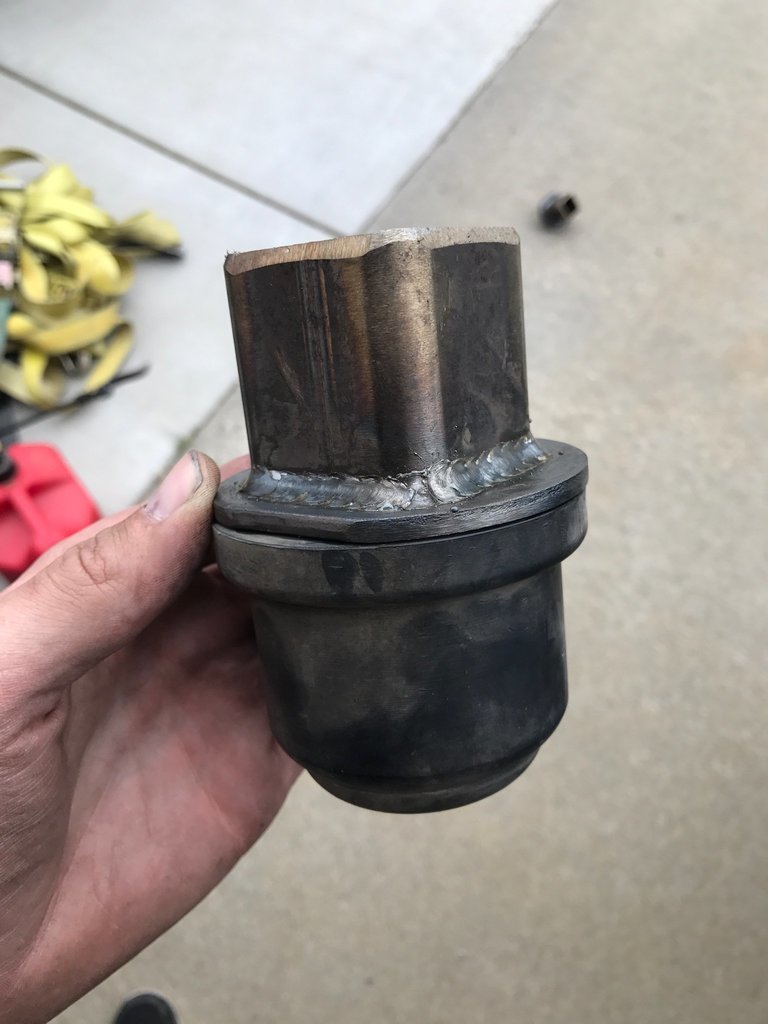

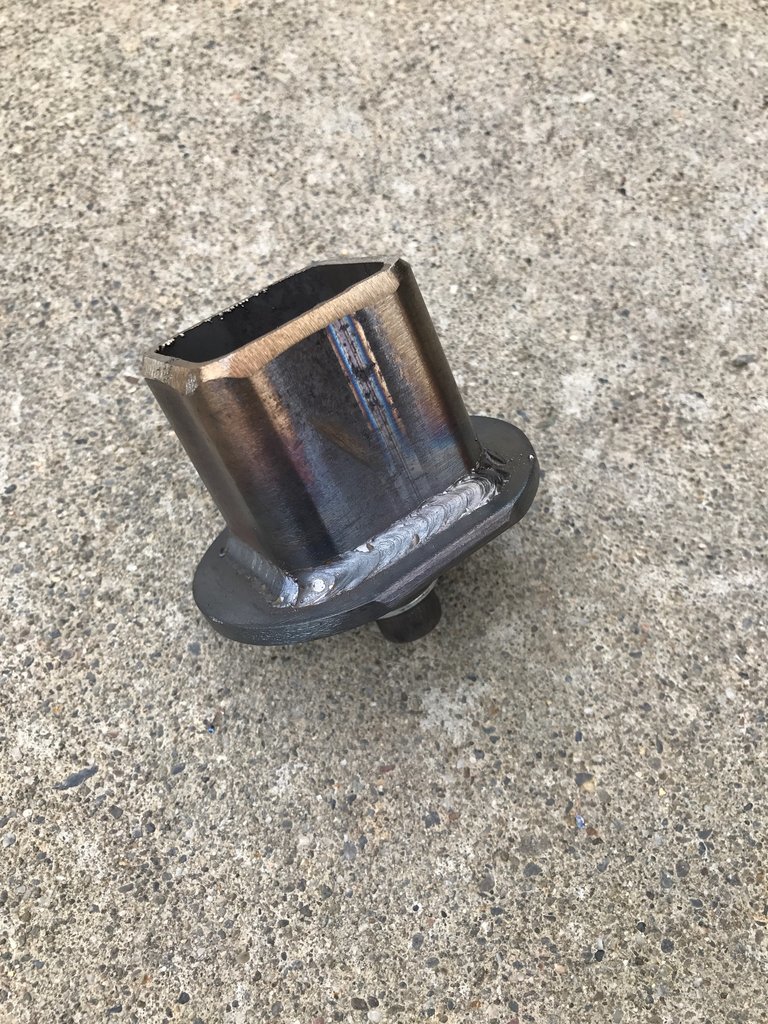

  17. Mar 19, 2017 at 8:42 PM
    #37
    Wishbone Runner
    Wishbone Runner Because 4R
    Sep 9, 2012
    #86546
    6,345
    James
    CO
    04 SR5 4Runner
    King/Dirt King
    Cool design, how's the stability/flex on the arm? Are there bushings, or a bolt through a hole?
  18. Mar 19, 2017 at 8:44 PM
    #38
    LTDSC
    Apr 7, 2013
    #101544
    13,385
    Sam
    NorCal
    We welded the hinge plates to not sag. We have them slightly staggered on the frame so it won't allow any weight droop. We also boxed it on both ends and the latch side it has a tray to sit in when locked.
    In the "spindle" there is a sleeve in the center with two ball bearings at the ends inset and pinched with washers at both ends.
  19. Mar 20, 2017 at 12:24 PM
    #39
    Wishbone Runner
    Sep 9, 2012
    #86546
    6,345
    James
    CO
    04 SR5 4Runner
    King/Dirt King
    Cool, looks good. Where did you tap for the licence plate, by the tail light or the tow plug?
  20. Mar 20, 2017 at 1:17 PM
    #40
    LTDSC
    Apr 7, 2013
    #101544
    13,385
    Sam
    NorCal
    i tapped into my trailer wiring. Easiest and already under the vehicle.
