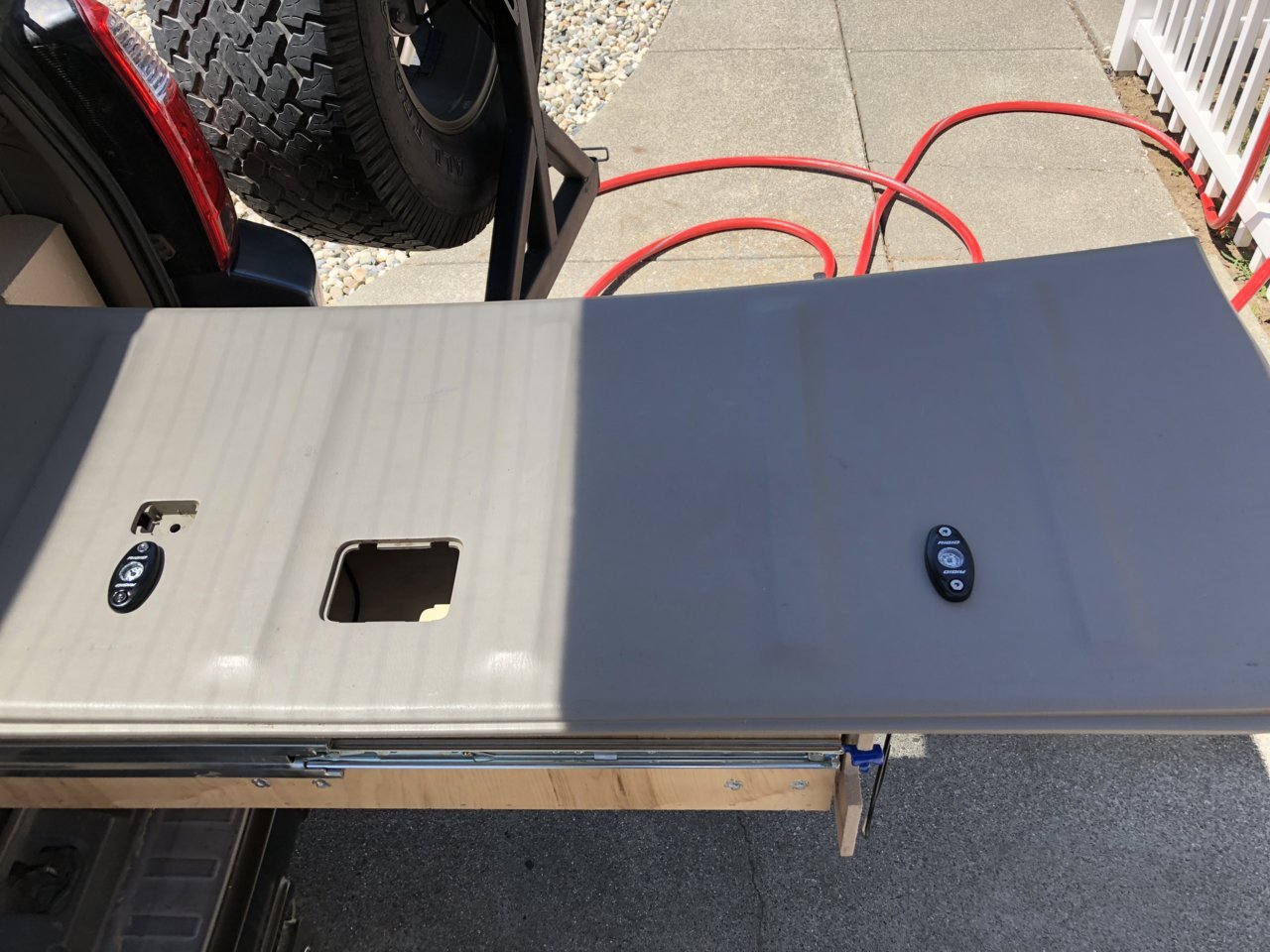

    Received my Rigids for the hatch interior panel. So it will illuminate over the cooking area as well as the drawer when needed. Going to place the switch on the rear pillar for easy access.
    Hoping that cures the darkness in the back at night. The cargo LED panel works great for the cargo area but does nothing outside of it. Cooking in Pismo was a guessing game. I am going to try to wire it this weekend, will report with hopefully finished pics.

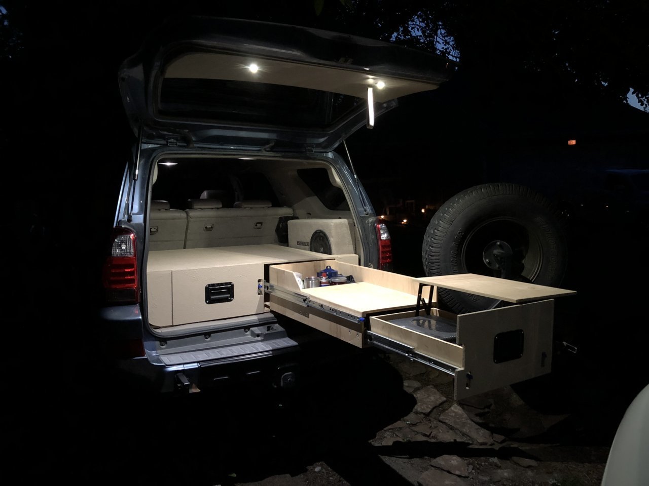

    Wired up the rigids yesterday. Popped open the tailgate interior panel and lined up the light locations and got to work.
    Wired them together then wired down the tailgate interior away from the rear window tracks and through the grommet and OEM wire cover in to the headliner. Once in the vehicle I ran it from the headliner over to the rear pillar where I mounted a flush mount switch.
    RE-installed everything and waited for night so I could test them out. These were far brighter than I expected overall and easily light my drawers and cooking area like I wanted. I can’t wait to use these out camping now.
