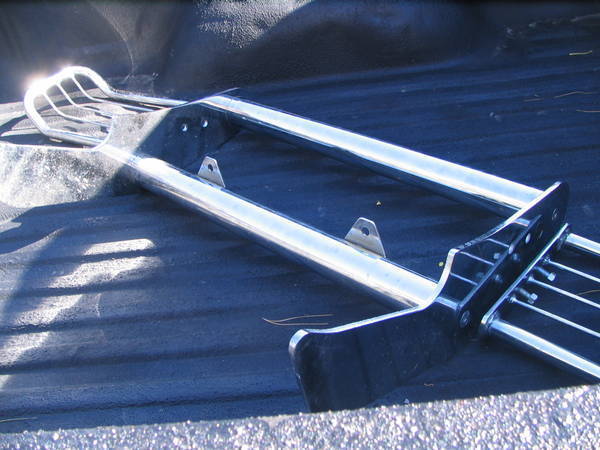

    I also picked this up for cheap off craigslist last week.
    I'm going to try to build some mounting brackets for it. It is the right width, but some dork cut the mounting tabs it originally had off. I think it was originally for an f150, but has been cut down horizontally too. Might have been for a smaller vehicle though. It's a go industries knock down grill guard. Before you ask, yes I'm going to be painting it with bed liner.
    http://www.autoanything.com/grille-guards/61A2353A0A0A2587399.aspx

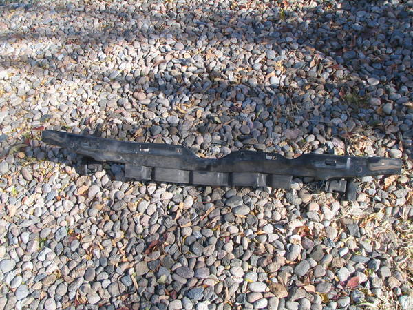

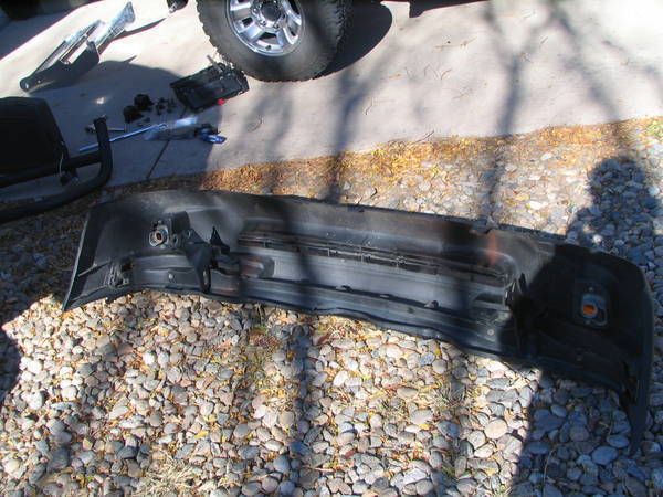

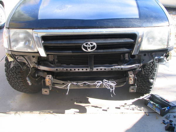

    Pulled my bumper off today and bent the brackets for it back into place.
    I also took some measurements for the brackets I need to make for the brush guard. I'm planning on using some box steel with a 2x3 internal dimension, if I can find some, for the brackets. That should fit over the frame nicely. Then I can pie cut and bend it up to meet the bottom section of the of the brush guard. A couple of bolts through the frame and a couple more through the guard. Looks like it will be easier then I thought at first. I'll be notching the plastic of the bumper to accommodate the brackets. I may need some of those metal tubes for the bolt holes so I don't dimple the frame/bracket.

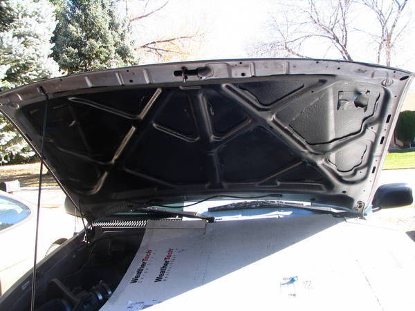

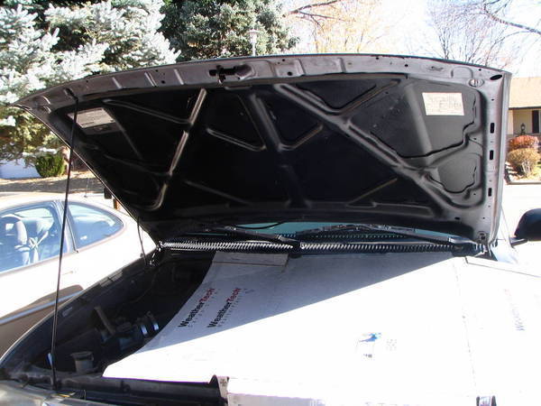

    I also sprayed DEI boomat on the underside of my hood. I don't like a lot of engine noise. I'd seen posts a couple other places about people doing this, and thought it was worth a shot. Frankly, I expect the boom mat to react badly to the heat in the engine bay. It's almost a spray on tar.
    Taped off the stickers under the hood, so I can read them if I need to.
    Tape removed.

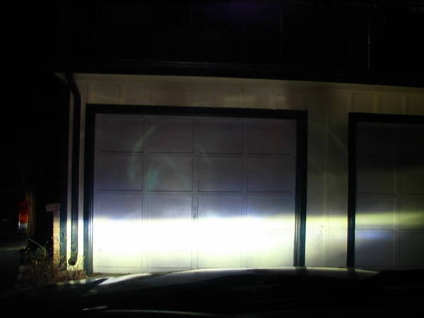

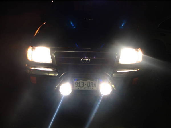

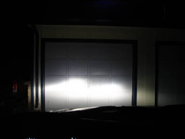

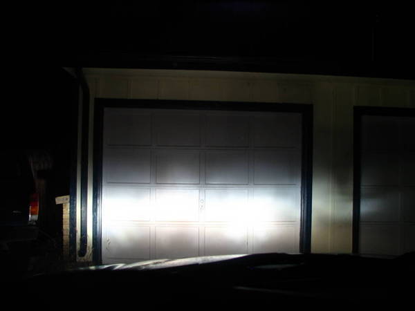

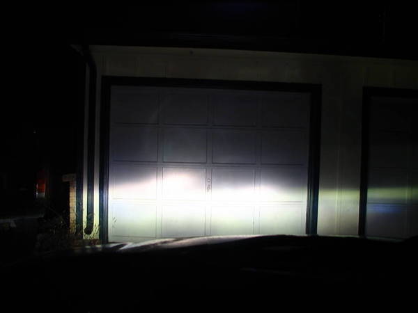

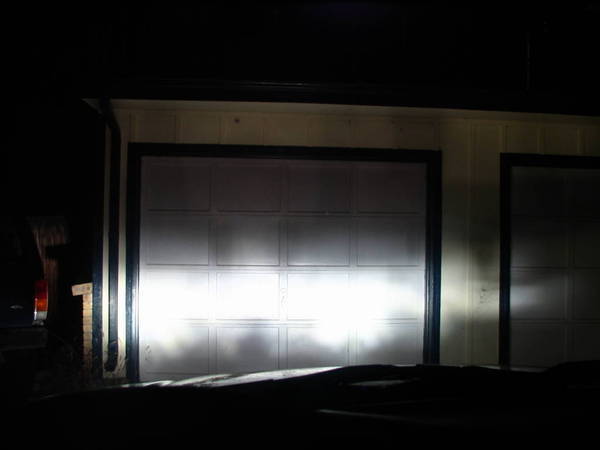

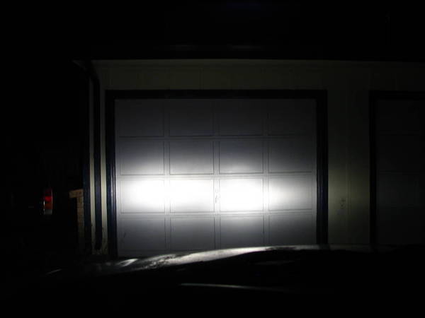

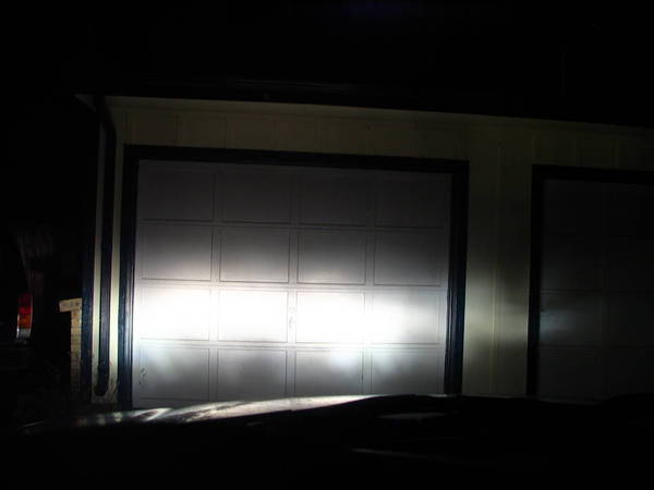

    Just installed and tested my piaa 525's. I have the covers on in all these shots. I have already cut the PIAA off the covers.
    For reference, headlights low beams.
    Headlights high beams.
    Fogs only.
    Fogs with low beam headlights.
    Fogs with high beam headlights.
    Piaa high beams only.
    Piaa high beams, headlight low beams.
    Piaa high beams, headlight high beams.
    What it looks like from the front.
    After taking these pictures I cleaned up the wiring a bit. I guess I didn't have one of the lines for the relays spliced in very well. Now when I turn on the highs the lights go off completely. :) I'll pull the the connections out at some point and fix that. It isn't that big of a deal to me though, I bought these primarily for fog/snow.
