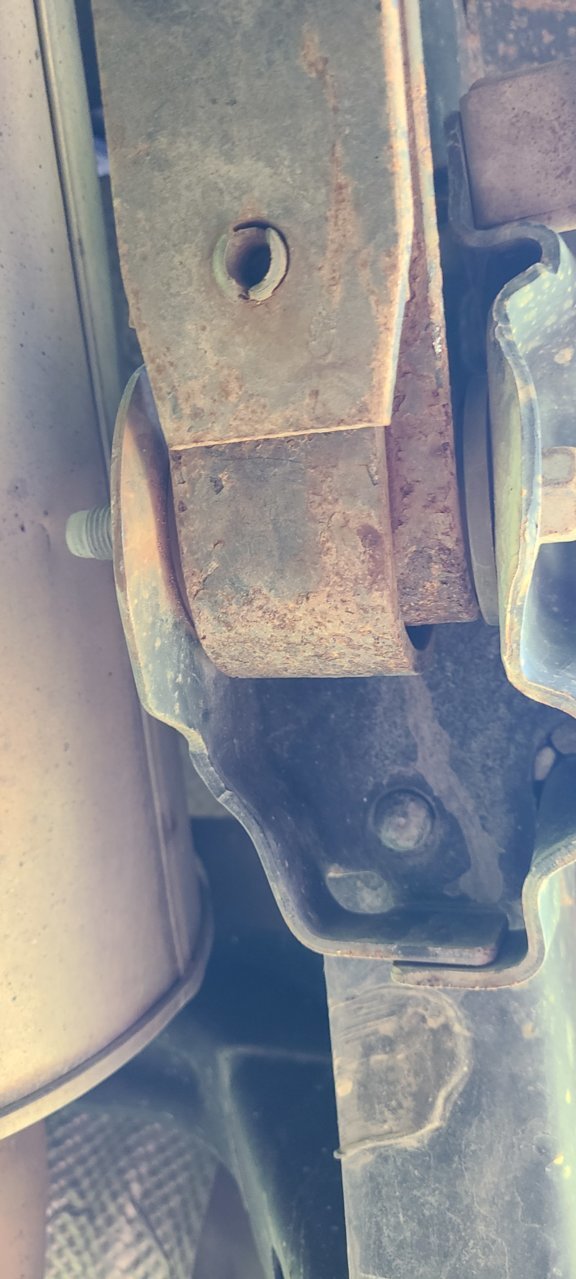

    An update as of today: Everything is tight to specs. I stopped by the trusted offroad place (really small shop) and they immediately had suggestions after being under the truck for 30 seconds. My outer leaf is sliding side to side, he said to take it home and do the power wash method mentioned above here. If that does not work it is a problem from the manufacturer. Onto that... these are all pro leafs and a quick search on this site comes up with tons of the same issue... If the greasing and lubing does not help I might be in the market for better leafs in the near future.

    Everything is tight I am told. Here's a pic of the leaf that has shifted. Seems to be popular with all pro from all my research.
